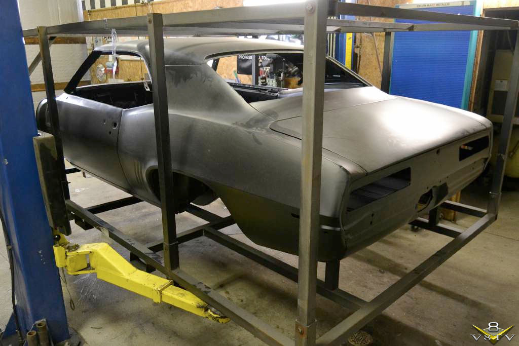

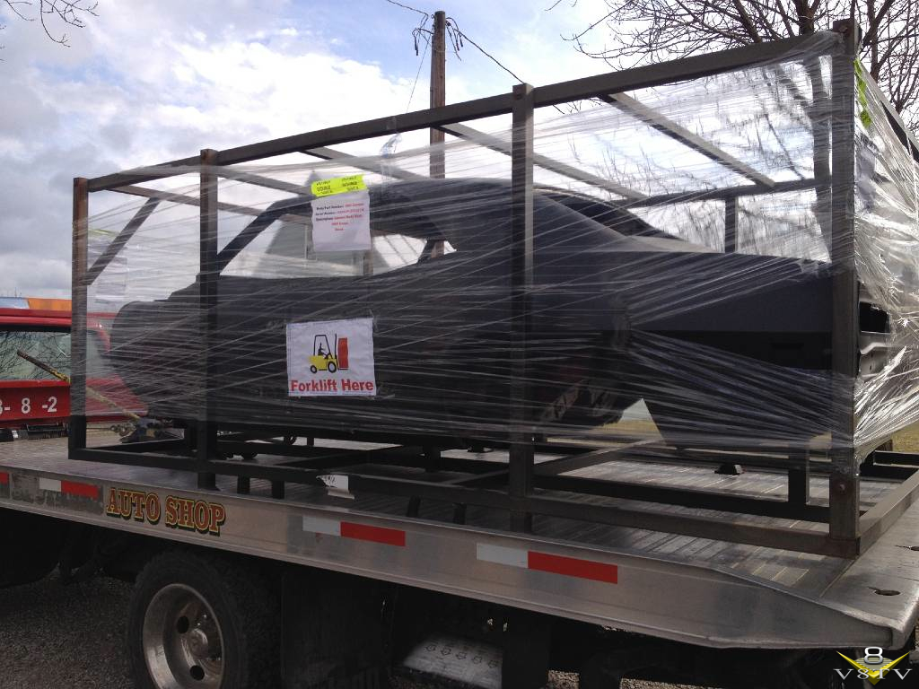

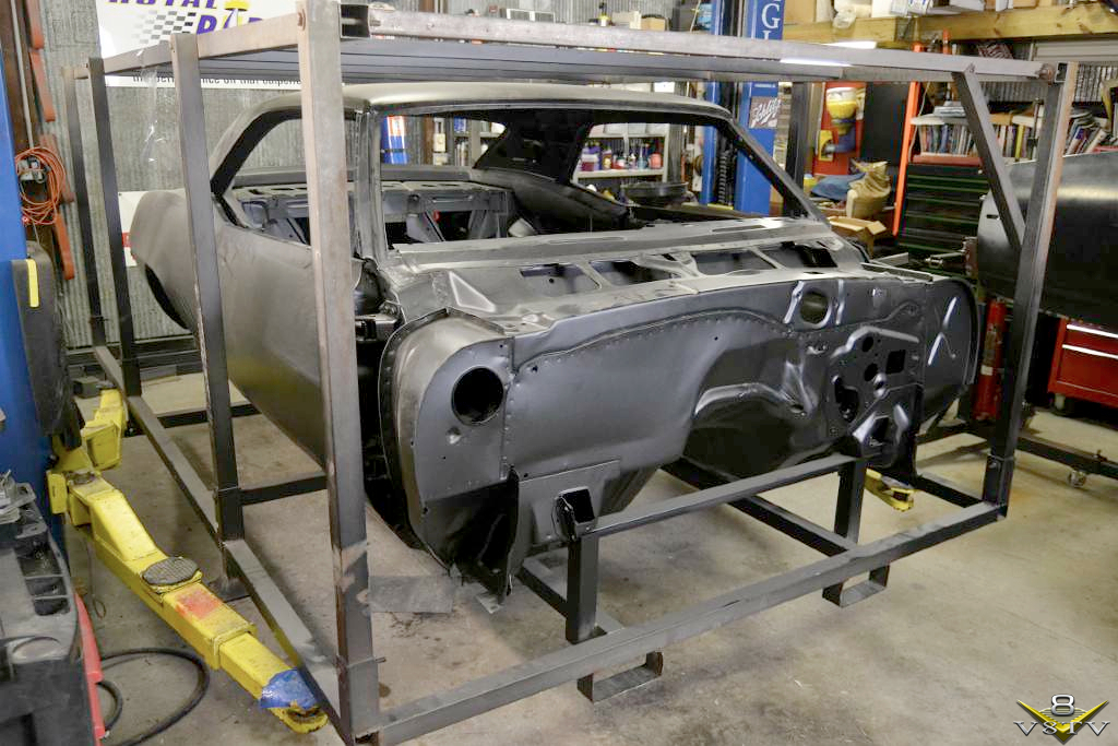

This is how the Dynacorn body arrives:

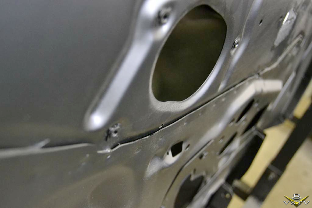

Looks pretty good at first glance. We'll get into the panel fitment later, but we noticed some of the resistance spot-welds were off a little, but even GM was guilty of that. Be prepared to address this kind of thing if you work on one of these.

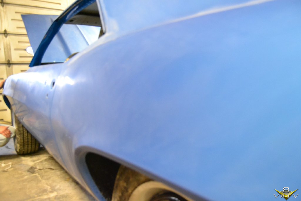

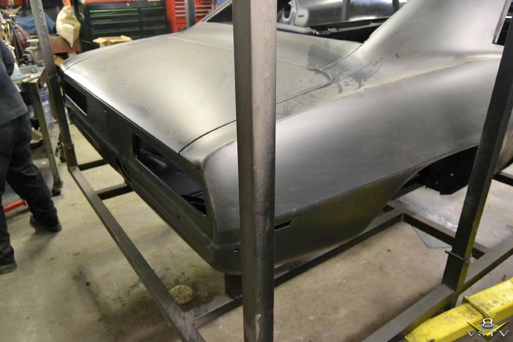

The deck lid, doors, and quarters all seem to fit much better on this one than they did when these reproduction bodies first hit the market. They appear to have a factory style fit, but we'll be tuning that up on ours.

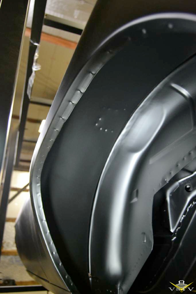

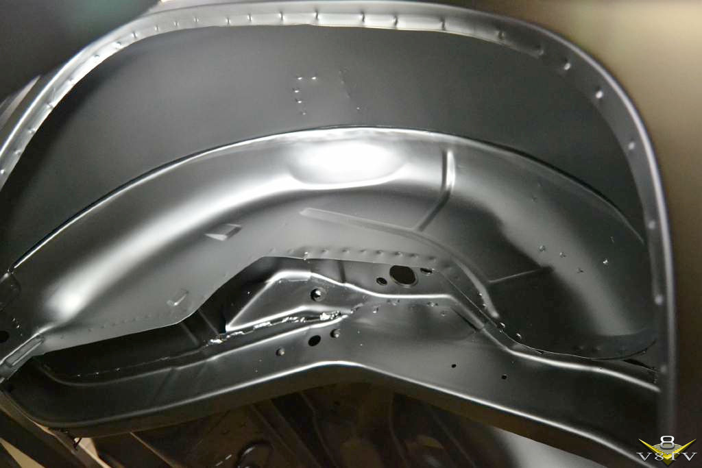

The wheel tubs appear stock, but the wheel lips are in need of some attention regarding the placement and tidiness of the spotwelds.
The rear frame rails and floors all look correct.

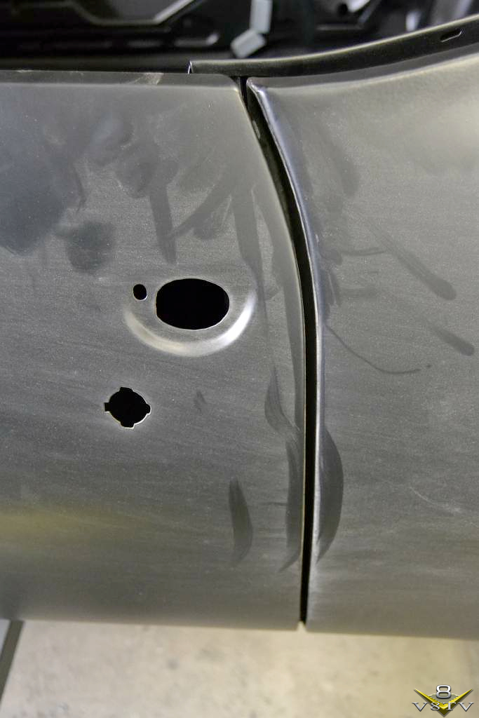

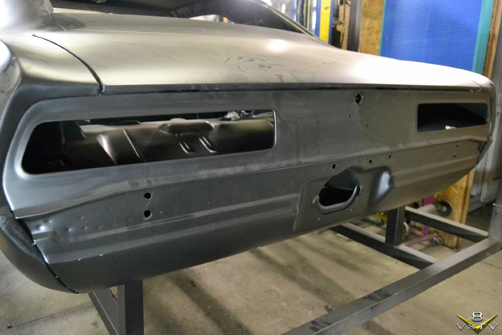

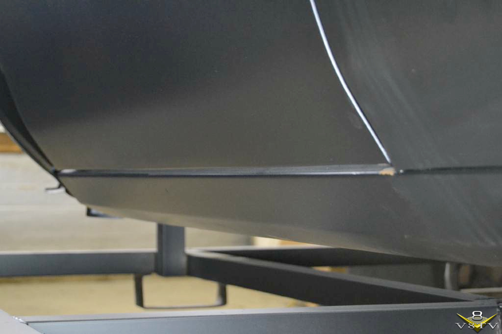

We noticed a nice, straight lower door to rocker fitment.

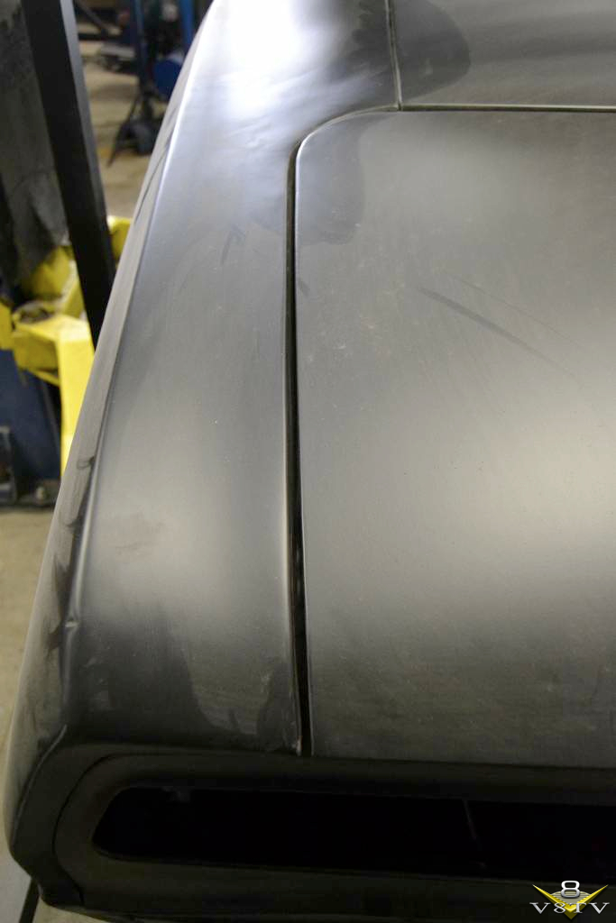

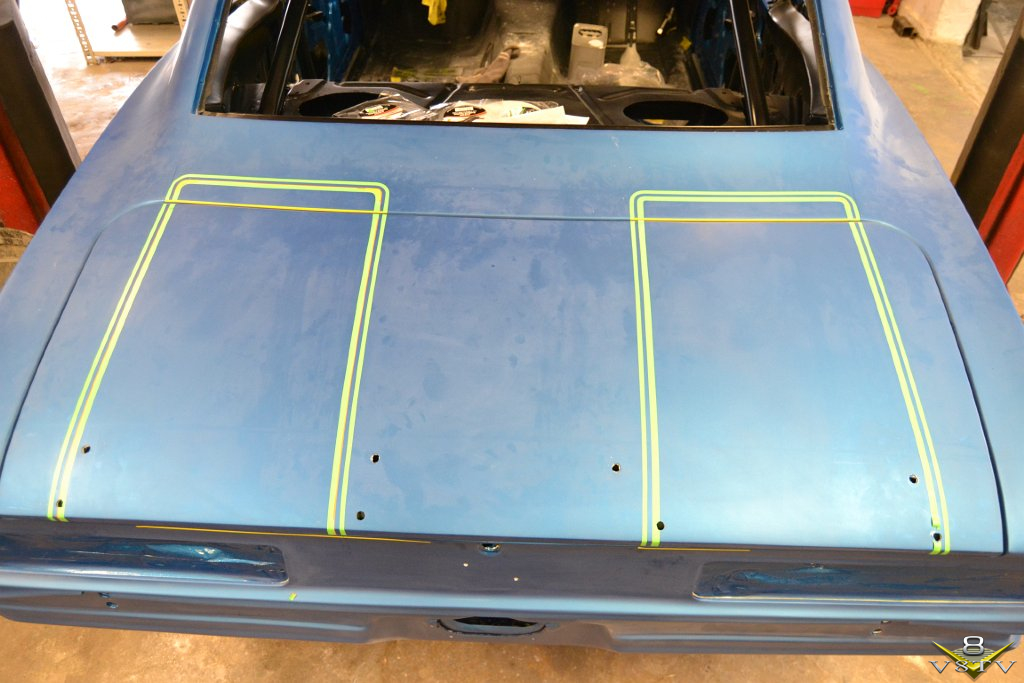

The deck lid gap appears a little inconstant, but not completely off base.

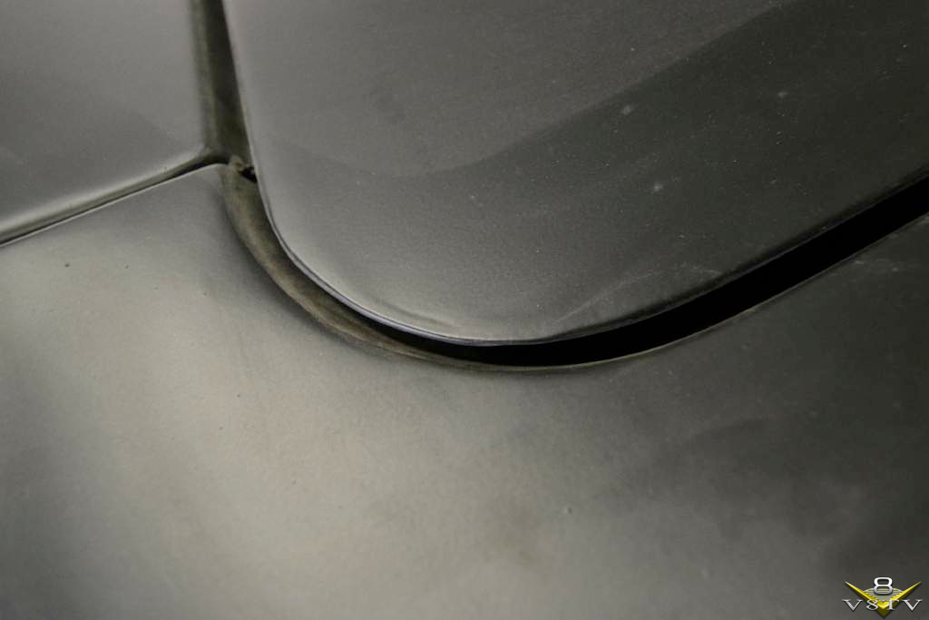

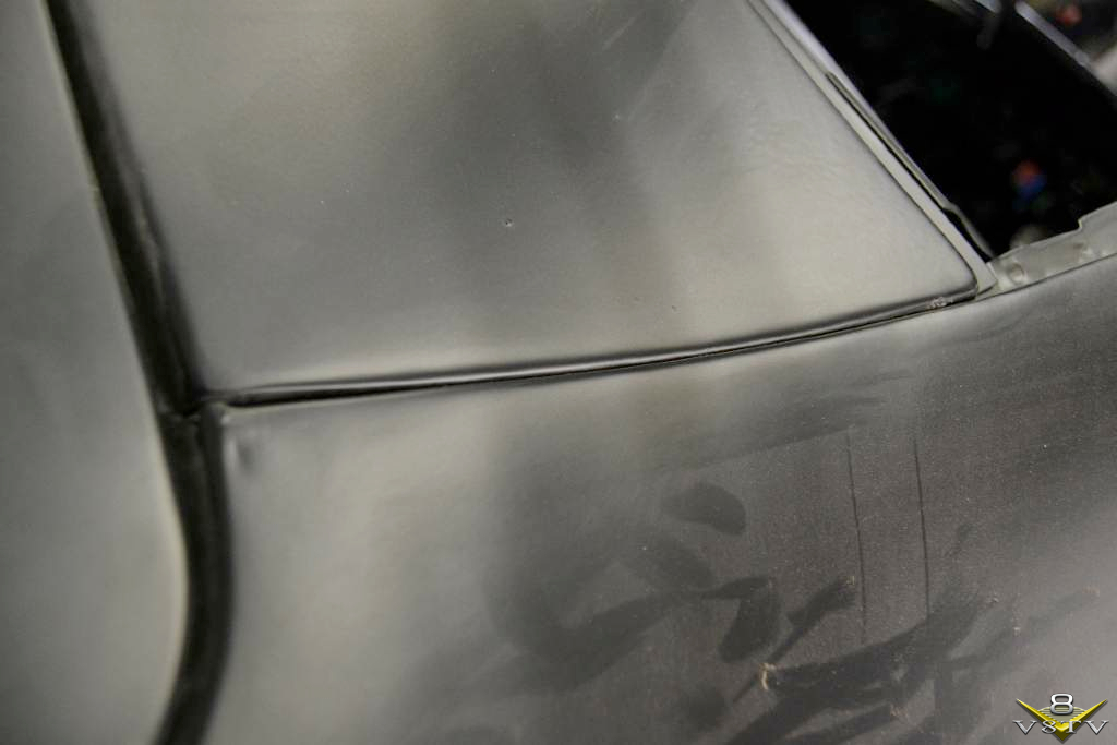

Deck to quarter gap is a little wobbly, and the quarter panel came with a dent in the contour line.
The rear window filler panel fit is OK, we'll weld this up to prevent it shifting in the future.
The tail pan looks like many of the reproduction pieces, but the lines are a little more defined than many. The tail light openings can be hit or miss on the repro panels, but these look better than most.

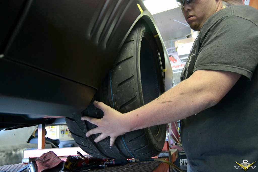

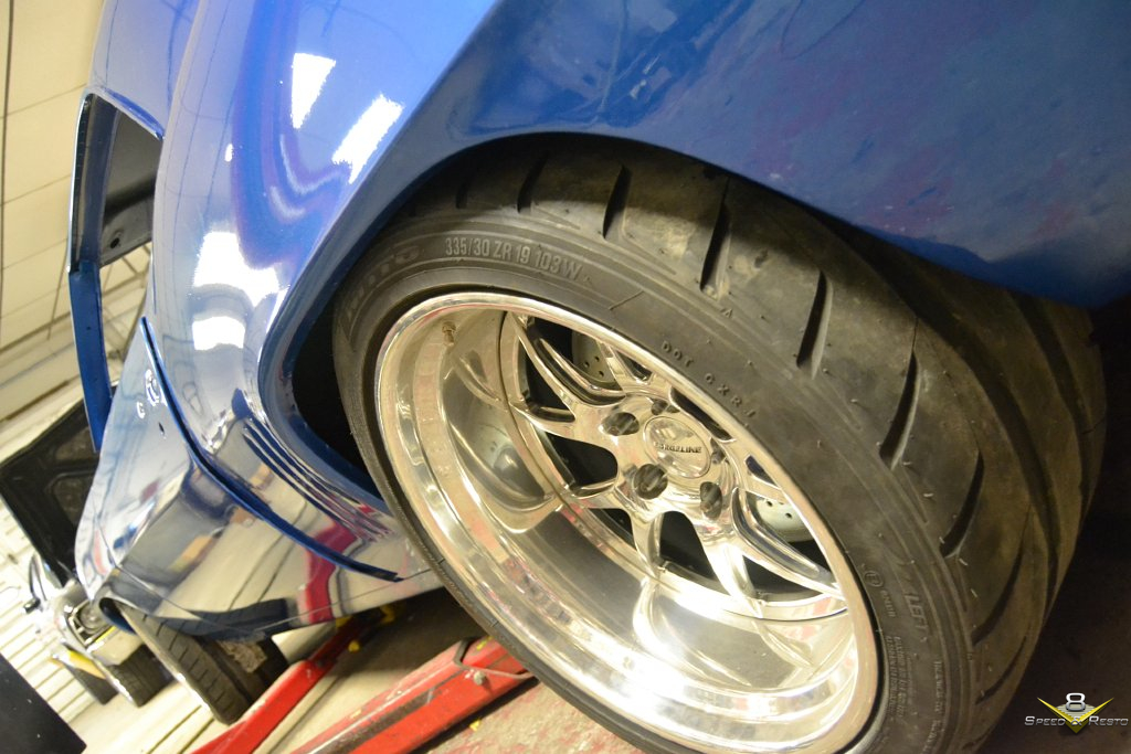

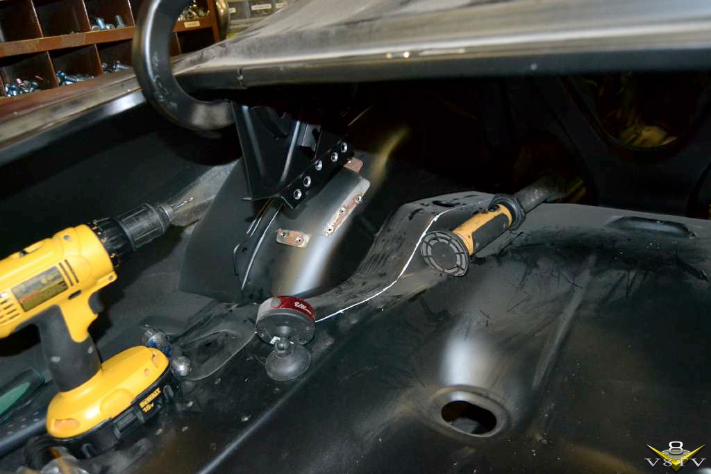

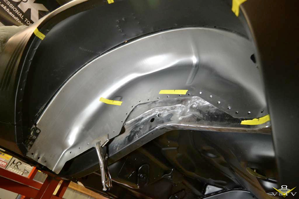

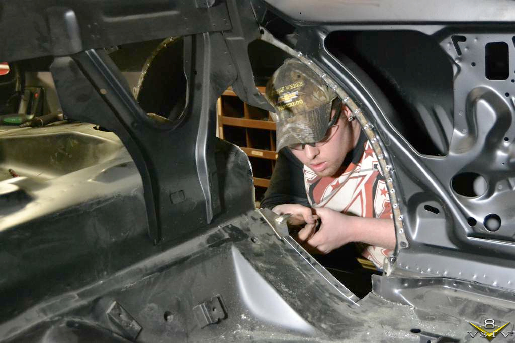

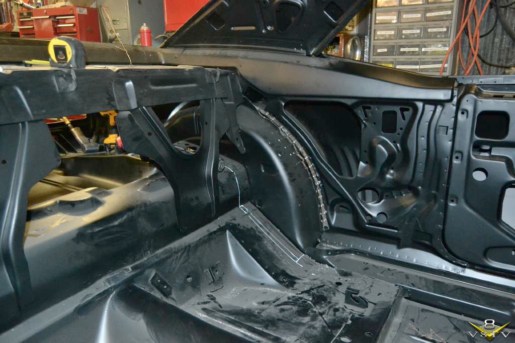

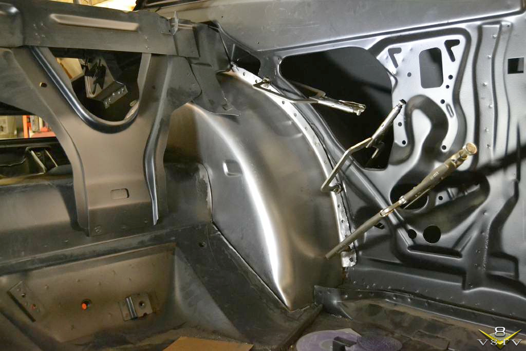

Our plans for this car call for "spirited" driving courtesy of the 800+ horsepower Mast engine, so we'll need to run much larger tires than the stock Camaro wheel tubs can hold. The solution is the install of some Detroit Speed deep tubs. First, Eric cuts out the stock rear trunk hinge support by drilling out the stock spot welds.
Next, the wheel tub spot welds are drilled. Note the line on the floor, this is where the floor will be cut and folded to accommodate the deep tubs.
Behind the wheel tub, the white line is cut in the trunk floor to house the deep tub.

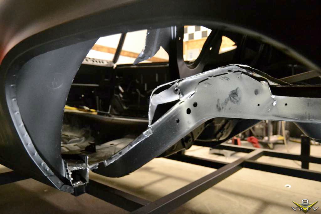

The frame rail before modifications.
Kevin Oeste
V8 Speed and Resto Shop
V8TV
Muscle Car Of The Week
V8 Radio Podcast
All about us:
https://www.v8speedshop.com
Old 12-01-2015, 06:48 PM
V8TV's Avatar
V8TV V8TV is offline
Join Date: Nov 2005
Posts: 1,891
Thanks: 8
Thanked 32 Times in 21 Posts

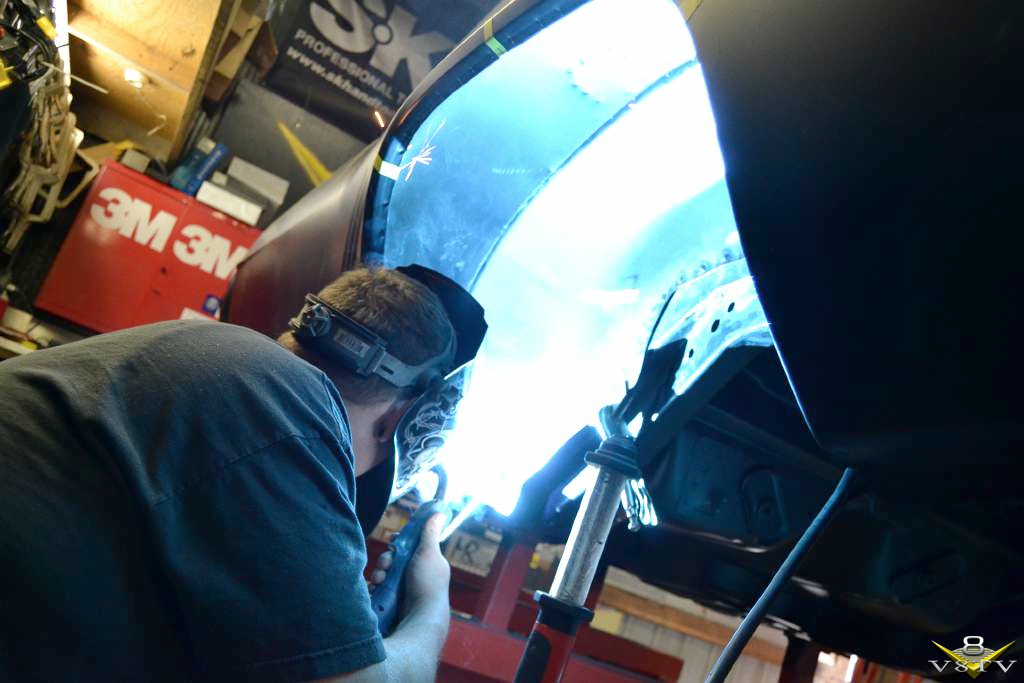

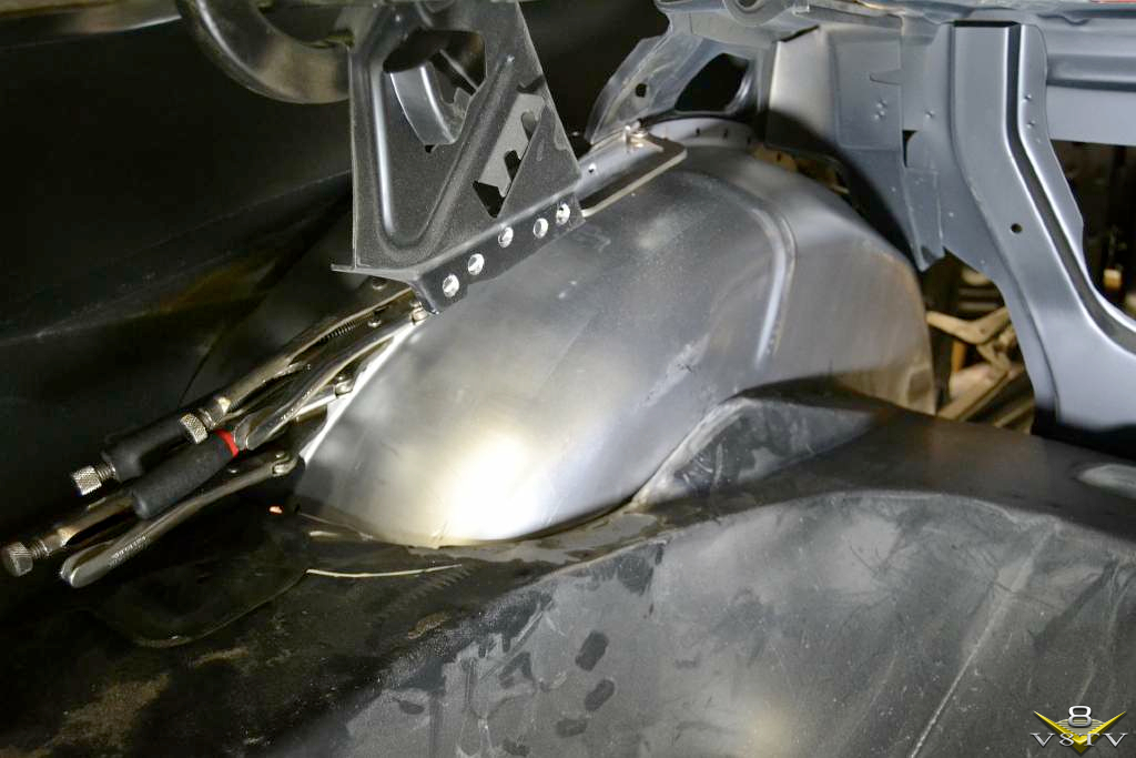

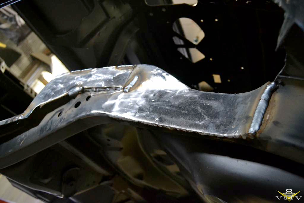

The frame rail is notched and narrowed, and a heavy plate is formed and welded in place to add increased strength.
The new DSE deep tub is clamped into position and fitted to the car.
The lower portion of the tub is punched with holes for plug-welding, and then the whole tub is welded in place.

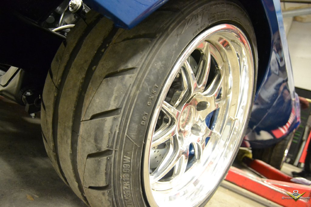

Looks like the wide rubber will squeeze right in!
