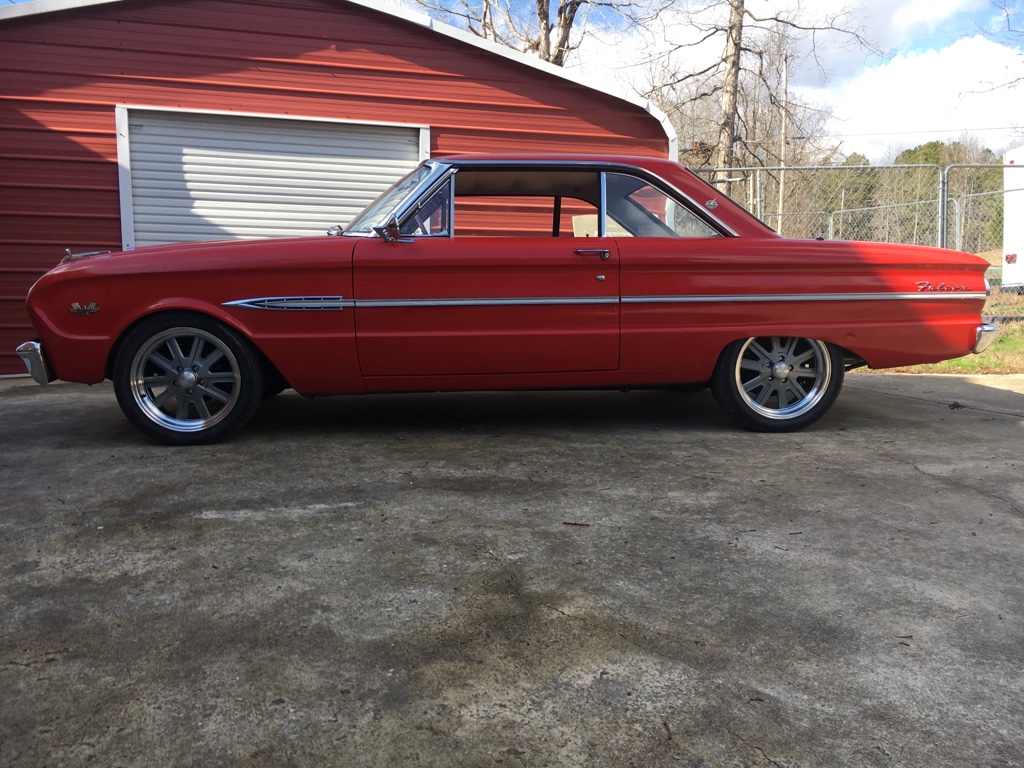

Not the best picture, but I like how it sits!

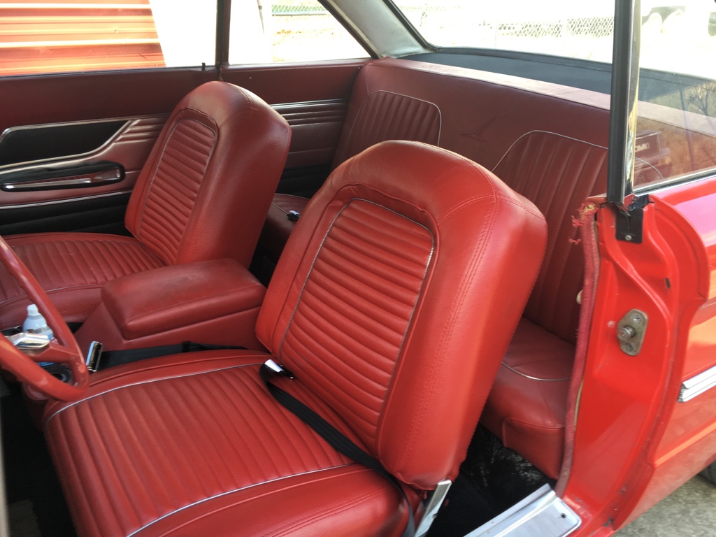

I also got the last few pieces in the interior... I like the black pieces more & more...

I drove the Falcoon up to my friend Sherman's today. Just shy of 70 miles round trip and it was awesome. Frickin’ tires still skkkiiirrrkkkk every once in a while. I hate that sh1t. I'm going to have to do a narrower rearend which means... If I do it, I'm going to go ahead and minitub it too. Then I can run a 9" wheel out back with plenty of room. I'm just gonna stay with the halibrand style wheel for now. The Fikse wheels need radder brakes, suspension and purty paint. That'll be the next iteration.
Need?
Sits nice. Is the rubbing on corners/turn or straight-line compression?
  #99
Old 01-07-2020, 08:01 AM
Nlped47's Avatar
Nlped47 Nlped47 is offline
Join Date: Nov 2016
Posts: 129
Thanked 55 Times in 38 Posts
Originally Posted by ScotI View Post
Need?
Thanks! I like how it sits too.
They don’t “need”, but I’d prefer. The 10” front discs and rear drums hide well behind these wheels but would be very noticeable. My excuse anyway
The passenger side rubs on right hand corners. Turn the panhard bar 1/2 turn the other way and the drivers side rubs. I’ve already ‘finessed’ the inner fenders and lips as much as I feel comfortable doing.
