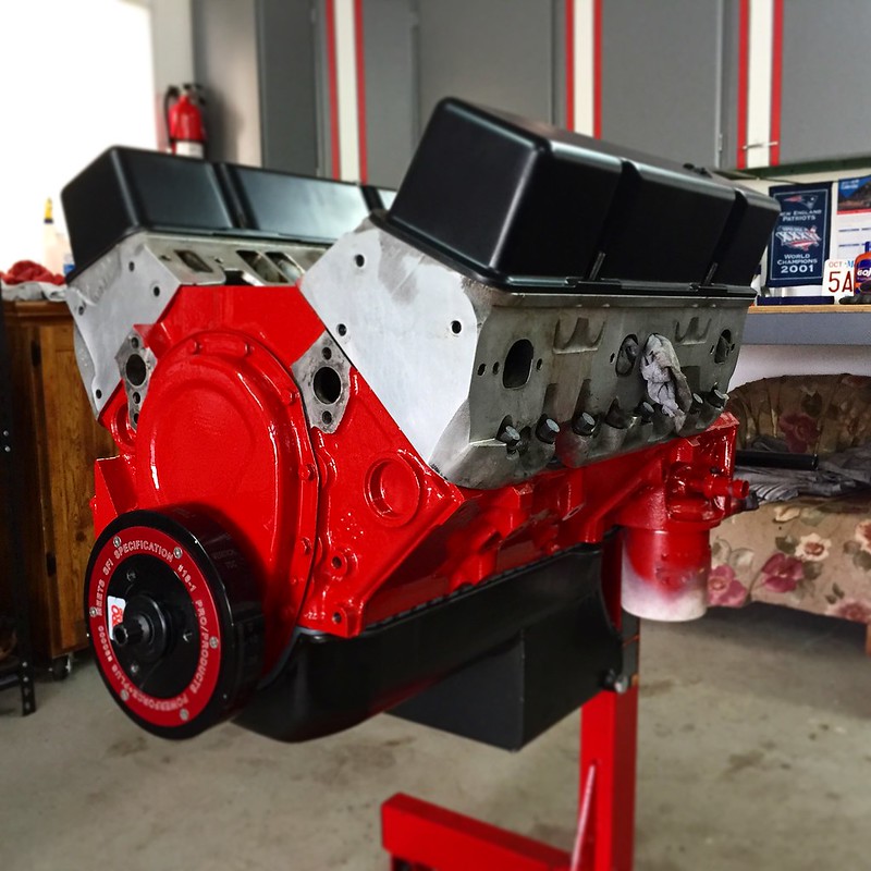

After painting the engine, I removed all of the masking and bolted up the oil pan for the last time, making sure to torque all of the bolts. Next came the harmonic balancer.There are a ton of options out there for balancers, everything from $50 stock replacements to $400 top-of-the-line ones. Again I went back to the books I've been using for reference, and ended up choosing a 6 3/4" SFI-approved balancer from Professional Products. The SFI approval means that it is tested for up to 10k RPM, which is way overkill for my engine but for the small extra price it was worth it to me for the peace of mind. This is a good, middle of the road balancer that fits in my budget and should work just fine for my needs.

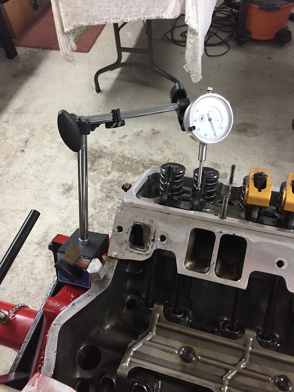

After that was settled, I wanted to measure my cam specs before buttoning up the top end of the motor. I ended up having to take off a rocker and measure the lift off of a pushrod, since having the rockers installed resulted in my lifters collapsing and getting low readings (took me a while to figure that out!)
I measured duration at 0.050" by measuring the diameter of the balancer and converting that into degrees... not perfect but I thought it would at least get me in the ballpark.
Here are the approximate specs I came up with:
Intake: 0.480" lift; 223deg duration at 0.050"
Exhaust: 0.512" lift; 233deg duration at 0.050"
Stock cam specs for a ZZ4:
Intake: 0.474" lift; 208deg duration
Exhaust: 0.510" lift; 221deg duration
Based on how close these are, and knowing that my measurements aren't perfect, I'm assuming I have a stock cam. I also couldn't find any markings on the snout of the cam to give me a clue on who made it.

Valve covers are all painted and I threw them on for a quick mockup... I think I'm going to like the red and satin black look!

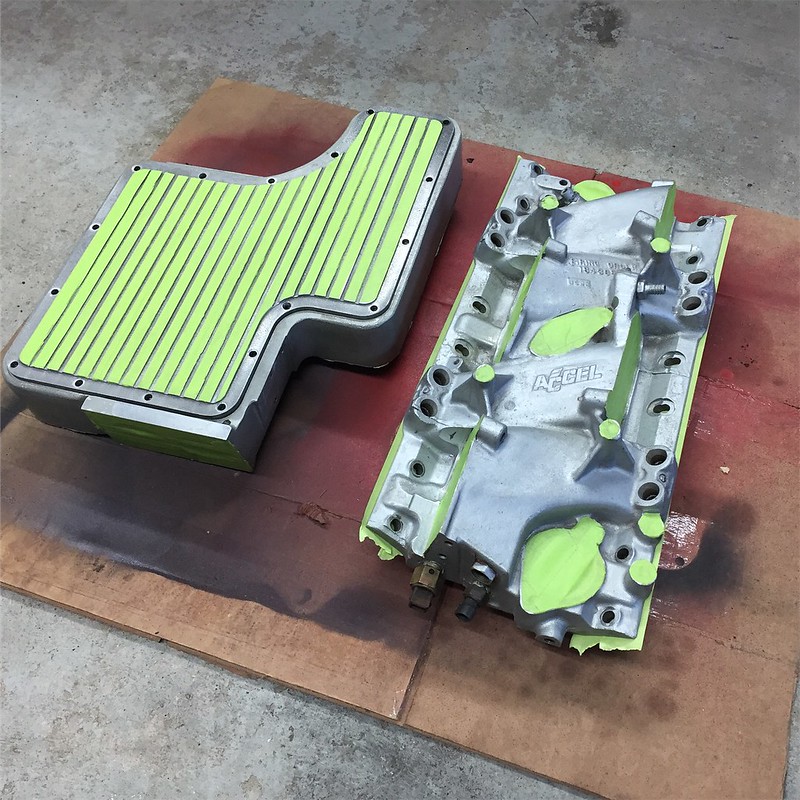

I'm still working on cleaning and masking off parts of the intake manifold... lots of small cracks and crevices to get clean!

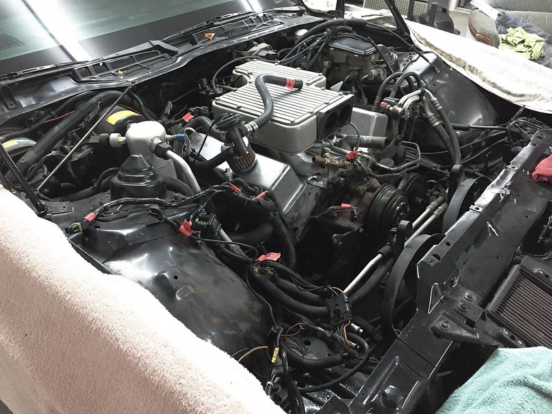

[QUOTE=garage_engineer;669865]Made some good progress the past couple of days disassembling the engine bay. I've got the radiator and A/C condenser out, removed the alternator and the A/C compressor and have started tackling the wiring harness little by little and making sure I'm taking pictures and tagging everything.
Some progress pics:
OMG i remember installing one of those intakes WAY back on a 85/6 Corvette when they first came out WHAT A NIGHTMARE!!!
Blake Foster
www.speedtechperformance.com
It's definitely a pain! A ton of little pieces and fasteners that are hard to get to... sure looks cool all installed though!

My intake is pretty much painted now. Took a long time to scrape off some old paint, clean in all the nooks and crannies and then tape all the sealing surfaces off. I think it turned out pretty good though:

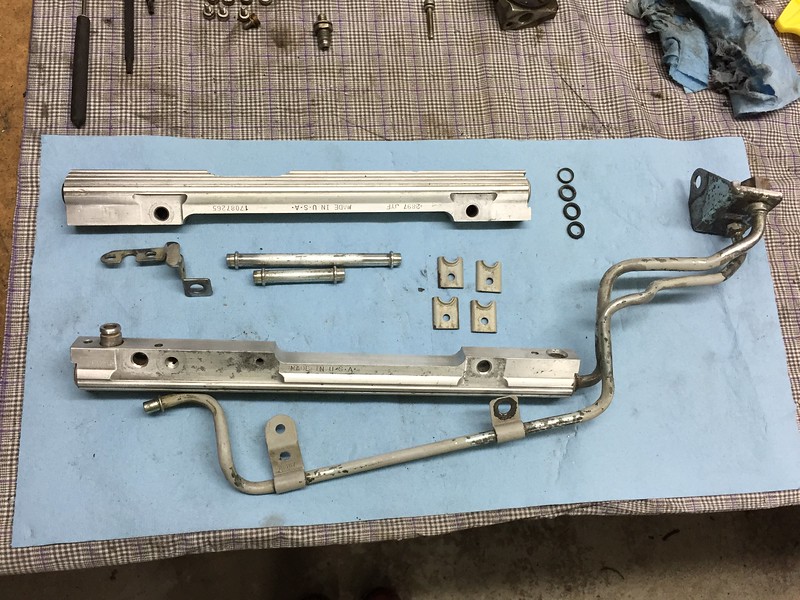

2. My fuel rails are all cleaned up, and I want to put new O-rings in before reassembling them. Any idea where the get the correct ones? I'm thinking I can maybe call Accel and see what they recommend.

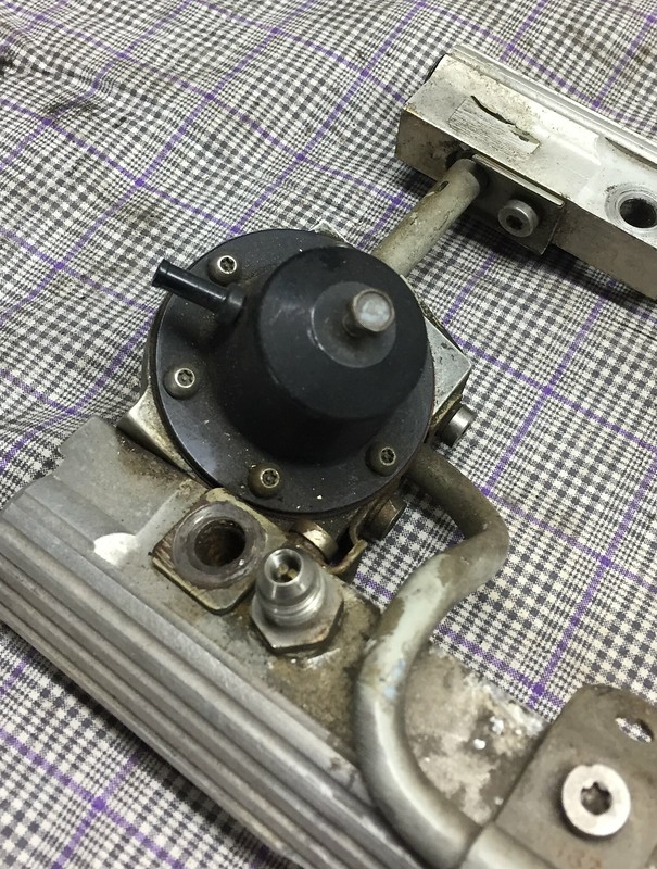

4. Lastly, I would like to order a new fuel pressure regulator. Any idea what model this is? It doesn't have any markings on it, but it is adjustable based on the screw on top.

Pretty sure that's a factory fuel rail and not an Accel part. The pressure regulator looks to be just a replacement unit for the factory fuel rail.

Thanks for the tips... I did some more research and ended up ordering a Holley fuel pressure regulator that should drop in.
