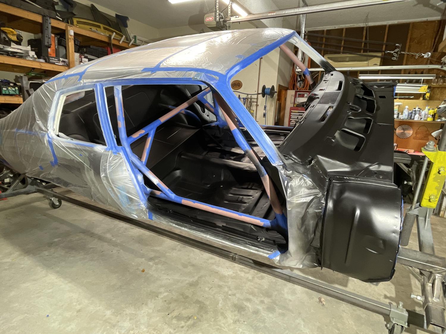

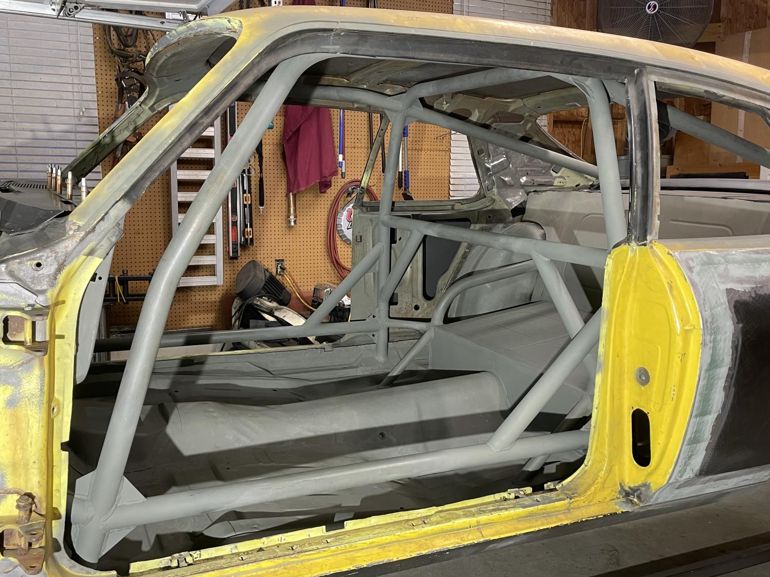

Originally Posted by dug View Post
Nice work so far. I really like the tubing in the trunk area, it looks good and I've never seen something like it. What was the idea behind adding it?
Thanks. It’s structural. I moved the factory frame rails inward and felt like I needed to reinforce/tie them to the rest of the cage/chassis structure. I’ve essentially adopted the practice of “ladder” bracing the entire factory chassis. Maybe overkill but I guess I’d rather over build it than under build it. You may find the mid-frame upper crossmember interesting as well. Haven’t posted that part of the build yet but I’ll throw one in this post so you can see it. I have a lot of work in the cage for this car.
