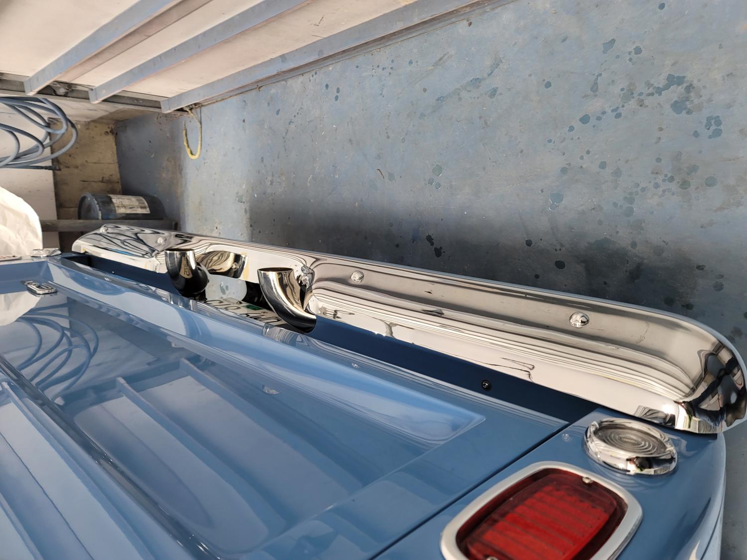

Detail on the Cgt horn button

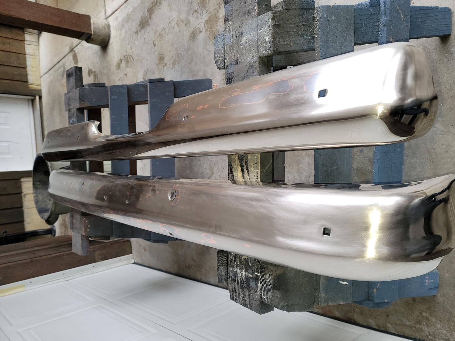

Default Picky picky picky
Have dealt with a Chrome shop for years. Had them rechromed my bumpers. Installed them but just couldn't live with the waves. Talked with the shop and decided a course of action. I took back and while I waited they removed the chrome. I then took them home and spent a week blocking the nickel and copper. 80 grit up to 400. Much straighter. Their now back with the shop to get copper, nickel and then chromed

  #95
Old 12-03-2021, 06:16 PM
Posts: 6,620
Thanks: 1,784
Thanked 923 Times in 687 Posts
Hell, I thought they looked great to begin with. Good luck with it!
  #96
Old 12-03-2021, 08:28 PM
vet57air's Avatar
vet57air vet57air is offline
Join Date: Feb 2021
Location: West coast Canada
Posts: 140
Thanks: 33
Thanked 135 Times in 66 Posts
I'm my worst customer, picky, picky, picky.

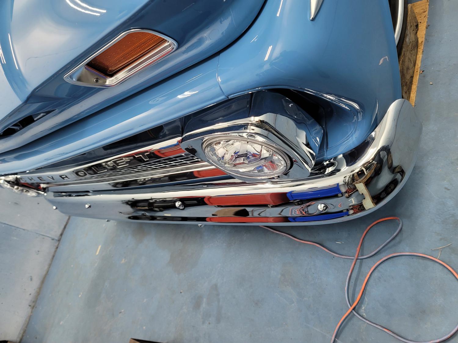

Got my bumpers back and installed.

Very nice.

Very slick and smooth. Do you like them now?
I acknowledge to myself that I am pretty picky. For me it was worth the extra effort to make them this nice.
