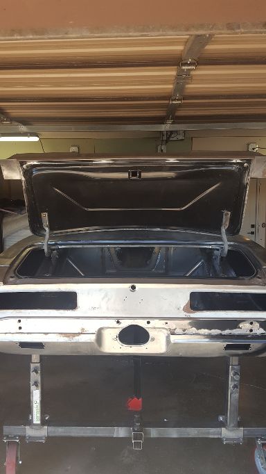

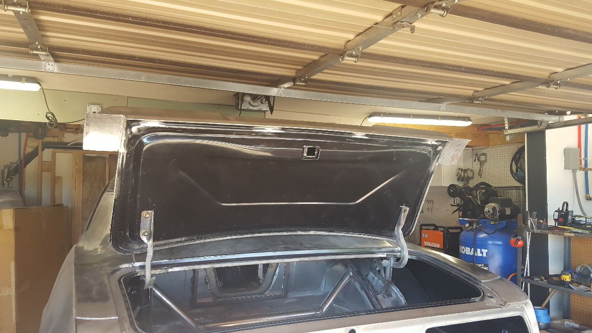

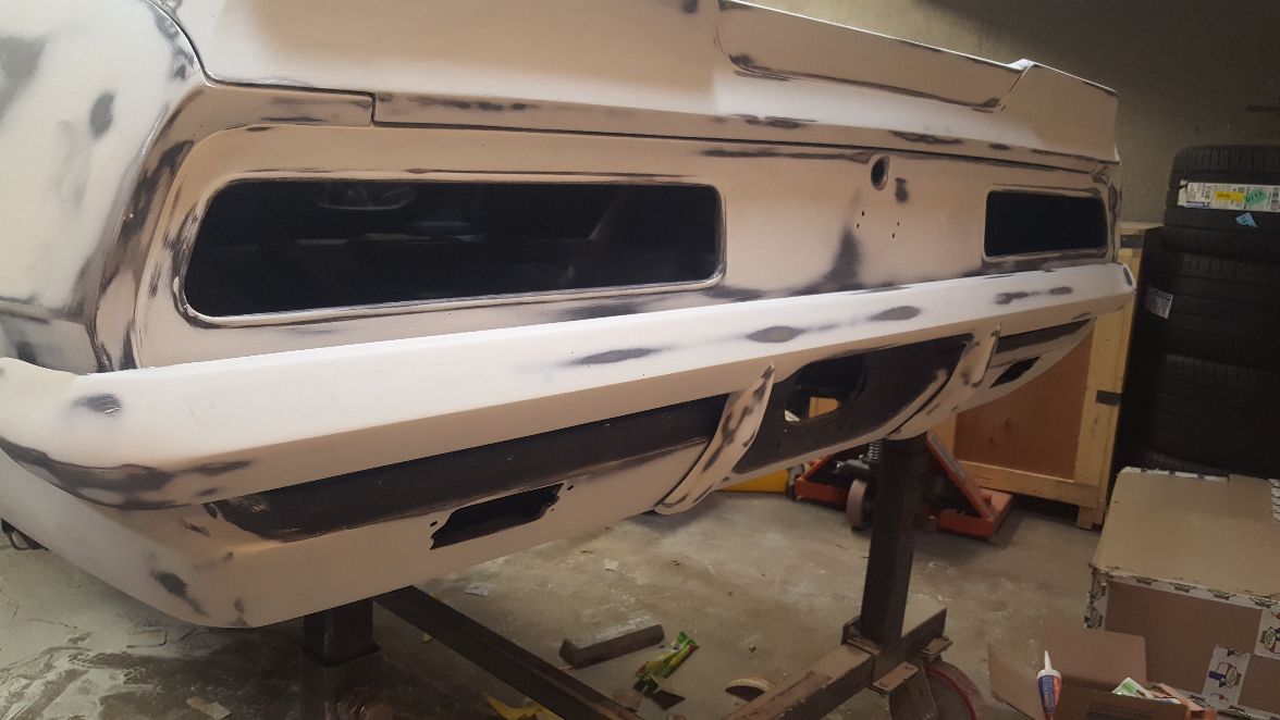

Fitting the rear spoiler Step One:
First, get yourself a friend who is a badass metal fabricator and have him make you a rear spoiler with the same shape and dimensions as the stock spoiler. Don't forget to notch the center.

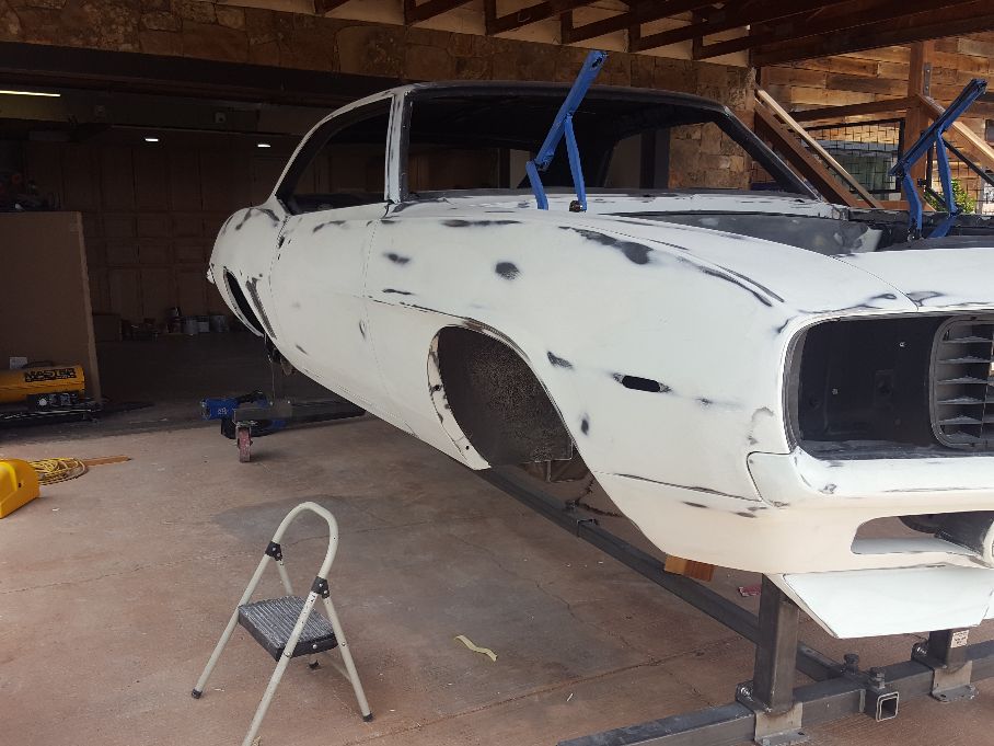

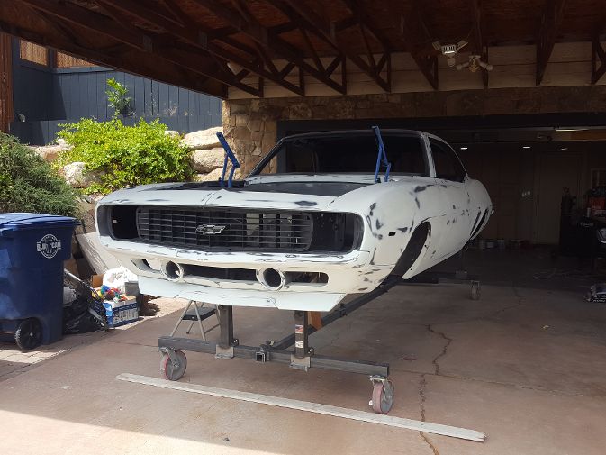

Fitting the rear spoiler Step Two:
Fit the spoiler on the car and decide you don't like because the ends above the quarter panels sit up too high.

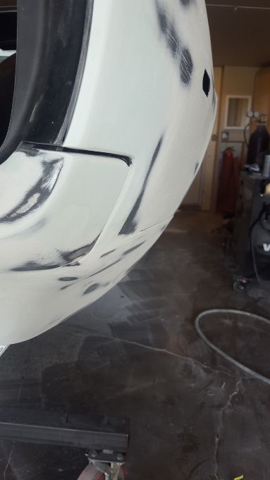

Fitting the rear spoler Step Three:
Mark the top of the quarter panels with an outline of where the spoiler lands when the trunk is closed. Cut out the marked area, recess it down about 3/32's of an inch and weld it back in place.

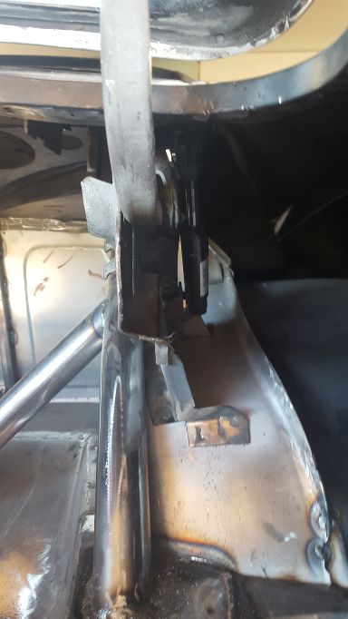

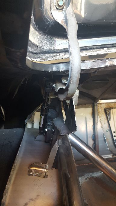

Fitting the rear spoiler Step Four:
Find yourself an extra set of billet hood adjusters you have laying around along with some steel tubing you also have laying around. Cut tubing to proper size, weld in a nut and recess them into the tail panel. Insert hood adjusters and make sure your trunk closes the same every time.

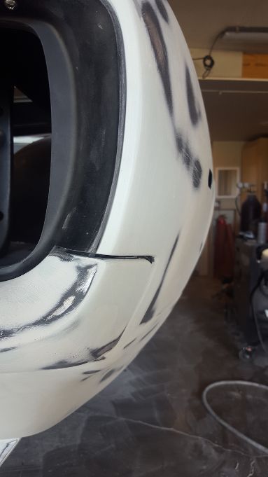

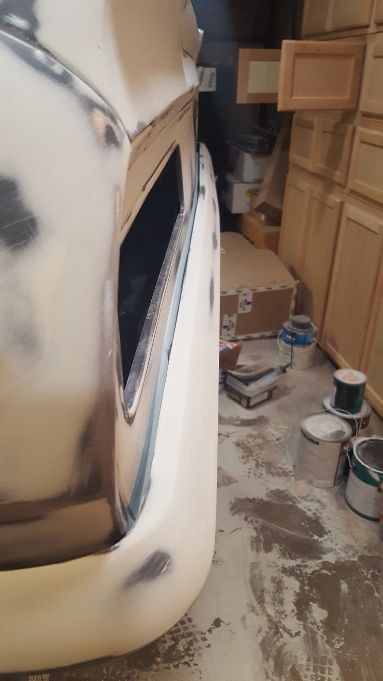

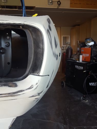

Fitting the rear spoiler Step Five:
Re-intall trunk lid. Hammer and dolly the ends of the spoiler to match the contour of the quarter panels. Add metal or trim metal where needed for perftect gaps.

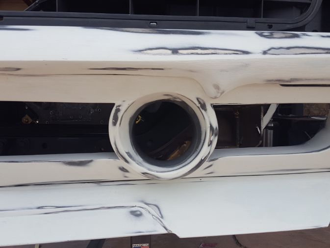

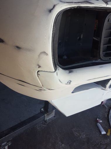

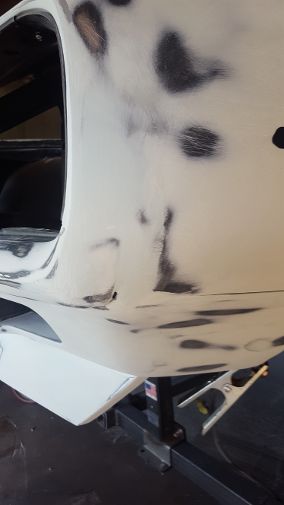

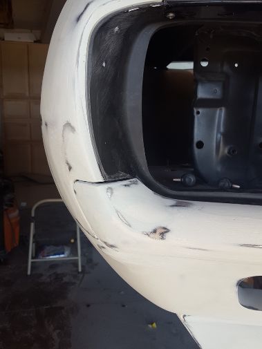

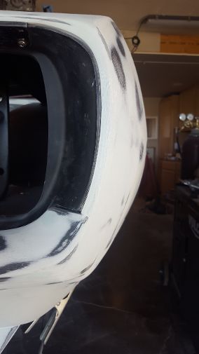

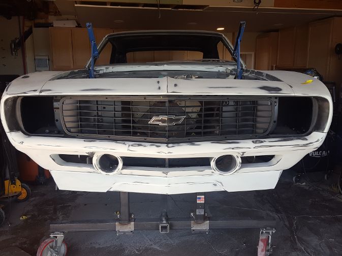

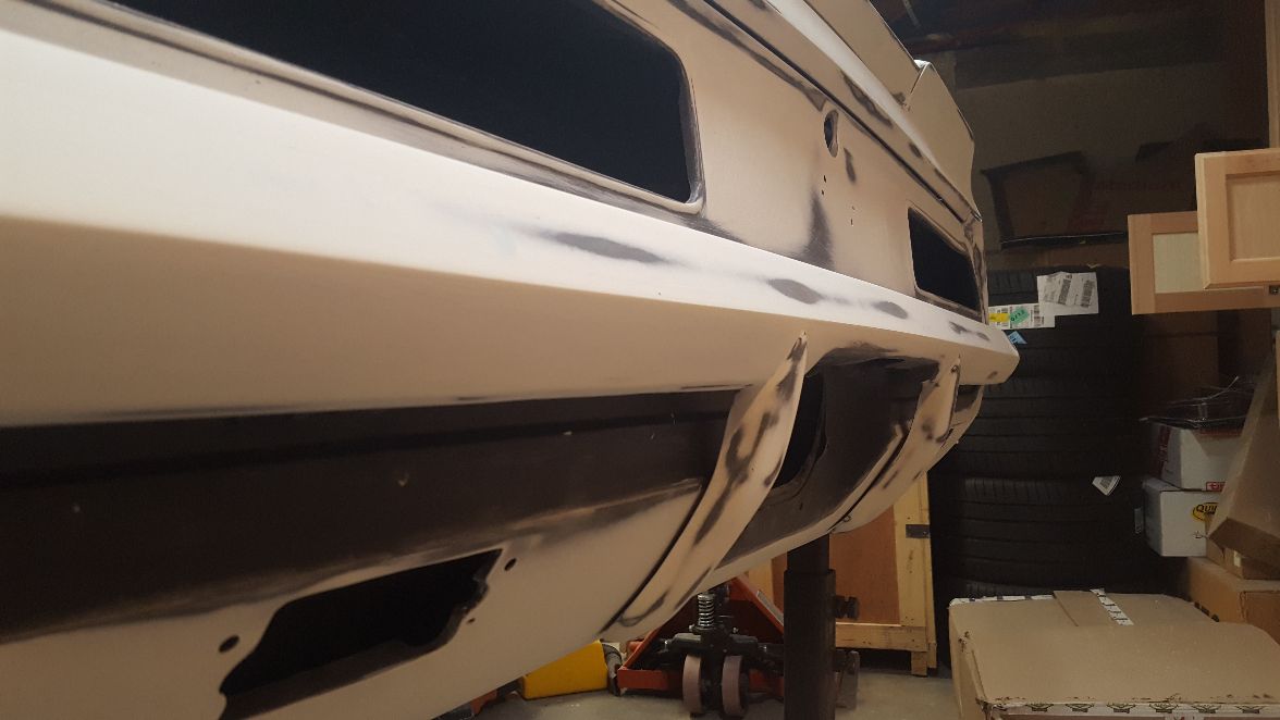

Fitting the rear spoiler Step 6:

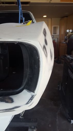

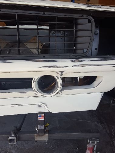

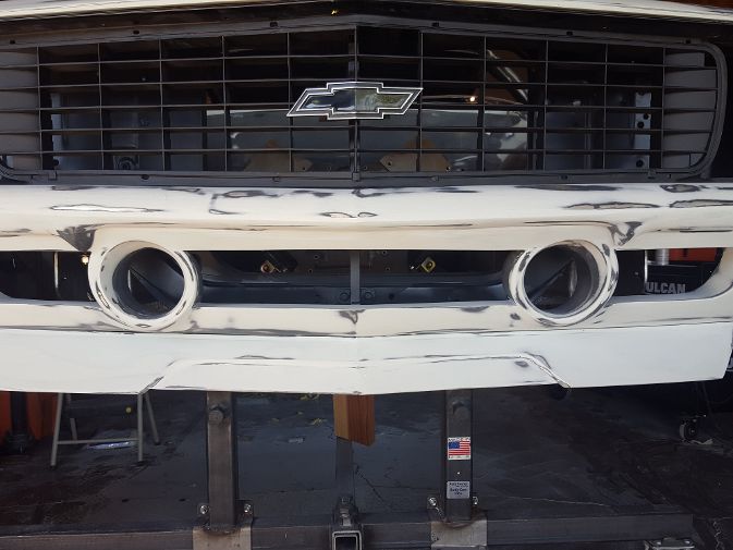

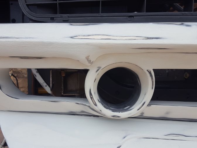

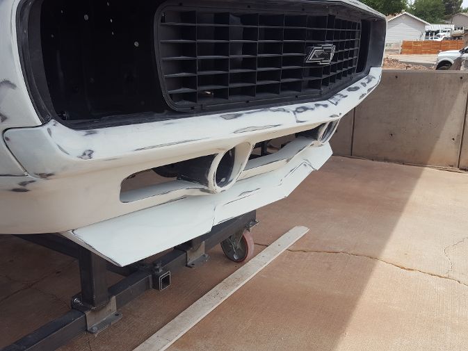

Move on to the front spoiler, give your same badass friend the crappy original and tell him to duplicate it in metal. Then tell him to notch the center and make it look like the front and rear spoilers belong together.
