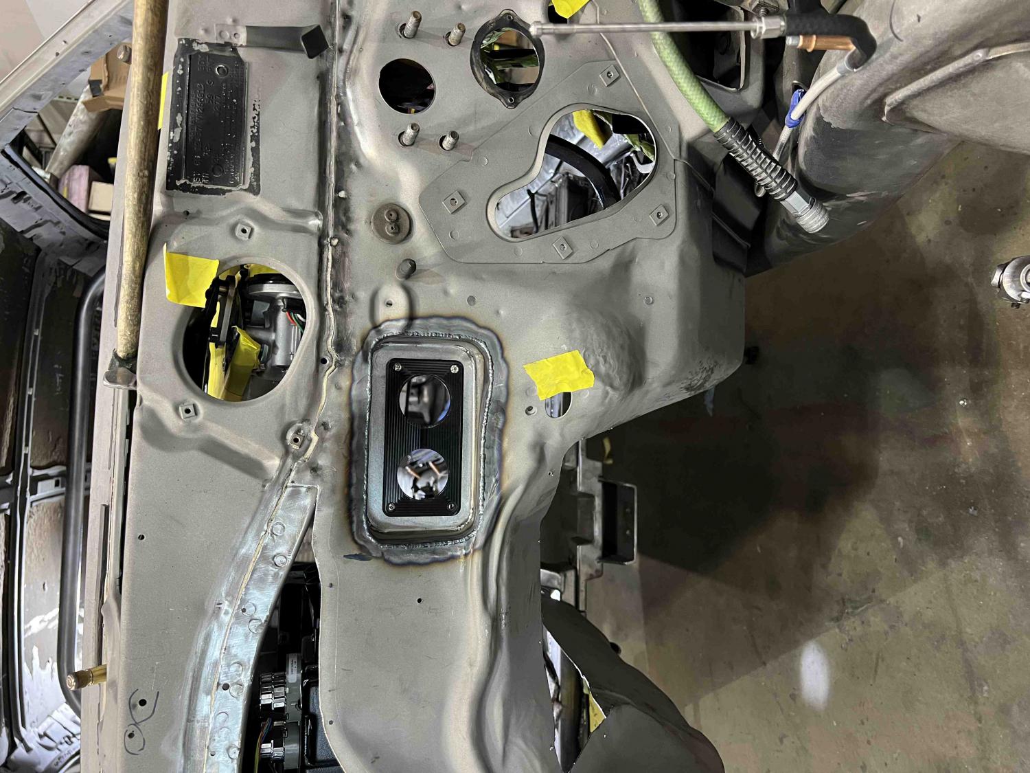

Close out panel

Looks incredible and seriously I can't wait to see more pictures

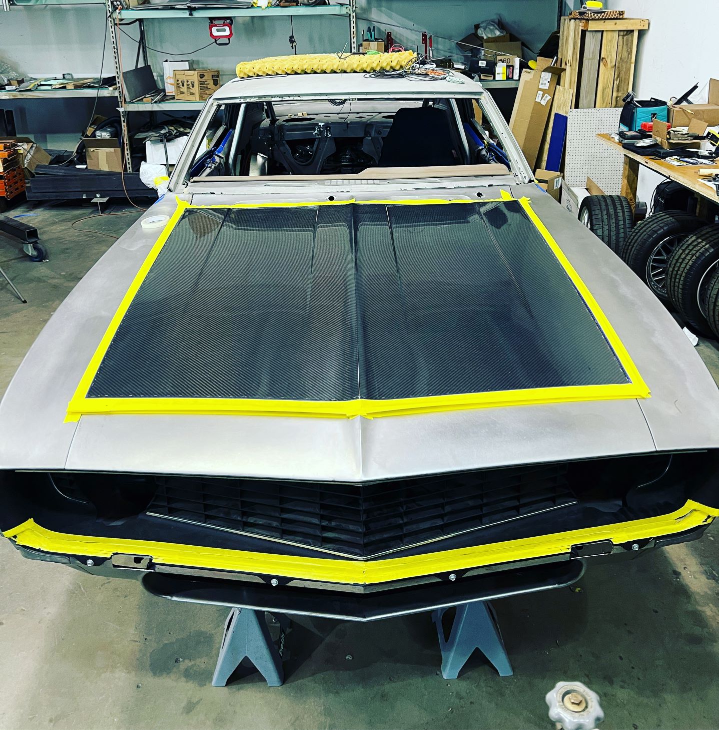

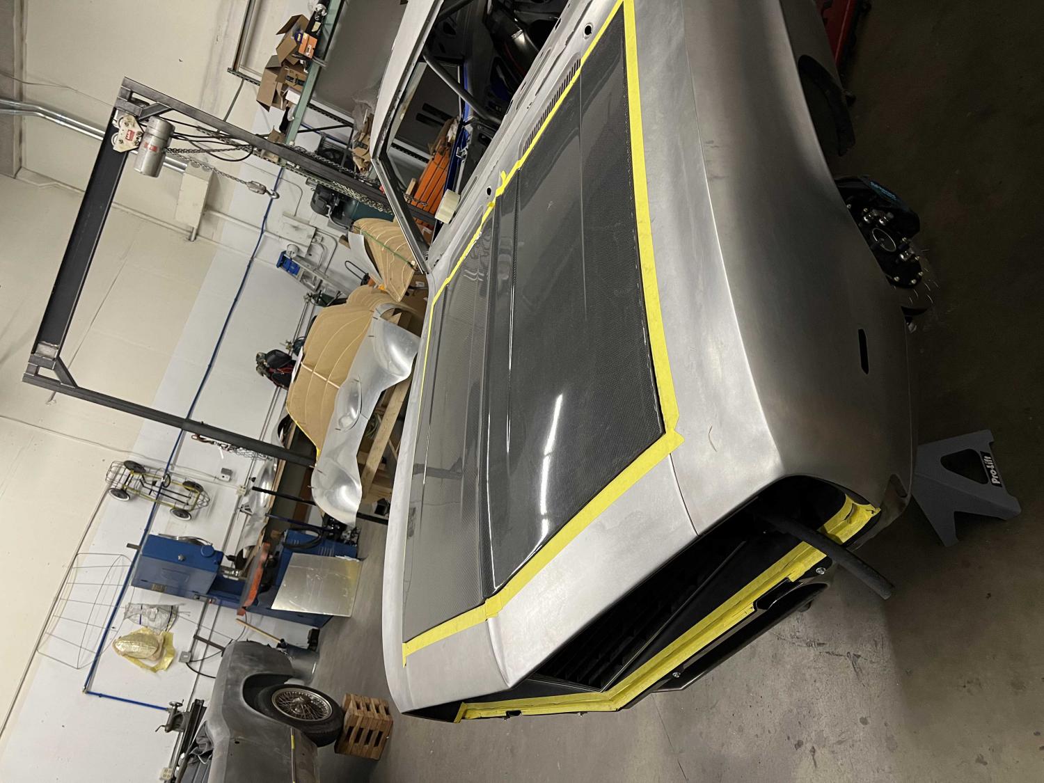

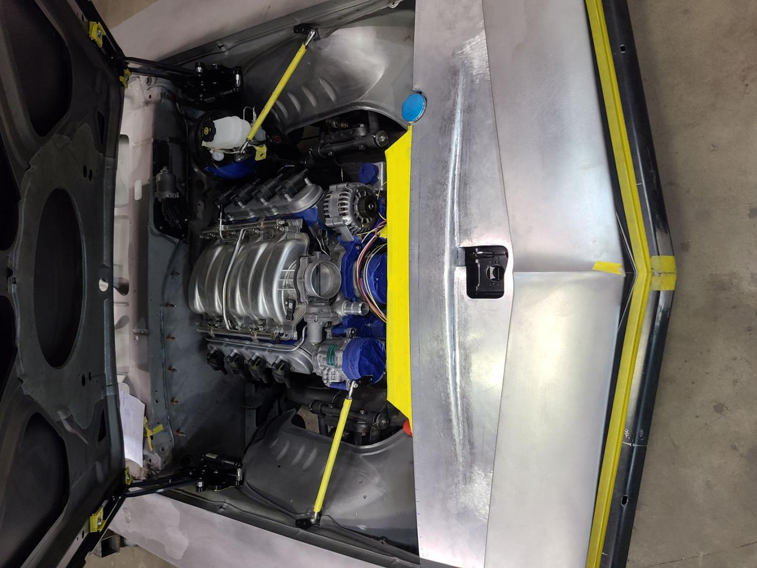

Ultra Carbon, we used an uncut flat hood from Ultra Carbon and cut it for the correct gap, we are also using their front and rear spoiler. Planning to fit the pieces, get them flat, clear coat and matte clear wrap them. Ring Brothers hood hinges were used which took a little massaging and have interchangeable hydraulic springs to use the steel cowl induction hood or the CF flat hood

What an incredible car and project !!!!

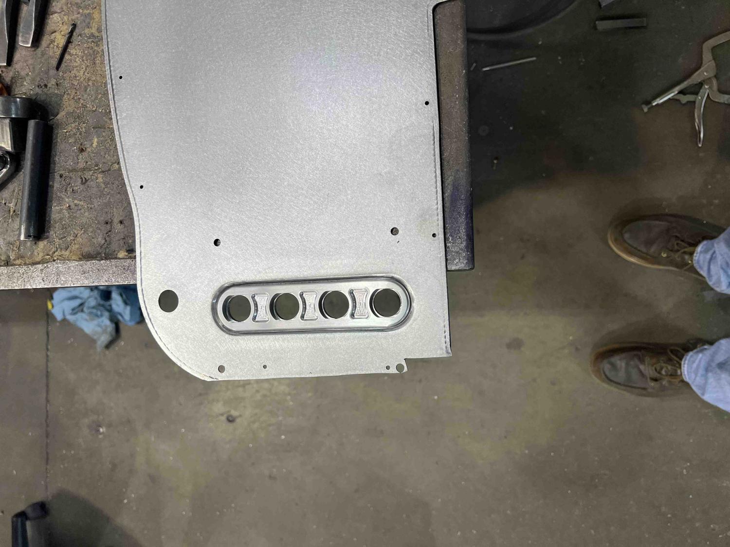

The metal work on this is on point. That last picture should be a poster.

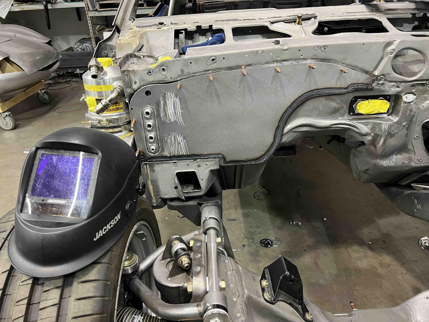

Firewall

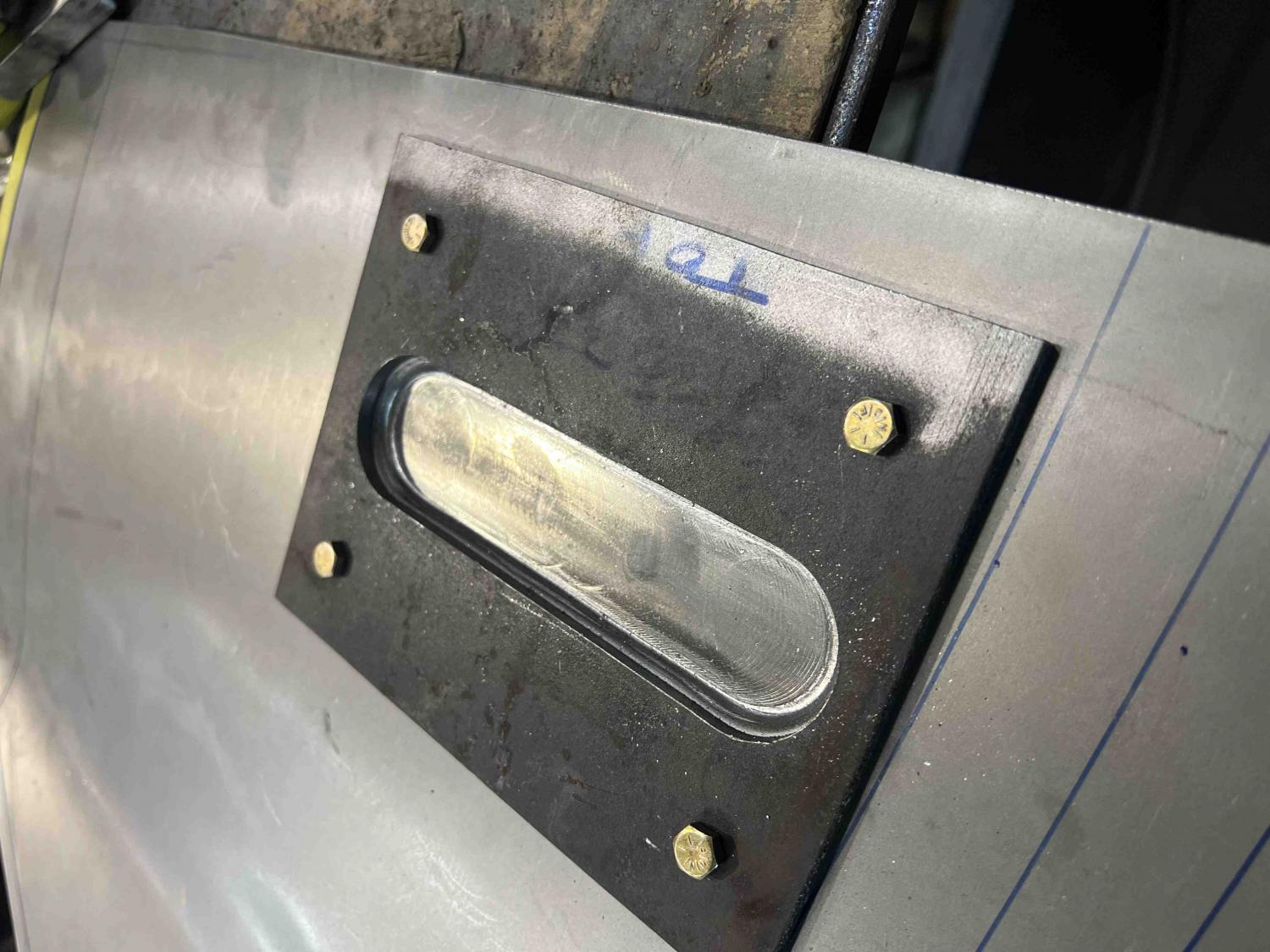

Firewall 2
