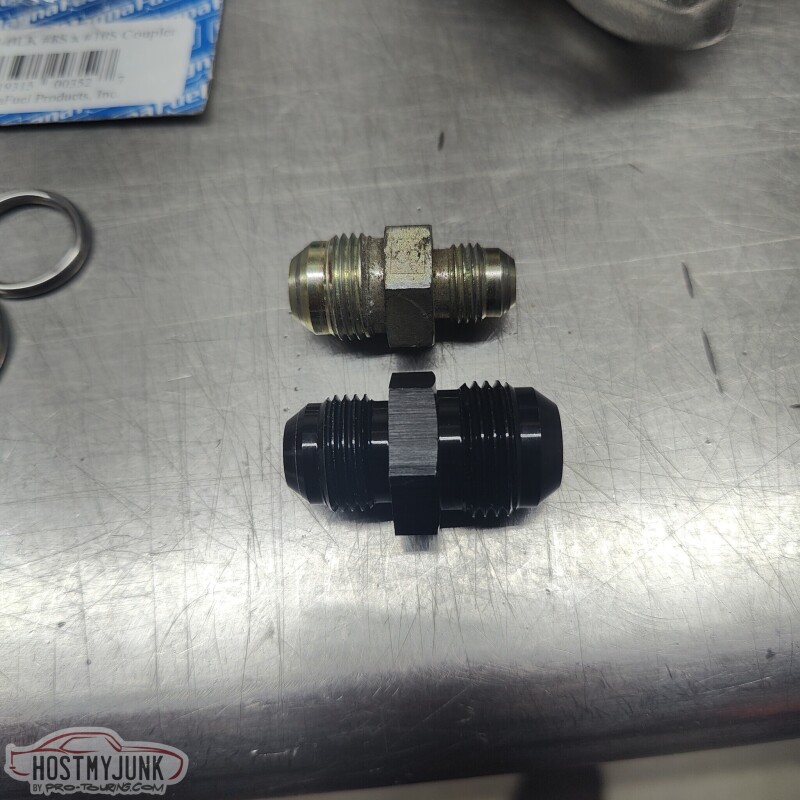

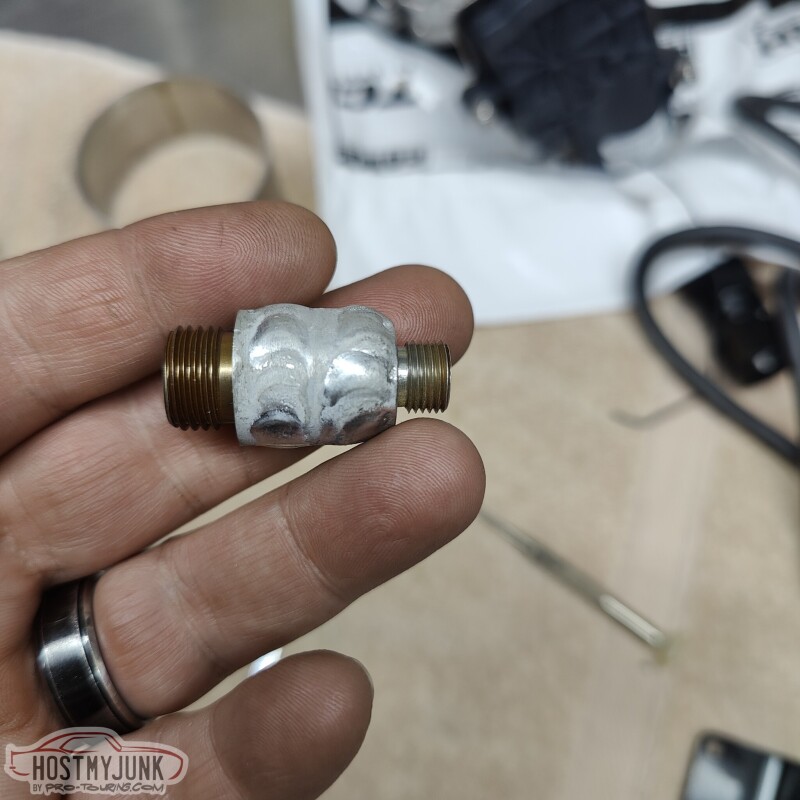

After mocking up the engine the first time, it was clear that the oil drain fitting that I got was not going to work. At least not without some modifications.

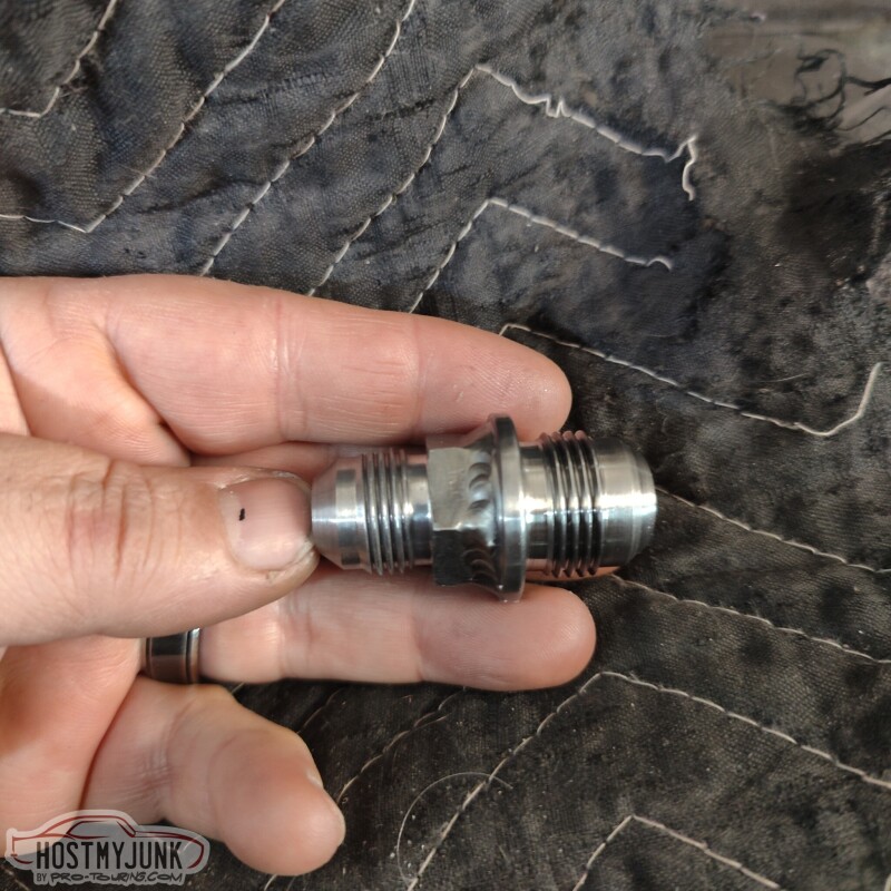

I can't believe I have gone this long without having a lathe and a mill. Both were used to modify the Earl's fitting in order to make it fit.
The lathe was used to back-cut the area between the end of the threads and the hex area. This was done so that the fitting can be installed deeper into the boss on the side of the pan. The mill was used to trim the end of the threads, because with the fitting screwed in deeper, it would hit the oil pick-up tube.
The outside of the fitting was also smoothed and contoured on the belt sander. It is a rather bulky fitting and there was plenty of material to remove in order for the fitting to match the contour of the front cross member. The pan was also removed in order to tap the 1/2" NPT threads a little deeper.
It took a total of six rounds to get it to the point where the engine mounts dropped into the frame stands and the mounting bolts to slide in.
The fitting has about 1/8" clearance against the crossmember, and it is able to pivot freely.

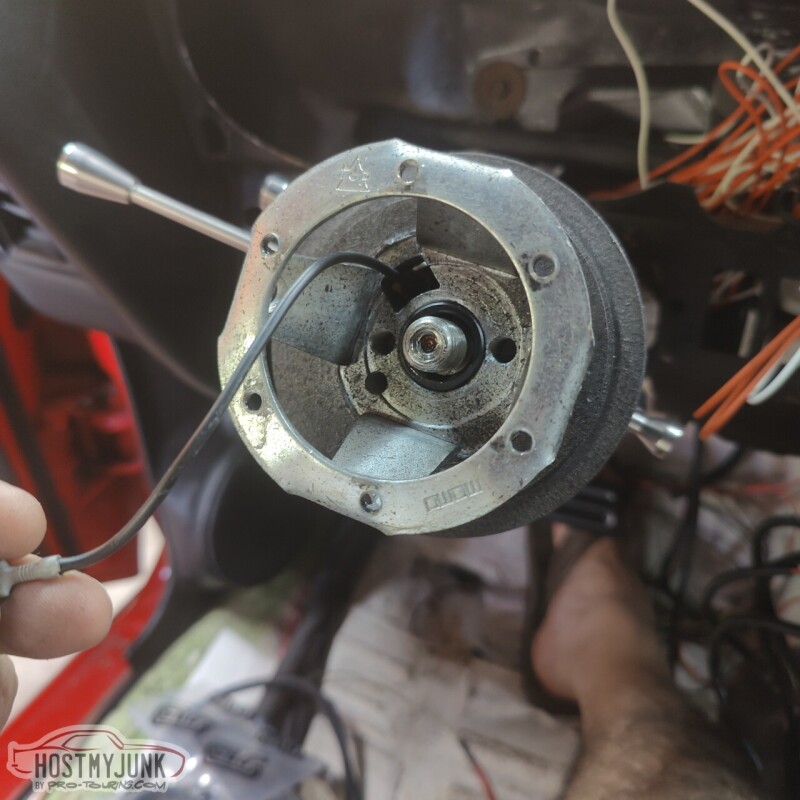

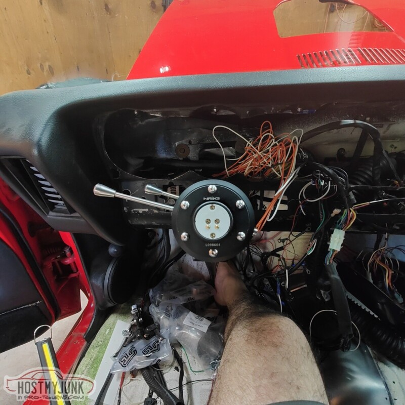

Now that the car is back, I felt the need to go out there and do something, even if it is something small. Keeping in mind that I will be doing a lot of wiring under the dash, a removable steering wheel hub seemed like a good idea. My friend Tom had a NRG steering wheel hub on his 70 GTO and I really liked it.
I started by removing the horn button and removing the Momo steering wheel from the Momo hub.
Then I removed the nut that was holding the hub in place.

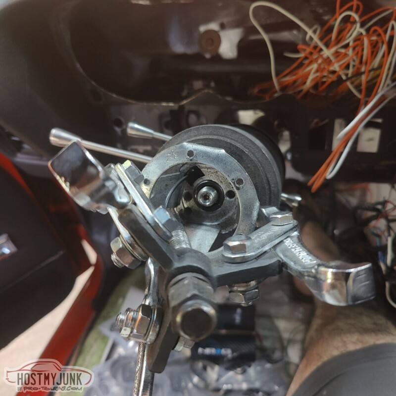

I had to use a 3 jaw puller to get the hub off the steering shaft.
This is the Momo adapter hub for a GM steering column. If anyone needs it, PM me.

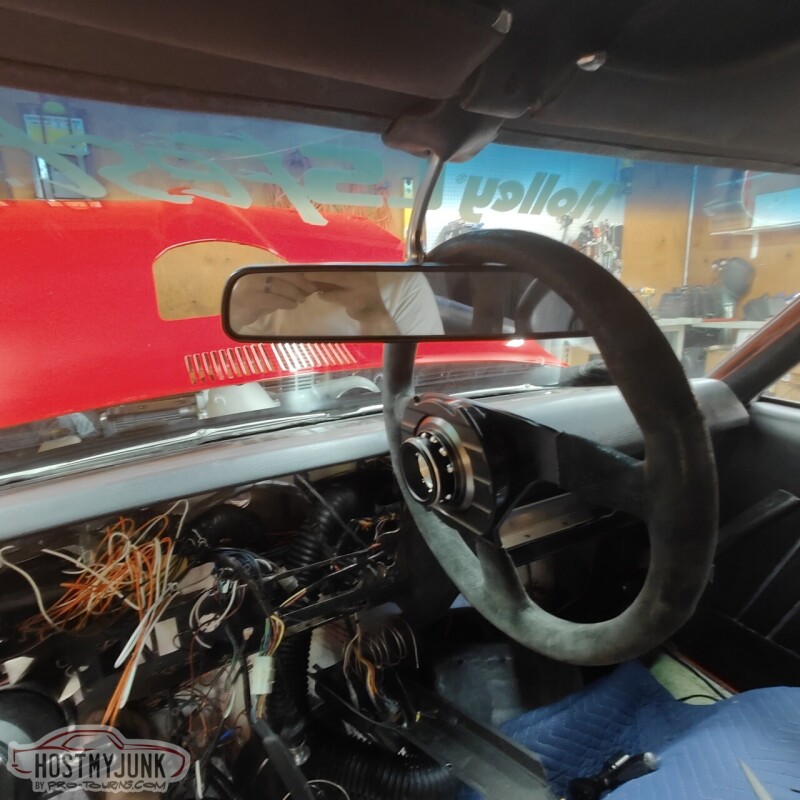

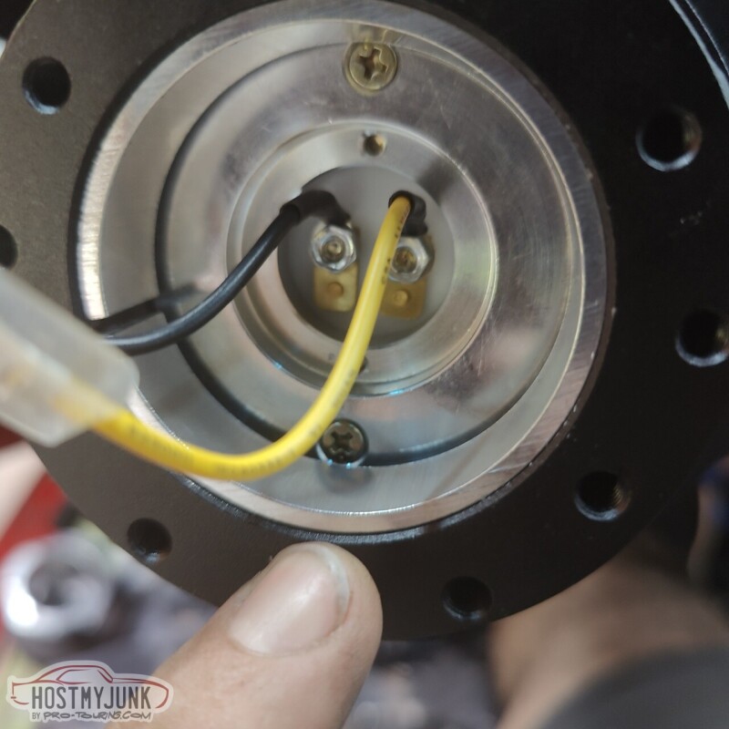

This is the new NRG hub. None of these parts came with any instructions. I am not exactly sure why the hub has a ground wire on it...
This is the hub that bolts to the steering wheel and snaps on the receiver that is bolted to the steering shaft.
This is the finishd column with the receiver hub bolted to it.
To release the steering wheel from the column, the ring under the steering wheel is pulled back...
and the steering wheel comes off, along with the hub.
It will be a lot easier to work under the dash without the steering wheel in the way and it adds a small level of theft protection to the whole car.

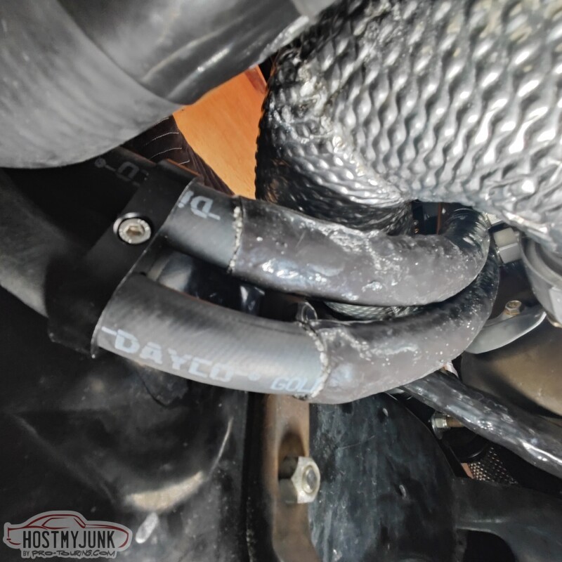

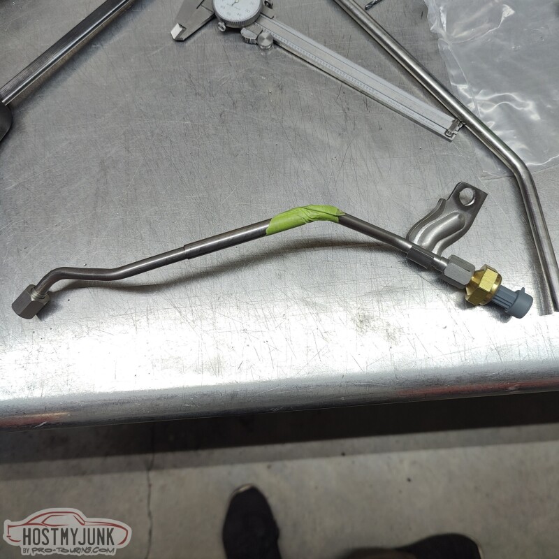

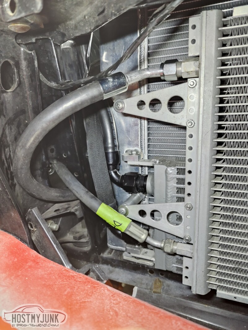

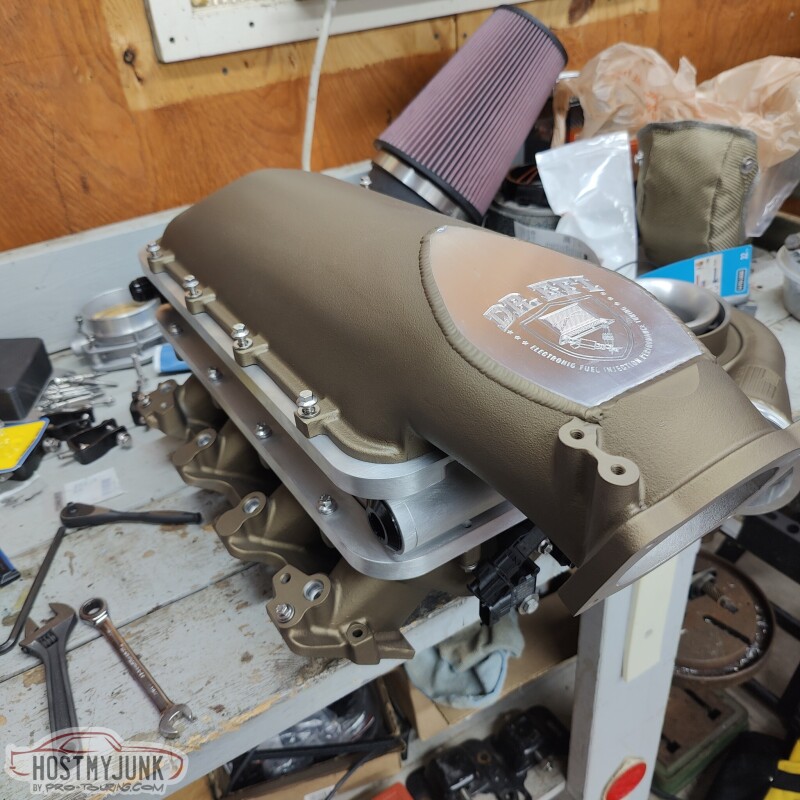

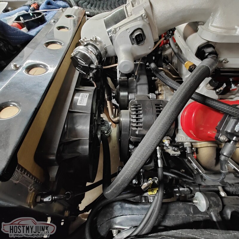

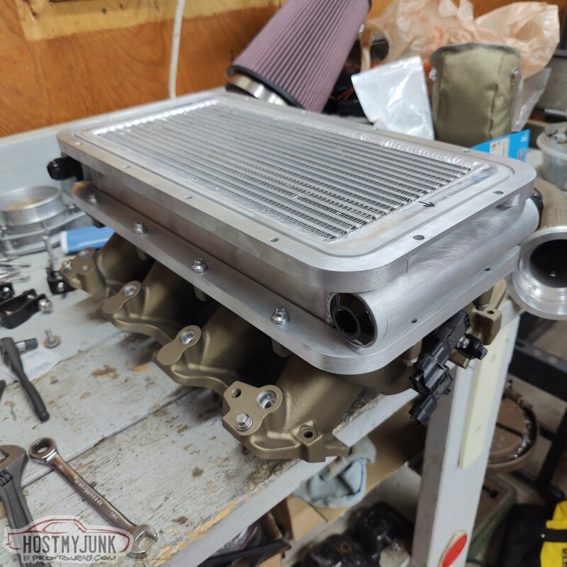

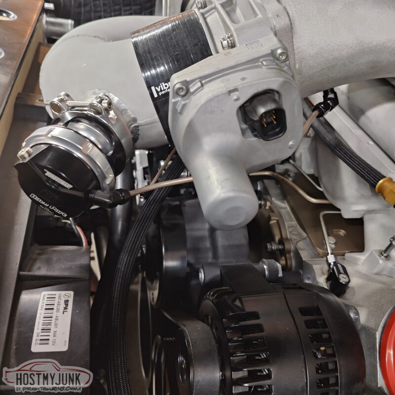

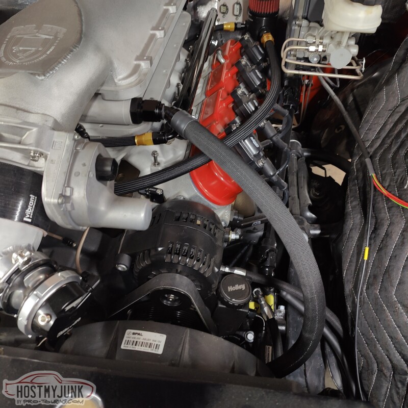

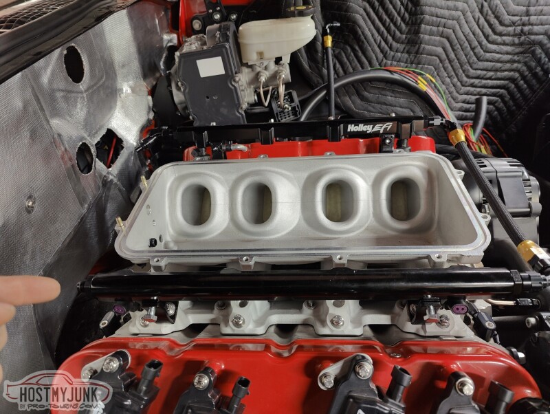

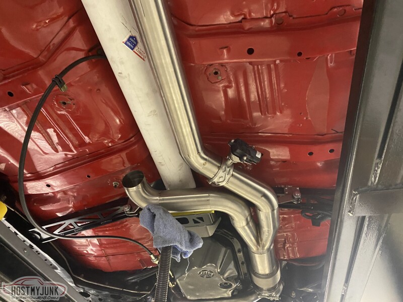

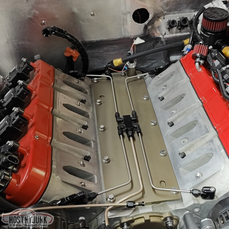

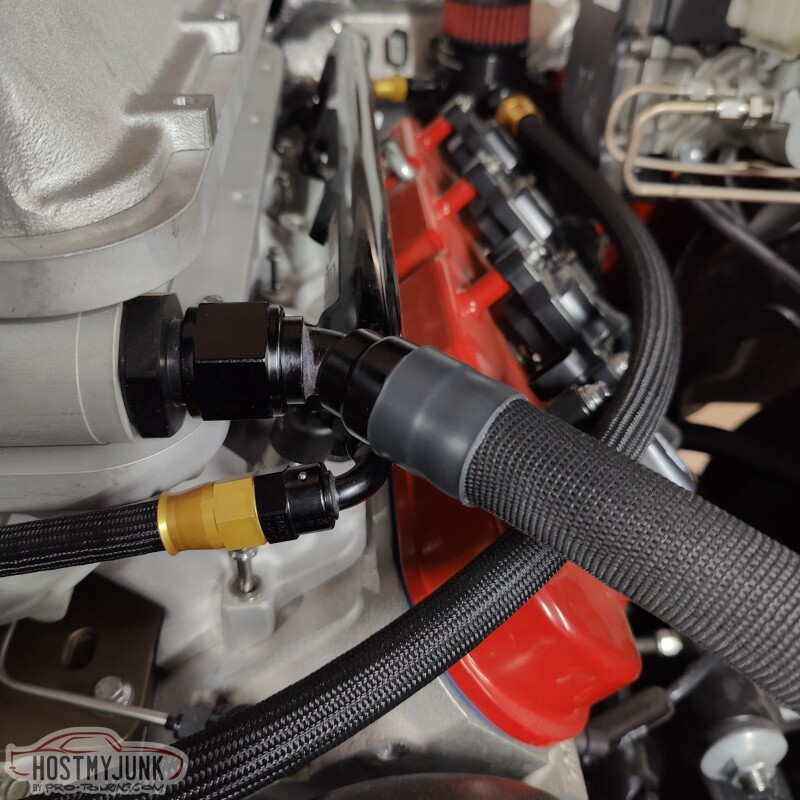

With the car now in my home garage I am able to spend a hour or two here and there and knock out little projects. Just like the old saying about how one might eat an elephant...

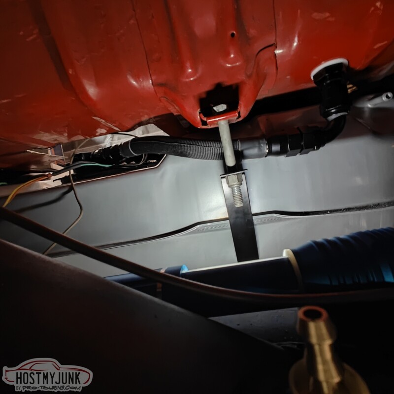

This picture is at a little bit of an odd angle, but it shows the finished turbo drain. While the car was at Hotrod Express, I asked Josh to put a bead in the 5/8" stainless tube that we used to extend the drain pipe. There is also a little section of 5/8" oil safe rubber hose that goes from the tube to the oil drain on the side of the oil pan. I used Gates heat shrink clamps on the hose. The stainless tube also has a silicone/fiberglass fire shield over it.
This picture is also at a bit of an odd angle, but it shows how the heater hoses come down from the water pump and under the up-pipe. There is fire sleeving over the top of the hose where it passes closest to the up-pipe.
Here is the view from the top. Everything fits very closely together, but there is just enough room to turn fasteners and fittings. I also used the Gates heat shrink clamps on the heater hoses.

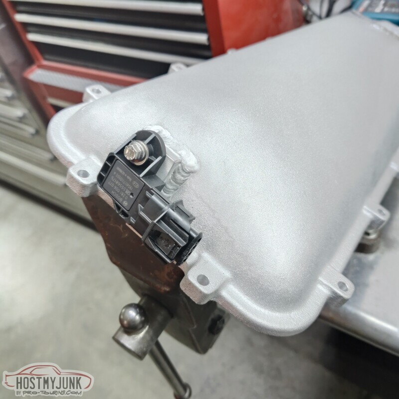

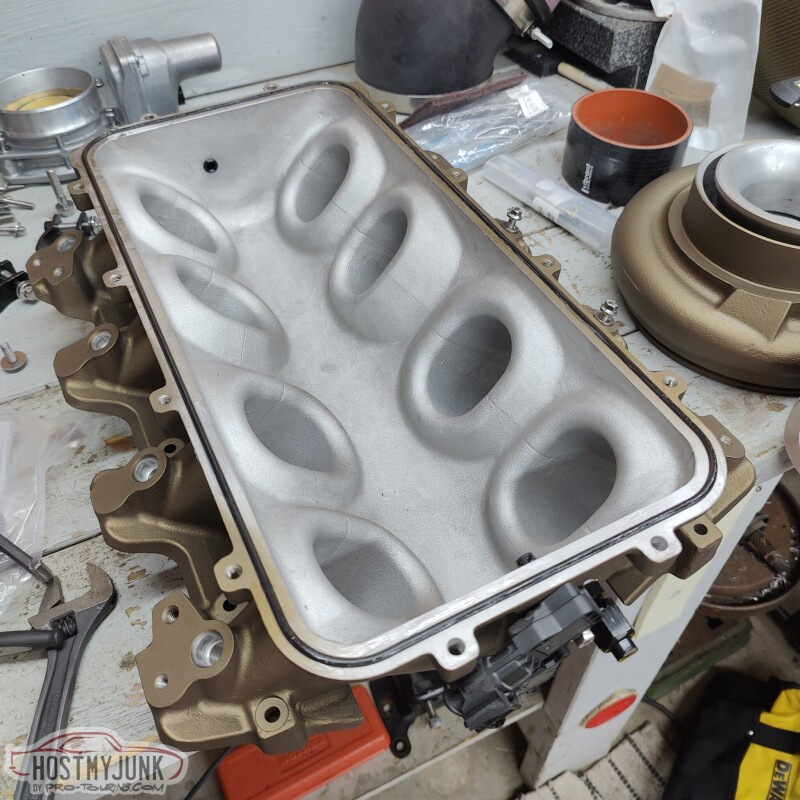

I took the intake off again so that I can clean everything and get it ready for Cerakote. Here I am mocking up the little silicone plugs that I will use to seal off machined and tapped holes.
She is looking more apart than before, but progress is being made.
