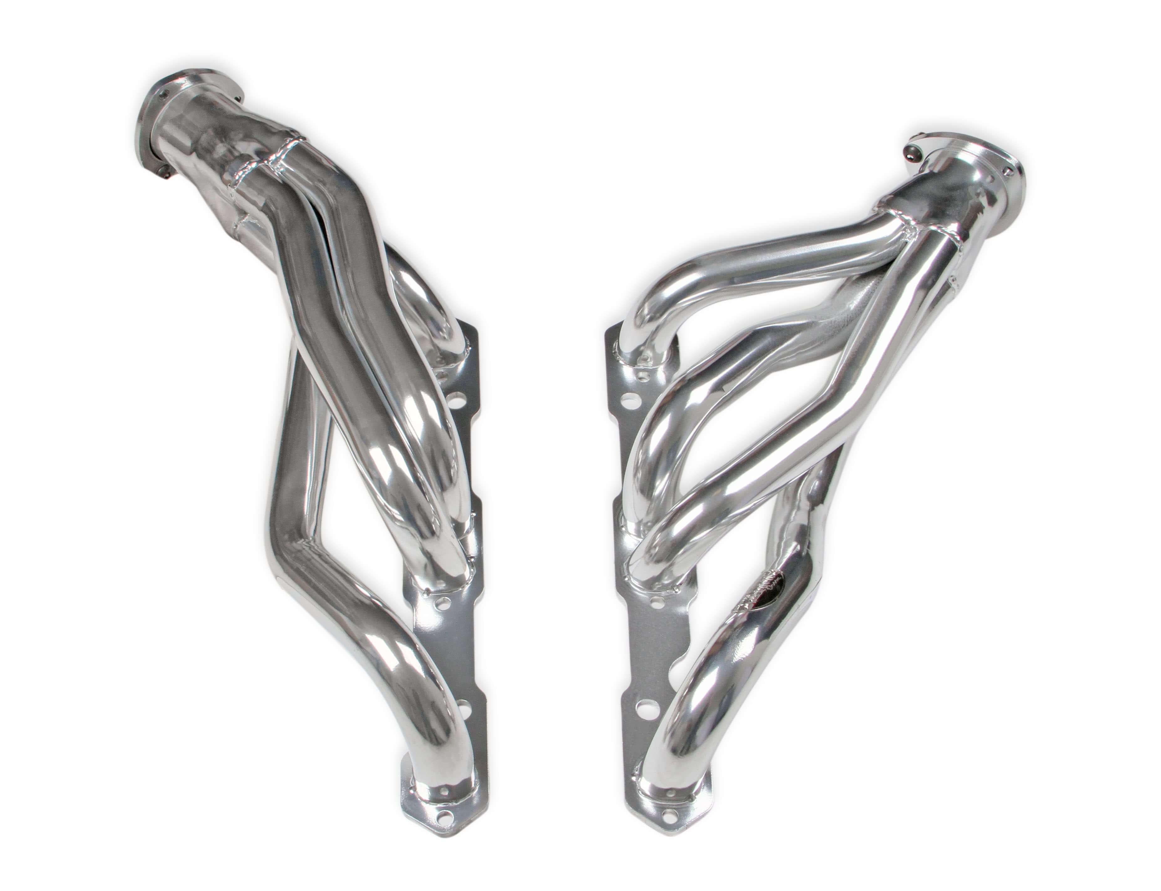

Headers and transmission in place...
Good thing I don't do this for a living, I'd go broke.
Only small parts left on the table now, hopefully the rest goes pretty quick and pain free.

What headers are you running? They kind-of look like the 3/4 length variety in that image.

I guess you would call them a "mid'length". Longer than a shorty but much shorter than a long tube.
https://www.holley.com/products/exha...arts/2466-1HKR
For my application they are probably as good as it would get. A couple spark plugs are a bear to get in and the rear passenger side bolt can only be accessed from under the car. A skinny 5/16s box end can tighten the rest of the bolts down okay.

Ok.... About the same thing I've used on the G-bodies I've done. I call them 3/4 length as most refer the street-rod style that dump like RamHorns as 'shorties'.
