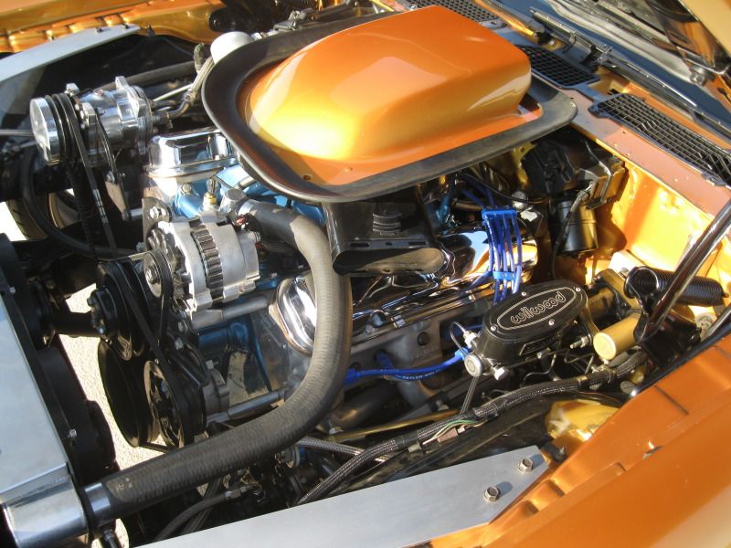

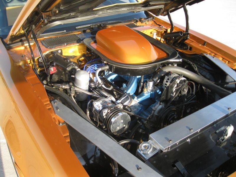

After 17 years of combustionless life, fuel, air & heat have once again been successfully mixed in the cylinders as approx 5 PM this evening. All seems strong and very healthy. Running just headers, the exhaust note is felt in the stomach. Didn't run it too long as the cooling system is dry.
After some waiting for parts, deciding and ordering parts, defeating some walls & hurdles build by life, and other what nots, I have jumped on this fellow once again. Fuel system is complete with 4th gen F-body fuel pump & sender integrated into stock 2nd gen tank. the bulk of the electrical system is completed or at least laid out. I still need to setup the elec fan units and make the relay box for current components and future expansion. Battery is located in the trunk and I was able to feed the 1/0 cable through the frame for a clean look. I found an asphalt sheathing used on antique autos that slid over the cable to prevent wear and corrosion even though the cable has a fairly thick rubber insulation already. Once all the electrical components are inplace and wiring laid, I will tidy up the wiring for a clean look. pics are coming.
