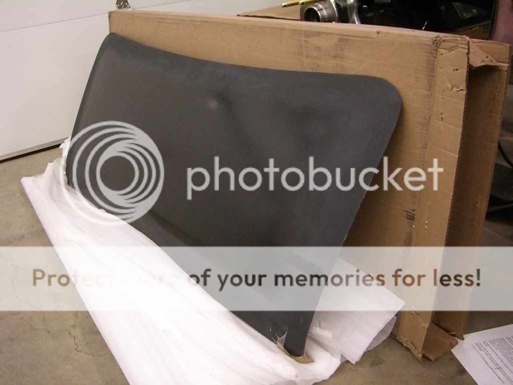

So anyway I got a bit of lightweight goodness in the mail a few weeks back:

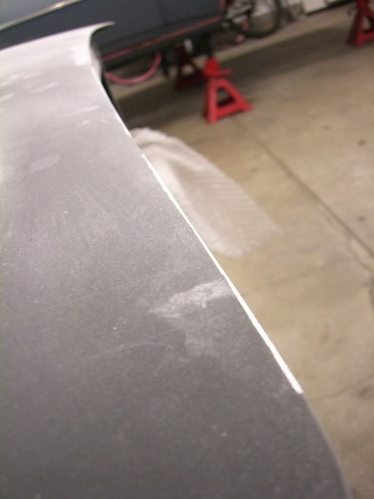

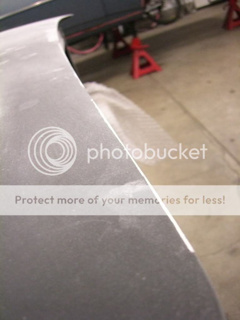

Fiberglass decklid from VFN fiberglass. Weighs less than 10lbs
Pretty darn smooth right out of the box. I'm hoping for minimal bodywork. But...it is delivered a bit oversized which is, I suppose, better than undersized.
[Michael Scott] Thats what she said! [/Michael Scott]

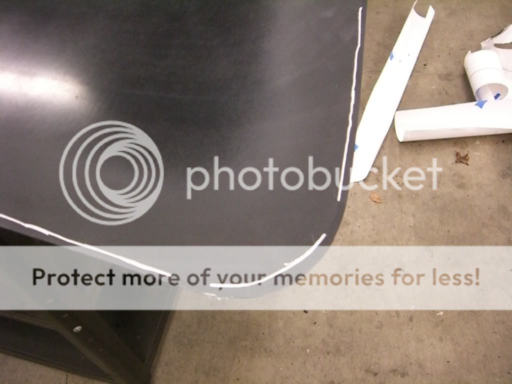

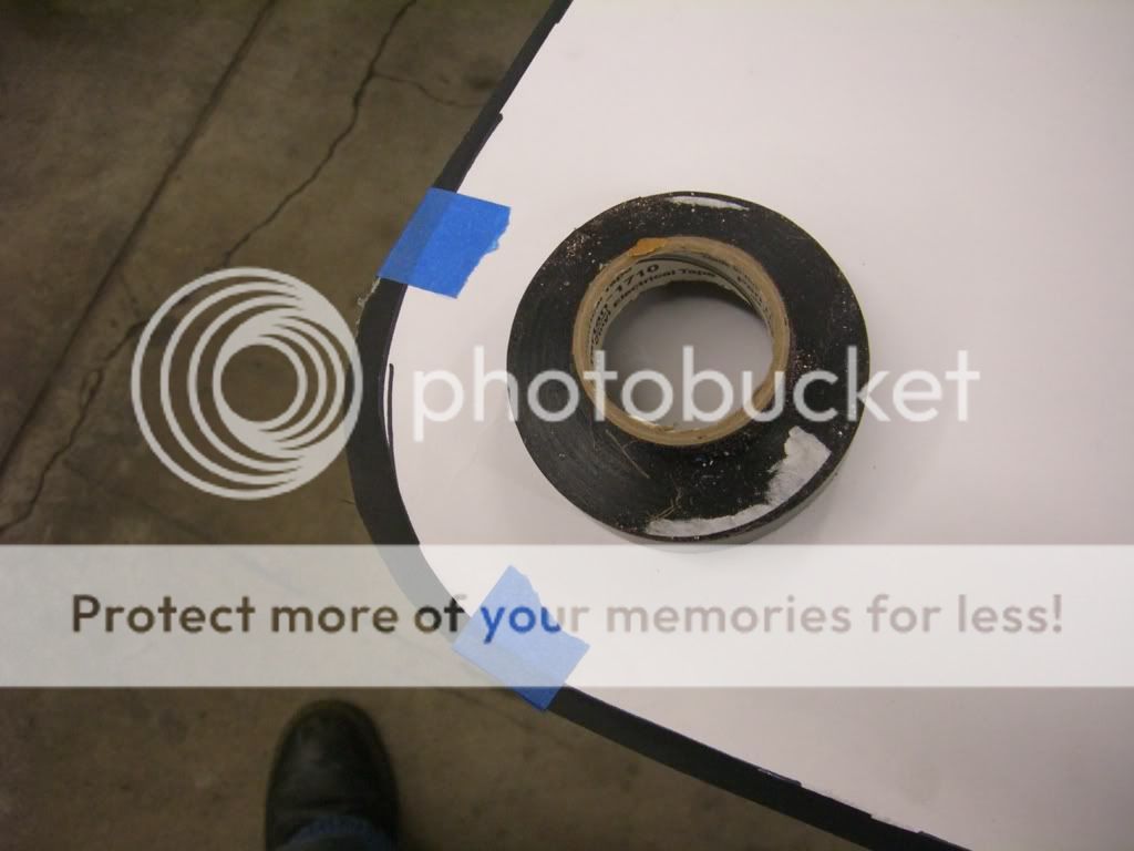

Sooo I had to take a template from the OE decklid and transfer it to the fiberglass replacement. You can see here that the fiberglass decklid is about 1/4" larger than the template. It's oversized by about that much on each axis.
Transferring the template. I am totally good at coloring!!!!

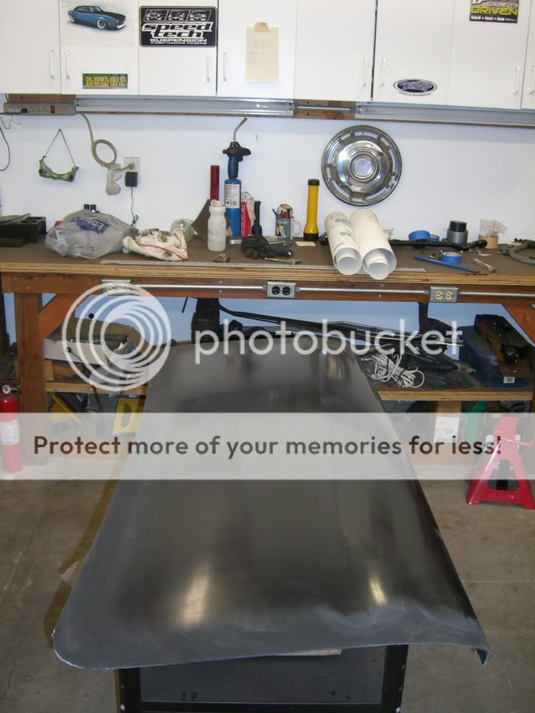

The line is actually at least 3/16" fat all the way around. So what I'll do is cut to the line then begin test fitting and sneak up on the final dimension little by little.
After a bit of sanding....but quite a bit more to go.

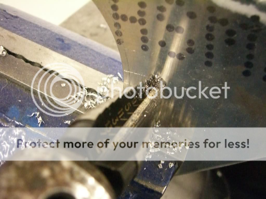

In the process of re-clocking the backing plate/duct I had to relocate the three holes that are used to clamp the backing plate between the spindle and hub. In doing so I have discovered my new favorite tool.
The uni-bit is freaking awesome! Where have these things been all my life!?!?!?!

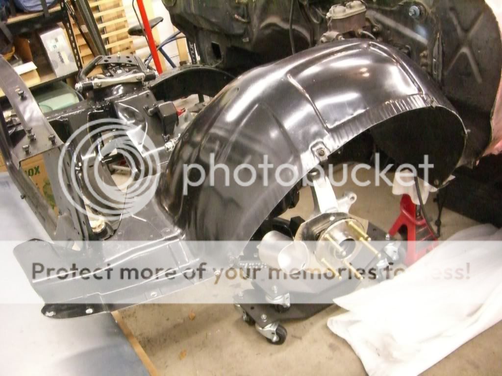

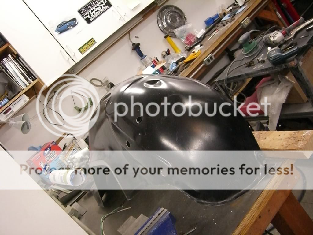

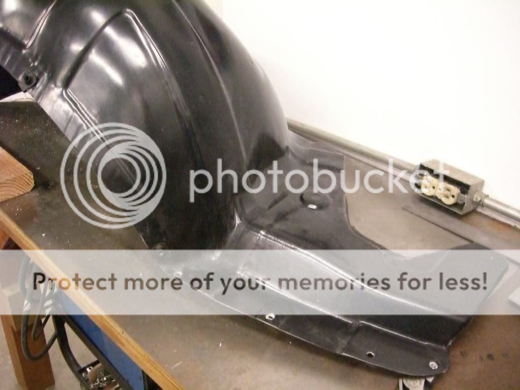

So got that done on both sides pretty easily and went to work on a little more lightweight love.
These things weigh NO-THING. Two of them together weigh a tick under 1/2 of just one of the steel OE units. And......super-bonus.....they FIT! I did have to drill all the holes, but hell, that's a whole lot easier than......don't get me started.....
See....they fit! Sweet.

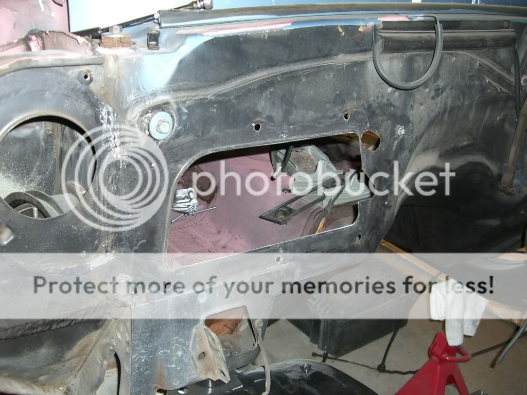

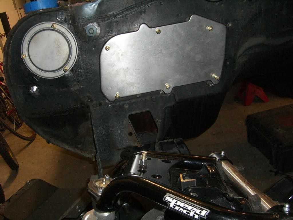

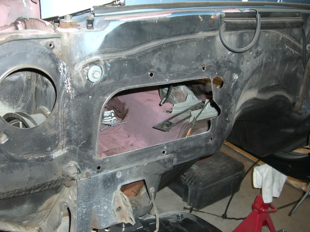

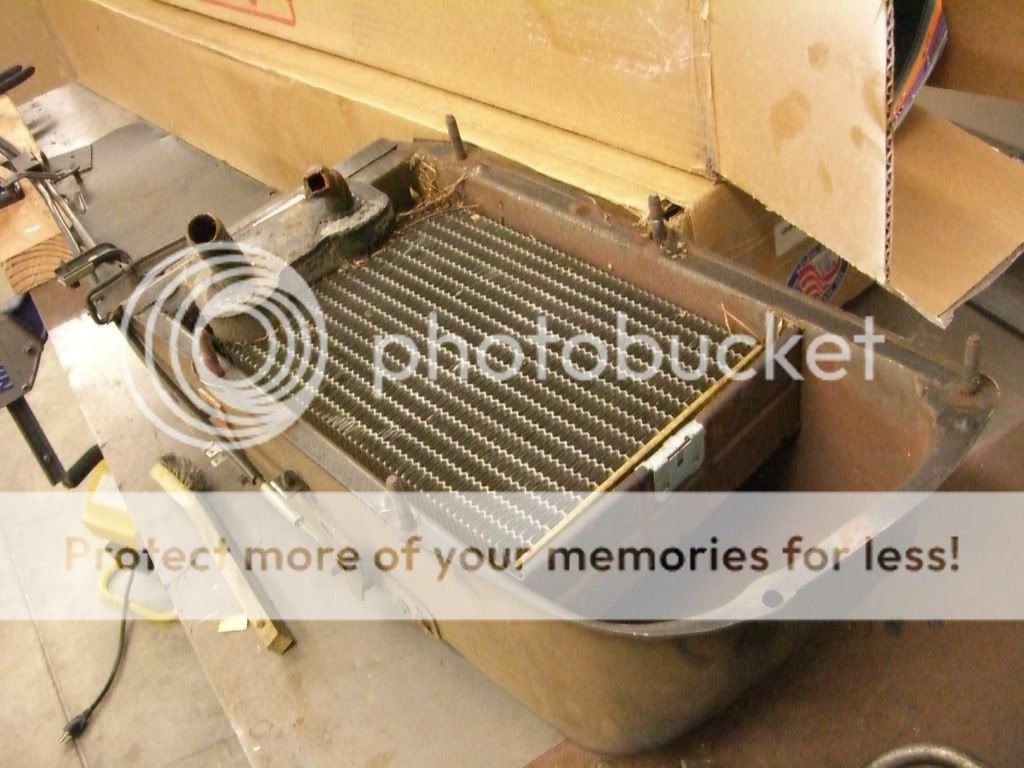

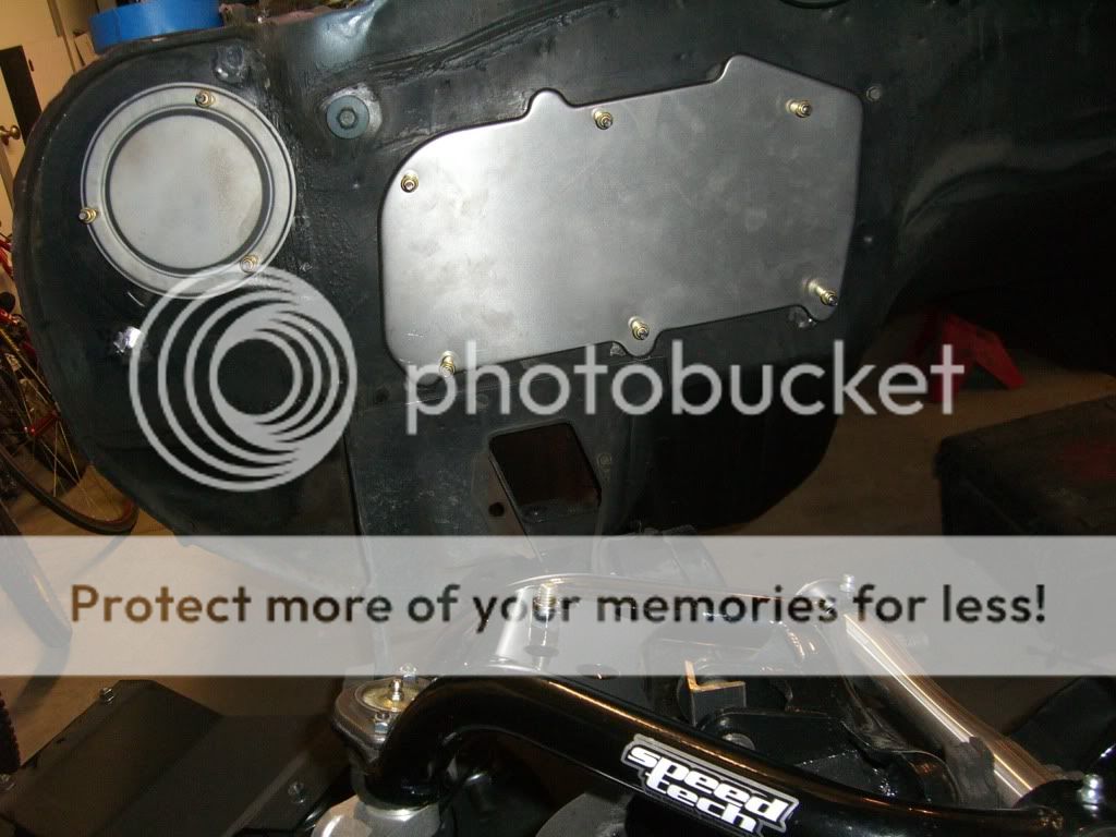

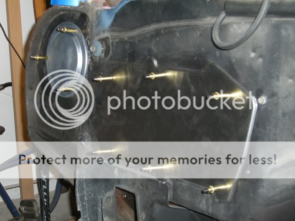

Holy schnikey work has been busy. Haven't had a day off in close to three weeks and thus haven't had much time to work on the car lately but found myself with a couple of free hours tonight. So I decided to remove a big heavy thing from the car:
The heater core. Lead, brass, ugly and GONE!
But.....a big gaping hole. A number of different things I could do here. I could buy one of those DSE panels and pay quite a lot for what in reality is a simple hunk of steel with a bevel rolled on the edge.....nah! I could do the street-rod-esque firewall smoothing bit......nah!
Which begs the question; "What Would Smokey Do?"

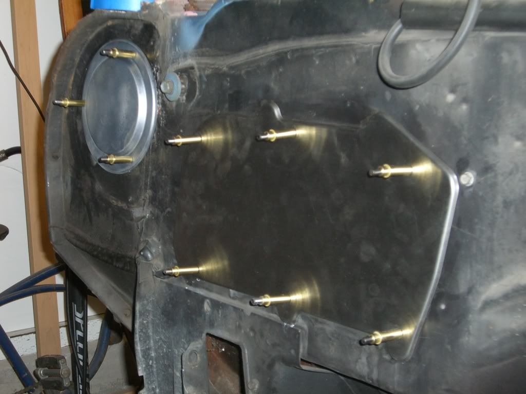

Well.....I'd like to think Smokey would have just tossed the factory delete plate on the hole and moved on. I went a tad further than just that, by welding up the mounting holes from the OE heater core, and welding in a fill plate in the original hole. Then drilled and cleco'd in the panels to check the fit. Took me just shy of two hours.
I'll finish it up with seam sealer and rivets after I paint the firewall. Of course that won't happen till the cage is finished.
There will be a heat/def unit of course. Vintage Air makes this nifty little heat only (no AC) unit.
http://good-times.webshots.com/photo...65608932BKChyx
Yes.......I am avoiding climbing under the car and removing the undercoating.
