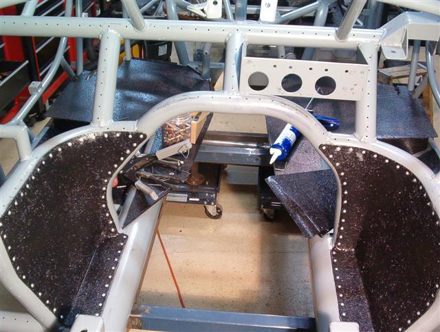

Hey, I coated the aluminum for the car this weekend. What a messy operation. I used a water based truck bed liner, It seems to have worked quite well, we'll see how it holds up. It dried hard not rubbery like some of the others I've used before.
I've a huge mess to clean up so, gotta go.
Patrick

Well picked up after the coating thing. I couldn't wait to get started riveting the panels in place just thought I would share this with you because these are the first permanent things I have assembled to the car.
I will post more pics when they're all on.

when you mount the aluminum panels, do you set them in a PU sealer as well as rivet them??
