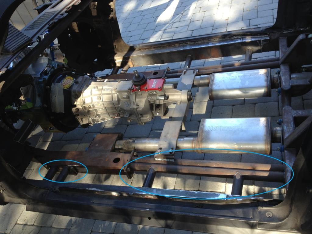

Need some of you guys to let me know your thoughts on this plan to mount the body to the frame.
First we'll replace the bolt in subframe connectors that Chad made with something more substancial and made of the same tubing as the front and rear clips.
The front factory frame bolt locations will still be used. In place of the front frame floor pan bolts, we'll keep the setup already installed by Chad which bolts the side of the frame rail to the rocker. This tie in is encircled within the small blue oval in the picture below. These were welded to the metal plate that was installed along the length of the rocker.

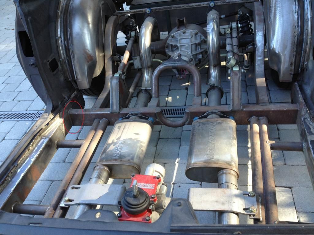

Then we'll cut the frame loose from the body in the only other point it is welded in, which is where the cross member hits the rockers. See area circled in red in the picture blow.
I'll put plates on the ends of the frame crossmember and matching plates in the rockers and have it bolt in there.
Then we'll cut the fuel cell "cage" that was fabricated loose and move it forward a few inches in order to trim the rear frame rails to the proper length and move the cross rail back so it can sit behind the tail panel without interfering with the bumper mounts as it does now.
Once these are located properly, I'll put end plates in place with bolt holes that will allow the endplates, body and bumper supports to all be held together with the same 4 bolts on each side.
