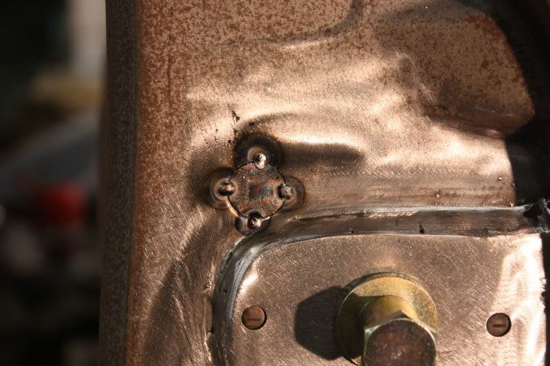

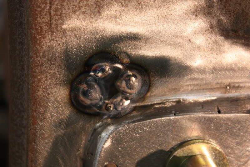

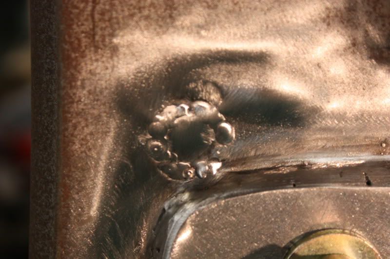

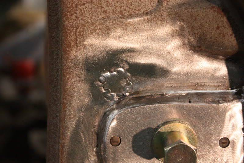

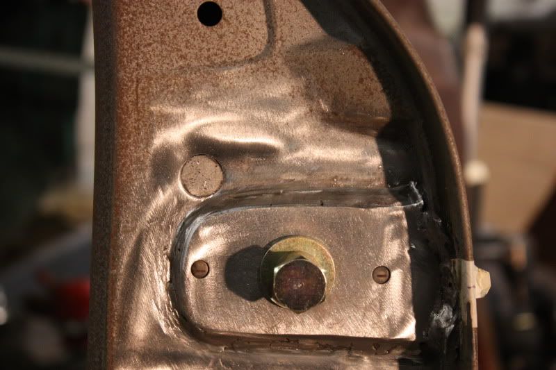

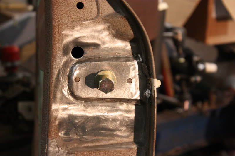

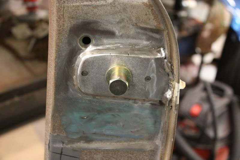

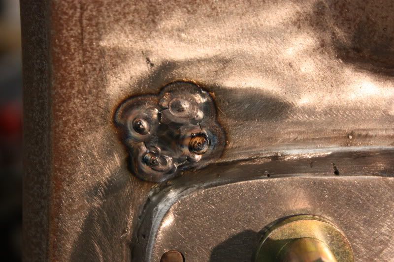

Well, here we go. Just did this tonight. This was all using the TIG machine. Now take this for what it is worth, I have only burned about 6 filler rods with this thing. Oh, sorry for so many pics, I wanted to show every step. I am putting Bear Claw latches in the truck. This is just an example of filling one bolt hole, but illustrates the process ok I think.
This is the back side of that hole inside the door.
So let me have it, what looks right and what looks wrong? I have a lot of welding to do! Thanks for any input.

Oh........ I think we have a new member of "TIGS R US"....
Once you go TIG you find it harder and harder to pick up the squeeze machine.
Remember -- ALL welding... rule #1 if at all possible.... CLEAN CLEAN CLEAN metal... and even cleaner for TIG. MIG lets you get away with murder... TIG will kick your butt on dirty stuff.

Chad, your's looks like a real project! I can sure see the benefits of TIG in this situation, thorough penetration and less material deposited on the top side of the work. Doesn't look too bad to my unexperienced eye, only thing I would question based on Greg's (Mr Clean) statements is in the last photo, the backside of the door material could have been sanded clean.......??

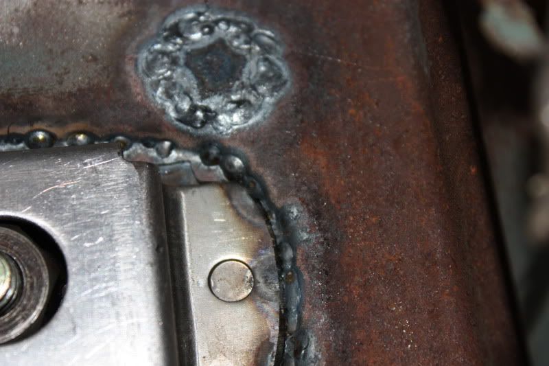

OK, here's tonights MIG 101 attempt:
Penetration appears a little lite in areas, but close?
Or........should I take two weeks off then buy a Thermal Arc 185 or Miller 180? Reality is I need a RS600 more than a TIG right now.
