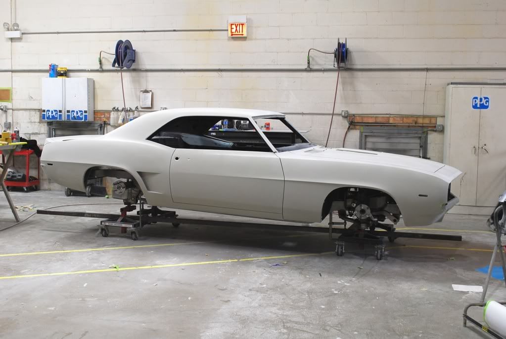

Here is a 69 Camaro that we started a few months back for a local customer. He brought in a driver quality car and wanted to really take it to the next level. Unhappy with the ride, the power, the interior, or exterior, the plan was for a complete overhaul to bring the car up to today's standards. Not a full blown track car, but something that he could drive across country comfortably and still be in contention at local auto-X events.
Still in the planning phase on a lot of things, but here are the basics to get started.

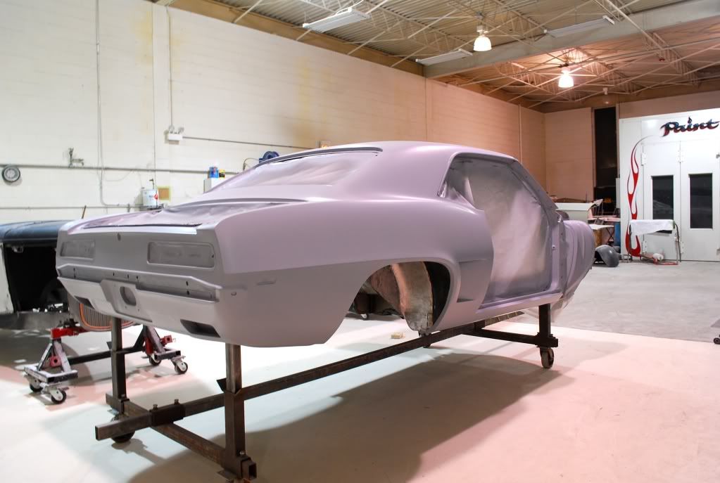

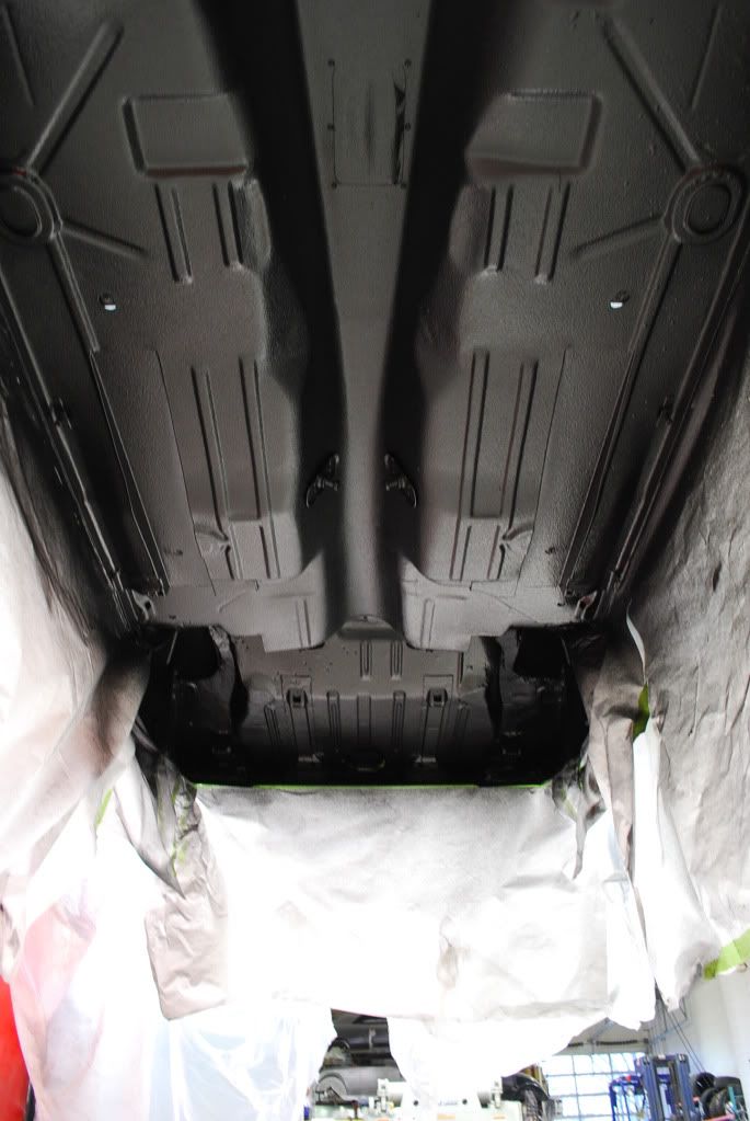

The body ended up in worse condition than we had originally thought. It was not horrible, but not great. Some one had patched the floors and did a custom quarter panel installation on both sides. The doors and fenders had some previous work as well. The car now needed floors, quarters, door skins, and lower fenders.
The body was then squared and fixtured and the panel repair began.
Floor and firewall were cut out to begin repairs.

The chassis was built while we were waiting for parts to come in.
New center crossmember design that will be used on all production chassis.
New mid and side braces added in to the chassis to increase rigidity as well as add detail.
