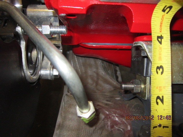

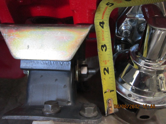

Anyone out there with a SBC, can I get a measurement from you all please?
I need to know how tall your engine pedestal with the motor mount is. Measure from the frame itself to the mounting pad on the motor. Also, tell me what stands and mounts you are using please. Thanks!
I'm showing mine driver's side and passenger side respectively.
I am using 69 Camaro GM 302/350 engine pedestals along with Prothane tall poly mounts.
Also, if you happen to have a DSE steering box, could you possibly measure the distance from the box to the head. I listed a picture showing the measurement I'm getting.
Thanks again everyone!
