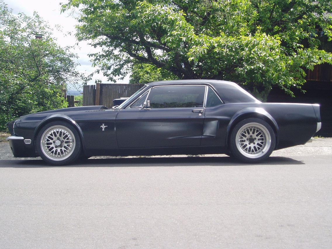

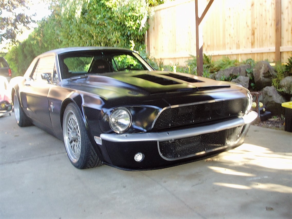

God I am the worst photographer ever !
If you read above I was thinking about bobbing the rear end, and I did. When I started in on it I was pissed at myself for starting another idiotic time consuming project but it actually came out great and looks much better I think.
I really like the simplicity of the rear end now, although I no longer have back up lights. At some point maybe I will hide some LED's somewhere or whatever. And even though I just said I like the simplicity, I have some urge to put the
M U S T A N G
letters on the trunk like at some point.
It also mimics the original Mustang rear valence and appearance much better than before, if you remember I've been striving for something that looks "vintage" but super built.
The other thing that really got me excited was getting all the window chrome back on and the running horse emblems. Really makes everything look much better especially in primer black. And the other thing I really liked was emulating the front nose chrome of the Shelby Mustang. I actually hand built the trim out of aluminum and had it chromed. It came out really really nice, even I was surprised. Of course it cost almost $500 to chrome the 4 small strips of aluminum and took 8 weeks but I had it done at Queen City plating which does cars for Pebble Beach and stuff. The quality is superb, especially considering I hand built it out of 1/2" key stock aluminum bar.
