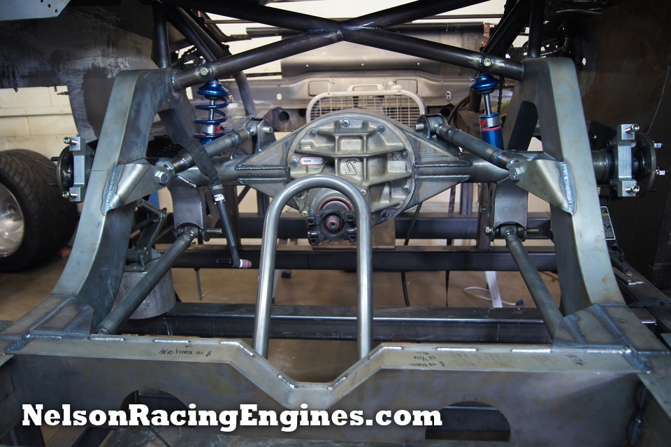

Default More rear suspension
Okay here's some more rear suspension shots how we boxed it all making a rear shaft loop ,double shearing coil over mounts etc

Default Centering drive train
One thing i wanted to show you guys is there have been many builds I've done in the past that the drivetrain that are not centered and when you look at the engine bay head on you can see the engine is not in there center which bugged me .The Chrysler was pretty bad and trying to keep the Symmetrical theme I decided we needed to center the entire drivetrain on this build here are some pics of us cutting up the rear end and weld up in our Mark Williams fixture.

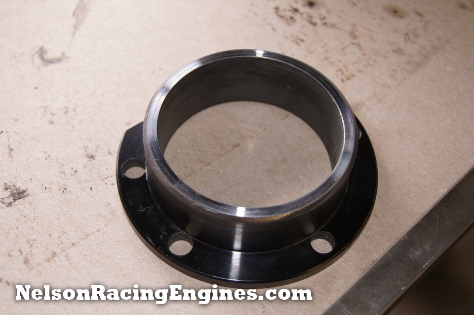

Posts: 85
Default Trick threw the frame sway bar
Since the tires are so wide I wanted to maximize the sway bar length so I decided run the sway bar threw the frame and make the sway bar run on roller bearings.

Slick sway bar mount, did you get a new fab guy?
Actually Chryslers had the stupid offset to clear the power steering box. Lazy bums. LOL
