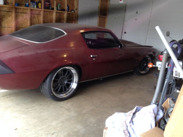

I've been on the board for a while now and met a few of the guys on the board, even some with cars that actually work , but never really posted too much about my ride. I've got a 72 Camaro that I use as a driver and have been learning on the Autocross and Road courses. I'm not an idiot with cars but I am not a pro fabricator, welders, or body man. I'm just a normal guy teaching myself as I go along. The car has a 377 SBC I built with a forged bottom end, some 195cc heads, a nice solid flat tappet and a TB fuel injection. Trans is a T56 Mag with a mechanical linkage and Quicktime bell. Brakes are C5 front and LS rear. Hotchkis rear leafs, QA1 rear shocks, QA1 front coil overs, tubular UCA, boxed factory LCA with delrin bushings and DSE subframe connectors. Most of the car was build from used parts where possible because I can't afford all the crazy billet stuff I would love. I'm a bit more into function over beauty but try to balance as best I can. It makes decent power but nothing too crazy. It has run a 12.6 @ 113 at the strip with a miserable 2.3 sec 60 ft. I have also passed some BMW's and Vettes on occasion at T- hill and TWS. All in all a good street car that is fun because most of the time it's actually running.
An issue has come around that I baked the rear axle at texas World Speedway the other week and decided I needed to change the suspension setup. It was 106 outside which along with the large front stretch and a gear setup that was not spot on I ended up with the axle howling at me @ ~110mph. I limped it around for the day and concentrated on hitting lines on the turns more and did learn alot. When I got home I decided it was time to order some new parts because the factory 10 bolt was really starting to scare me anyways.....
I called but Speedtech and talked with Roger for a while to formulate a plan. I decided to get the TA rear kit with Ridetech Single Adj. I also picked up Ridetech coil overs for the front with their Chicane kit so the car would be more balanced. For an axle I decided a full floater from Speedway was not much more than a standard 9". Speedway was also able to install all the Speedtech mounts and any brake mounts I needed so it was a 1 stop shop. Mike at Wilwood helped my with the new rear brakes based on a lot of feedback using Brian's Camaro as an example. I ended up with some 4 piston dynapros, 12.19" rotors and their new MC4 parking brake setup. Later I'll update the front brakes but for now I have to focus on installing all of this stuff.
I'll work to detail out the install in the coming days/weeks. It should be an interesting install. I used to have a nice 2 car garage but earlier this year I relocated from Sacramento to Austin. I now share a garage with some nice guys who play with some Harleys. I no longer have my roller box at the house. All I have are normal hand tools, a 4.5" grinder, drill, sawzall, jacks and jack stand and a 220v mig welder. I think this will be a real test on how a normal guy can do the install. I'm excited to see how it comes together and how different the car will be with the new setup.

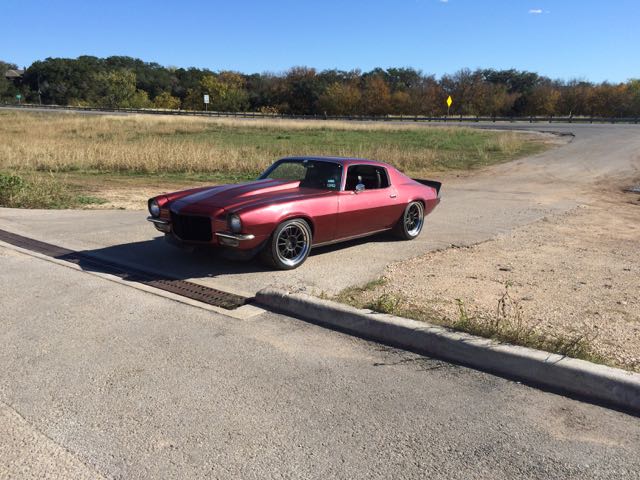

He's a pic of the car I'll work to post pics of the parts a bit later tonight.
Name:  TWS Camaro  2013-07-14 at 1.00.16 PM.jpg

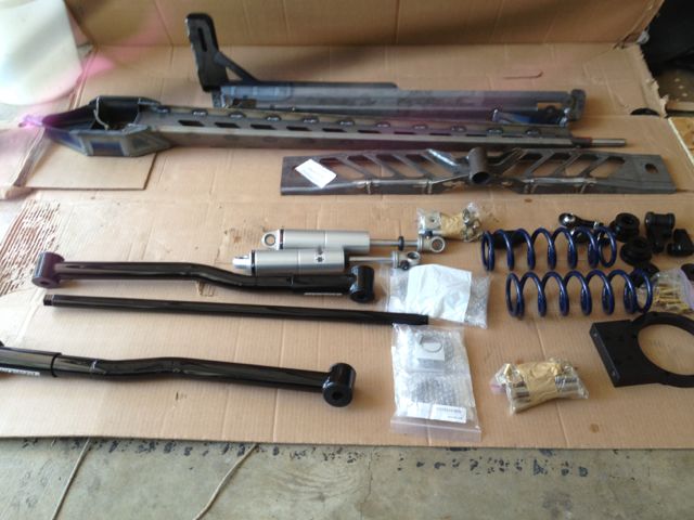

Here are some pics of the parts.
TA kit

Ridetech Coilovers

Speedway housing
Size:  81.1 KBName:  IMG_1768.jpg
Size:  42.4 KBName:  IMG_1775.jpg
Brakes - I'll work on a better pic tonight
