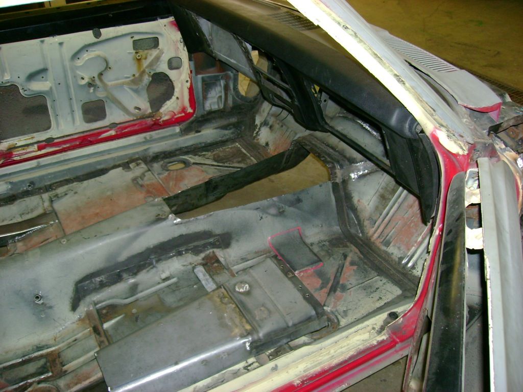

I don't have a great picture of what I did but I re used the top and just added to it where it was needed.

Thanks good to see how you did yours. The piece in front is really beat up on my car. It looks like every engine swap the transmission was smashed into the bottom of the floor and also a little clearance work with a big hammer. I saved it to do what you have done but I am not sure I can straighten it.

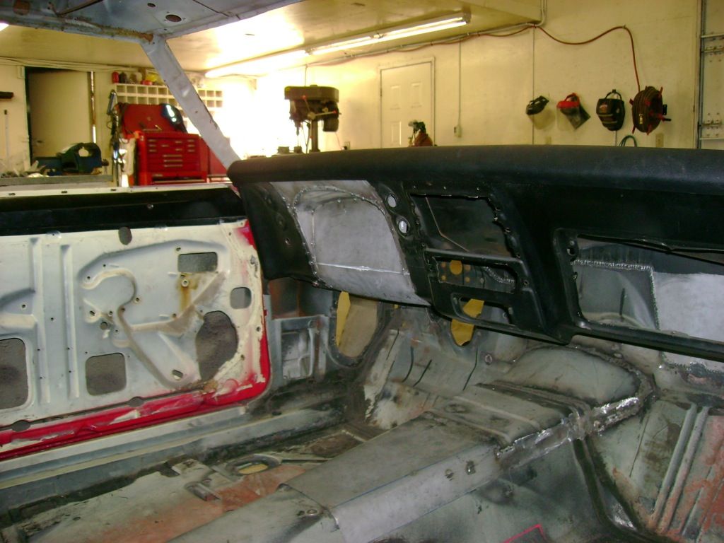

Just a short update. I didn’t have a lot of time this weekend but plugged away TIG welding the tunnel extension. I decided to use TIG so I could practice my hammer welding. It was worth the effort because I got better and faster as I went along. Also filled a couple holes and repaired the ragged edge that tore when I drilled out the spot welds incompletely.
I welded it as uniform as I could and then used the bench as an anvil to hammer if flat.
I cut the weld bead down with the edge of a cutoff wheel, hit it with a die grinder and 80 grit, then smoothed it a little with the DA sander and 80 grit. It is a little wavy but not too bad.
I need to work on my organization. I got the bench so messy I couldn’t work and had to stop and clean.
Then moved on to the ragged edge. I just chopped it out and trimmed in a new piece.
Overall it came out pretty good. Passenger side is better because I did it second. It will all be under carpet and the bottom side will smooth out with just a tiny bit of filler.
I still need to figure out what to do with the shifter. The extra two gears use up more room and hits the console insert in the 1-2 gate and also going into reverse on the other side.
I can countersink the fasteners but that isn’t going to be enough. It would be better if someone made a wider insert. Anyone know where to get one? Some of the shifters have a shorter attachment, but I know other people on this site have had leaking problems with aftermarket shifters, which makes me want to keep the Tremec if possible. If anyone has solved this I would like to see your stock console solution. It is probably easy and I am just missing something !!
