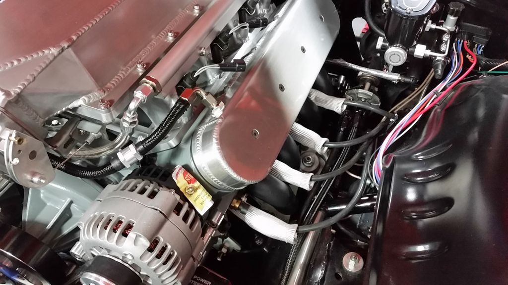

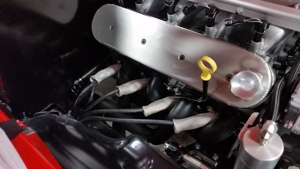

Spark plug wires and routing:

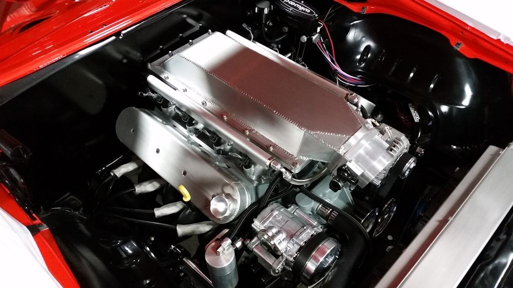

Engine bay is completed, except for the custom intake tube I have to build. Then wiring the entire car.

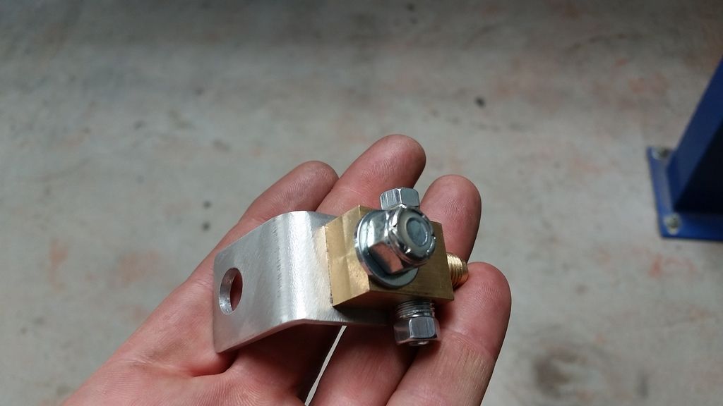

Finished out the entire rear brake lines. Had to build a couple aluminum brackets, since the ones on my car were missing. I saved $45 in repro brackets, and ended up with some nice aluminum ones instead
For floorpan:

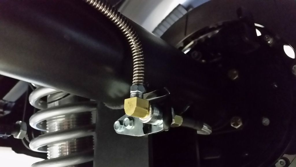

For top of 12-bolt axle:
Used DSE's braided steel flex line kit on top of the axle:
Used the SUR&R lines, and added stone guard spring for the entire rear lines.

My bulkhead connectors at that 90 are NPT threaded. So, I used these:
http://www.speedwaymotors.com/90-Deg...ing,28392.html
Gravel Guard Spring is part# RSD-GGS316S-20 on Summit Racing
