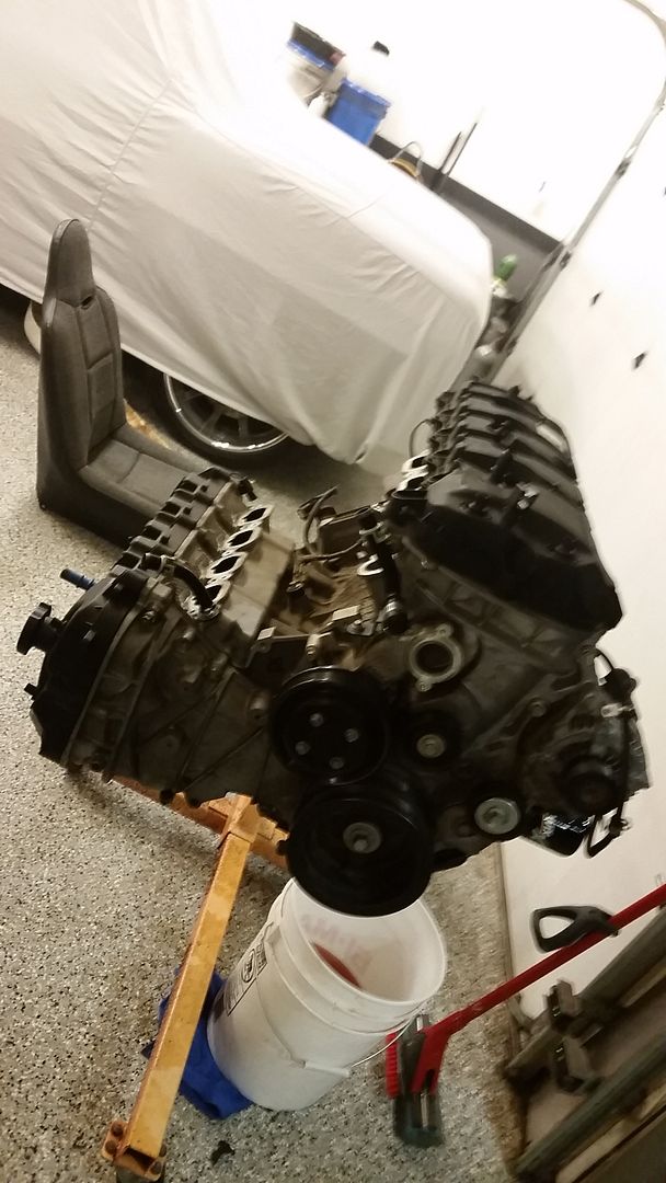

Starting to look like something. Coyote has a 6 speed manual attached to it at this point, motor and tranny are in for good, hydraulic pedal assembly is built from scratch and installed.

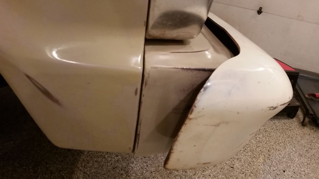

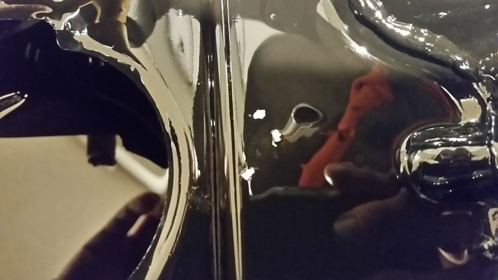

Spent a bunch of time on the sheet metal this weekend. Color sanded the passenger fender and got it fairly flat and hit it with the buffer.
