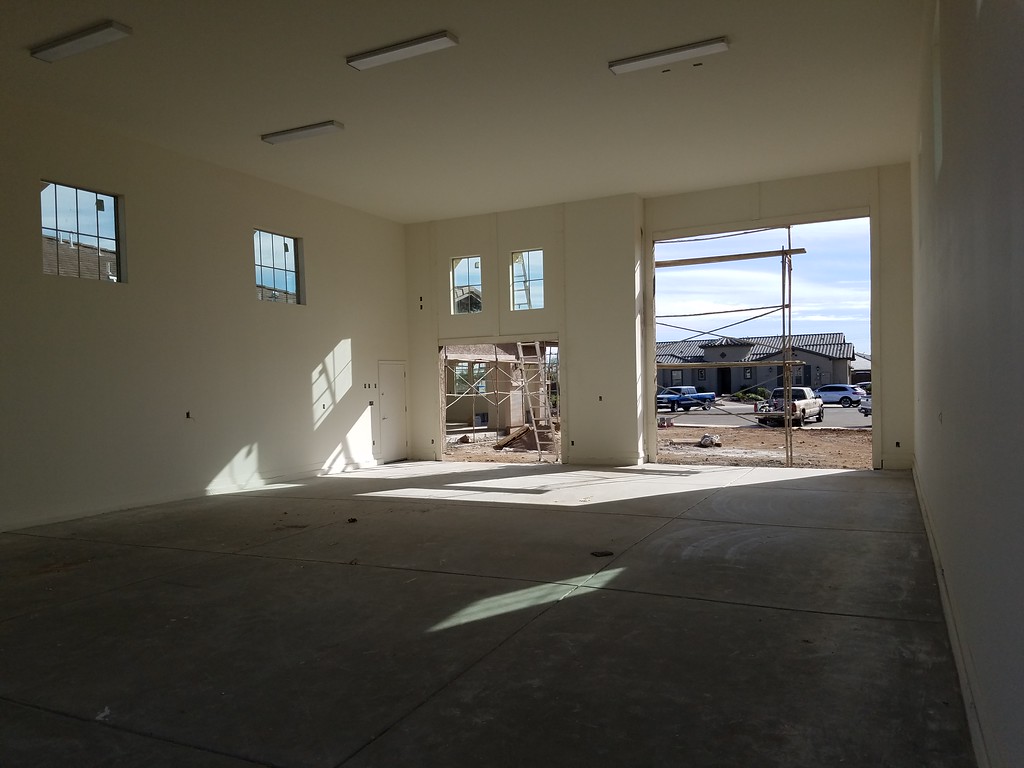

Are you installing the rear “optional” door? *EDIT* Don’t mind me, I’m medicated.
I’d figure out your mezzanine before you go any further.

Agree with Todd ---- just angle the loading end towards the door... will give you more working space anyway.
After having a couple shops --- all I will tell anyone -- what seems big - isn't..... LOL

All that space in front of the RV and lift looks like dead wasted space to me. I would put the lift (and RV) closer to the door.
Leveling the lift is simple, no need to worry about the crown of the floor.

The closer the lift gets to the door, the closer it has to be to the side wall. That and being able to put the things that have special electrical needs in that area close to the panel are good reasons to push it back.
You also have to remember, that box is the outside dimensions of an extra wide, extra long drive on lift.
It's not like what you are putting on the lift has to be completely straight before driving on.
I agree that angling the drive on end toward door may be necessary but thankfully it comes with a set of caster wheels just in case.
I'm thinking now about putting a set of stairs on the back wall going up over the water heater to above the bathroom and if that fits...building a mezzanine out over where my desk is to about the front of where the lift is. The stairs up are the hard thing to find room for.
And yes...they are NEVER big enough...but this will have to do.
Lance

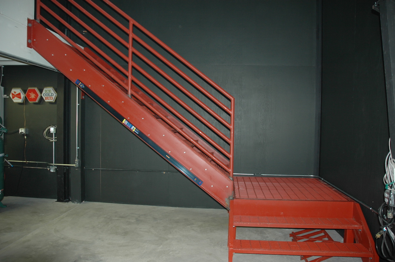

They take the same amount of room -- since the lower floor area needs to be clear to accept the stairs....
I'd prefer a "closet" space / storage space under the stairs for a compressor or other "things" such as that.
My stairs in the old shop went up a couple steps - had a landing and made a turn ---- it's were I stored spare motors - 55 gallon drums of spare metal "sticks" - and I built a rack for new metal -- longest pieces to shortest following the stair slope. My compressor was also under there although at the height of the slop - these were also EXTRA SIDE stairs in case I wanted to turn the area in to storage vs a space for chairs and TV and drums etc.
Not trying to say what you should do -- just giving "food for thought" on some options.
https://lateral-g.net/forums/attachme...1&d=1516727034
