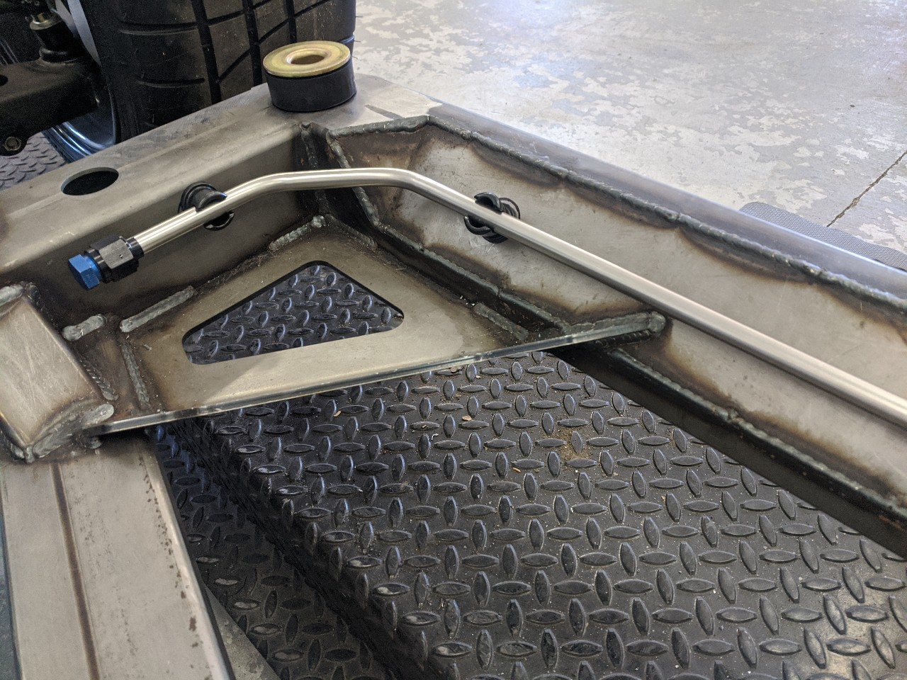

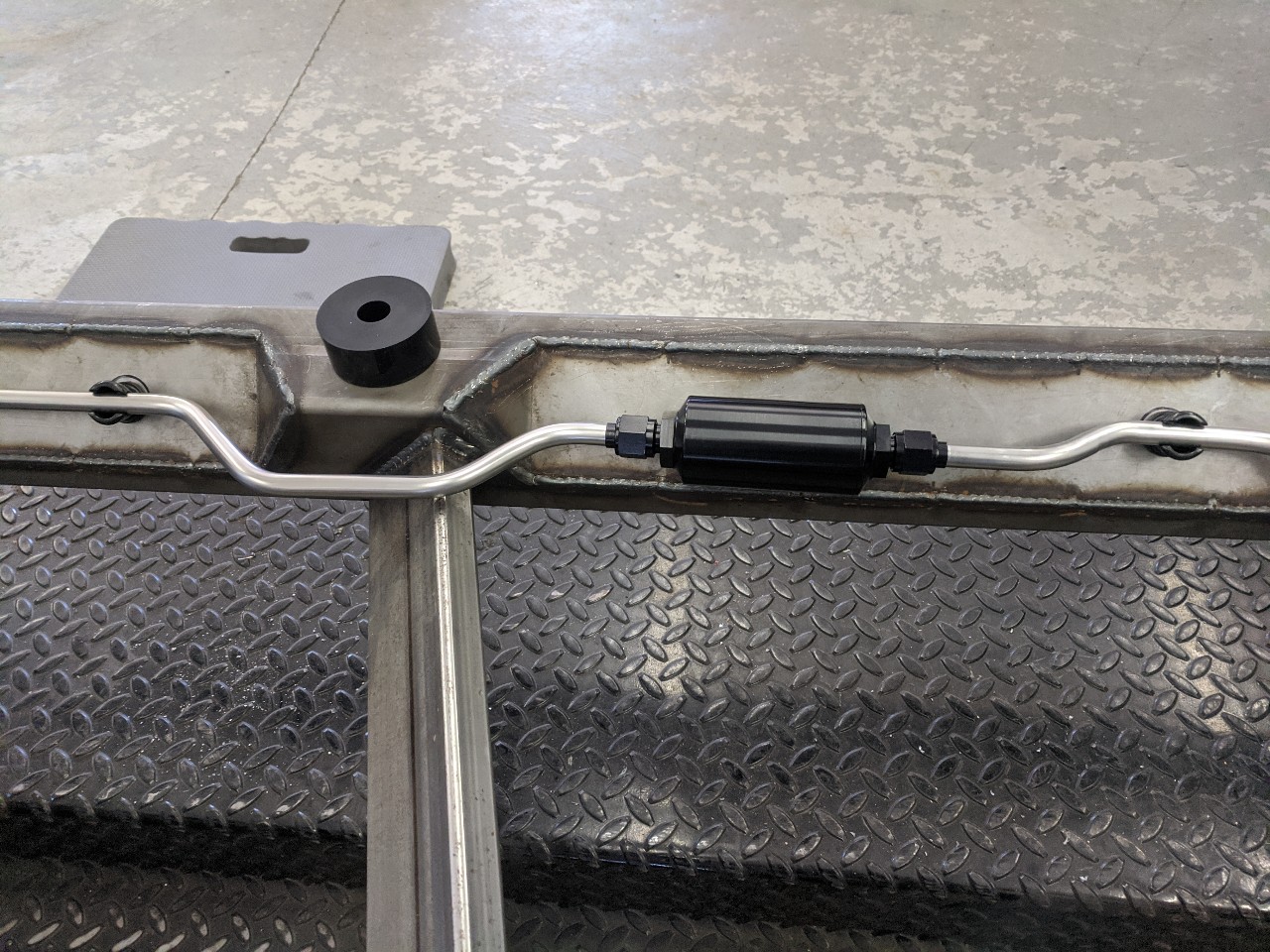

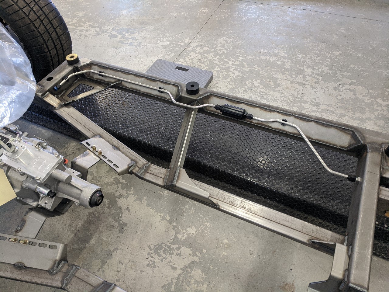

Borrowed a buddies filter so I could finish mocking up the 1/2" hard lines.

Those frame standoffs holding the lines are very cool!

I used the NotcHead line clamps as well. Looks great.

Had extra tubing and the bender and flare tools are still out, so I decided to do the front and rear fuel rails.
Jody,
One thing to keep in mind is that those hard 90 degree fittings really hamper flow. Each one of those fittings is the equivalent of adding 12 feet of hose to the fuel system.

Great point Andrew. That's probably why I still had those new ones sitting in a drawer for several years lol. I think these came with something else I bought many years ago. Just used them for mockup. I hate forged 90's, super restrictive. I have mandrel bent ones on order, still showing backordered.
