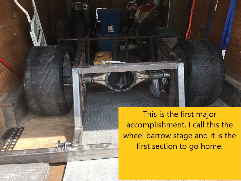

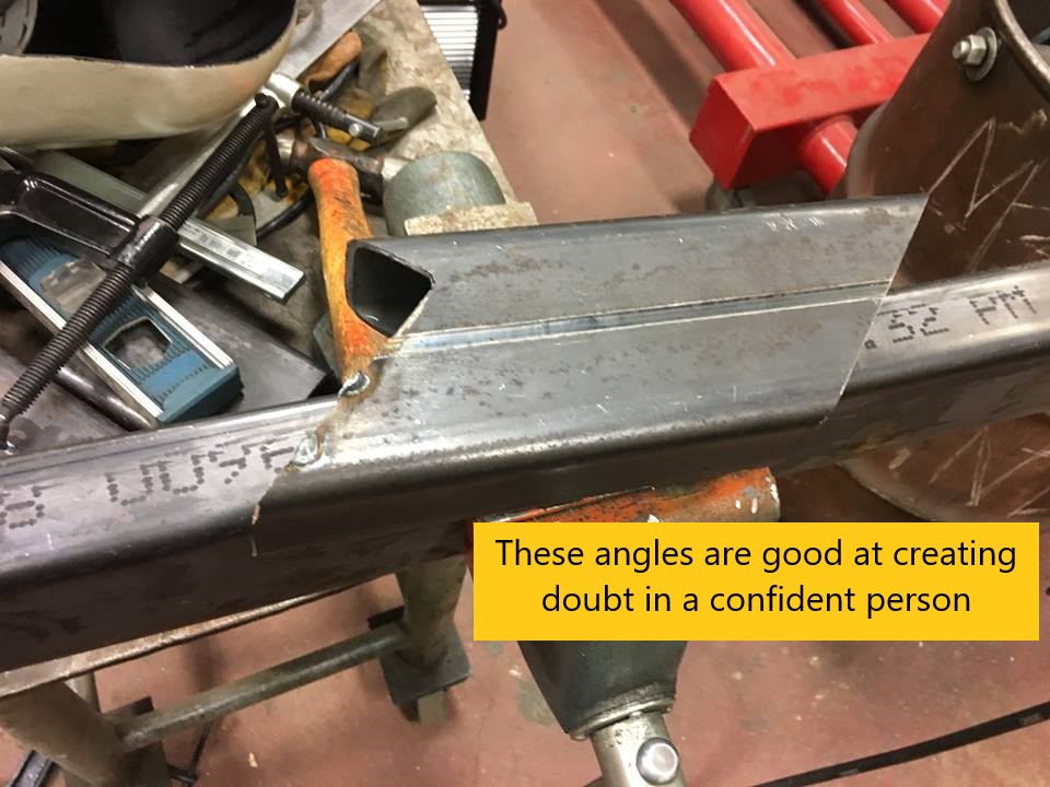

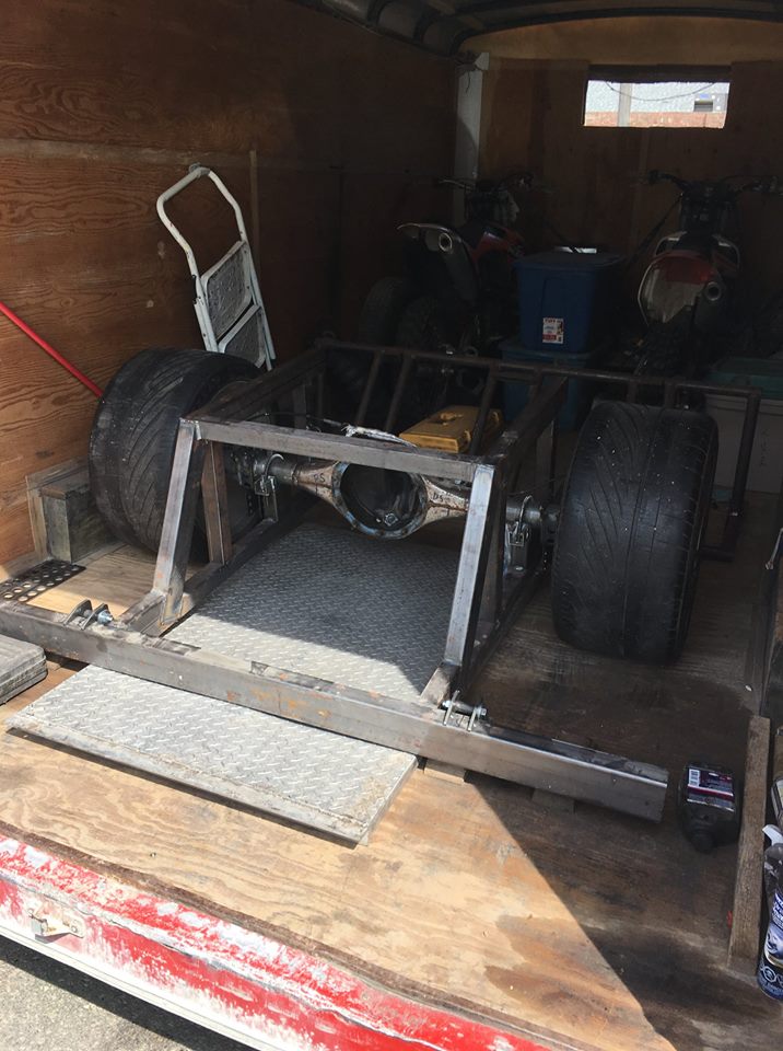

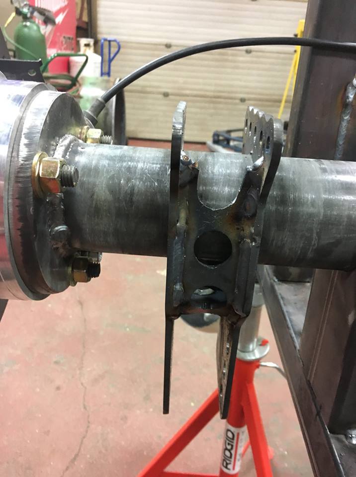

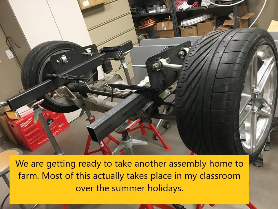

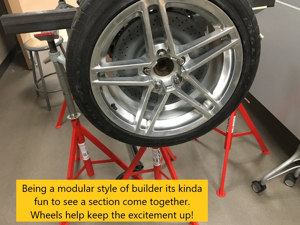

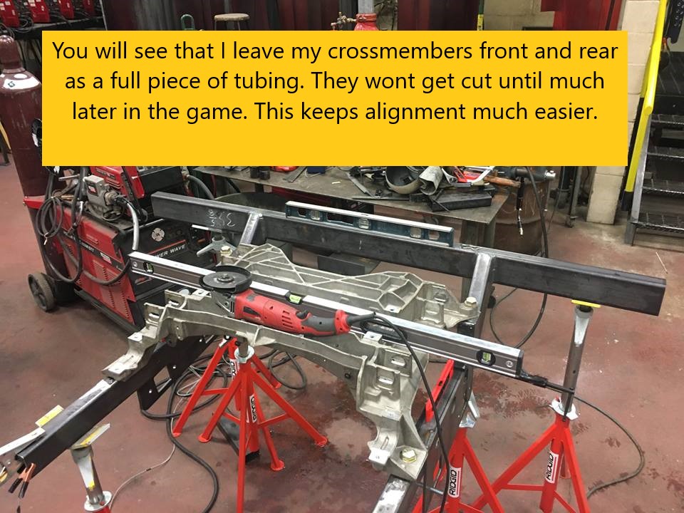

38 It’s time for this assembly to head home. I teach at my union hall for the 7Oaks SD., and when I am off the clock I will use the shop occasionally. A big thank you to Local 254 Plumbers and Pipefitters hall. Remember Unions built our middle class and that’s why they try to destroy them. Buy union and support those workers.
I described this piece as a big clumsy wheelbarrow.
The sharp eyed amongst you will notice the dirt bikes at the front of the trailer. Another passion of mine. I call it the methadone that tempers my desire to race sprint cars.
You can also see that I have tacked the front lower link brackets to the rear cross member. That cross member of course is at random length to be cut down later. The future holds more mods to this assembly for stuff that I never anticipated. Let’s see if you catch that in the future, LOL.

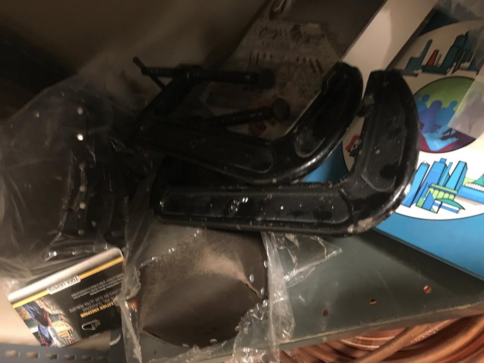

More pics.

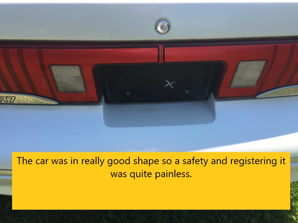

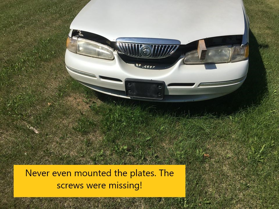

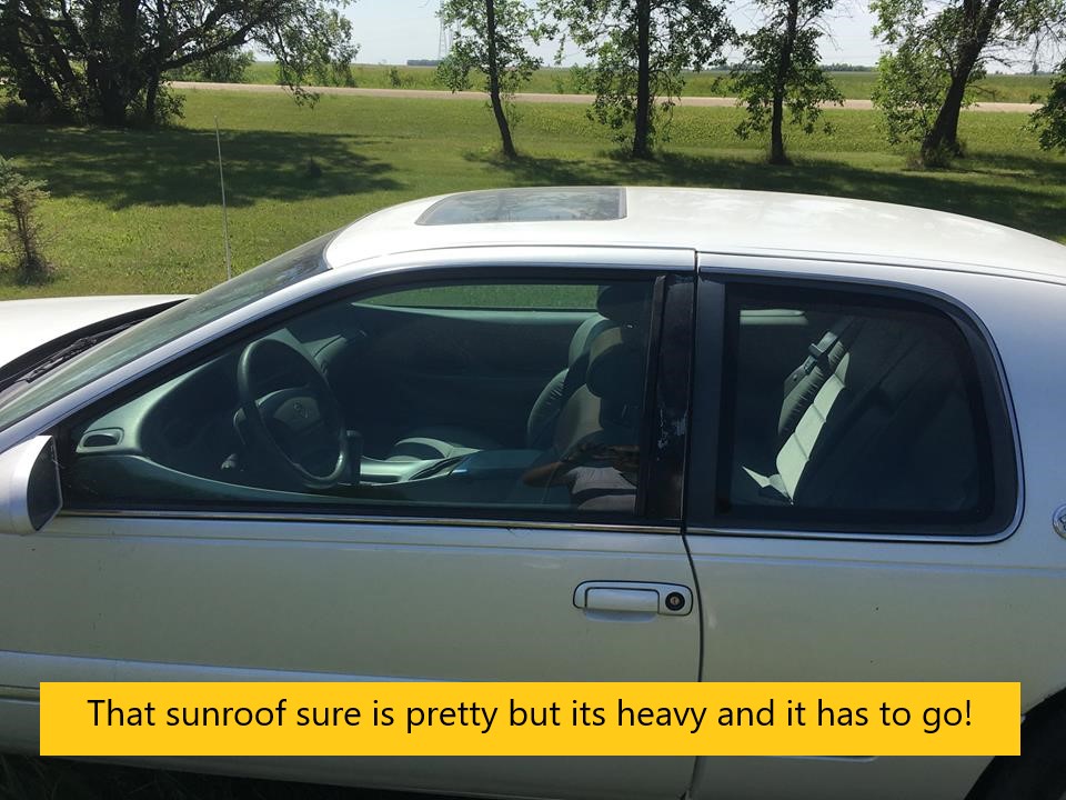

40 While there is not a lot to see here it is quite important. The car was inspected and safetied. I also got it licensed so it is officially mine now. This car was actually a good candidate for an old man to drive it into retirement. Well seeing as I am also nearing 60 that seems appropriate doesn’t it?

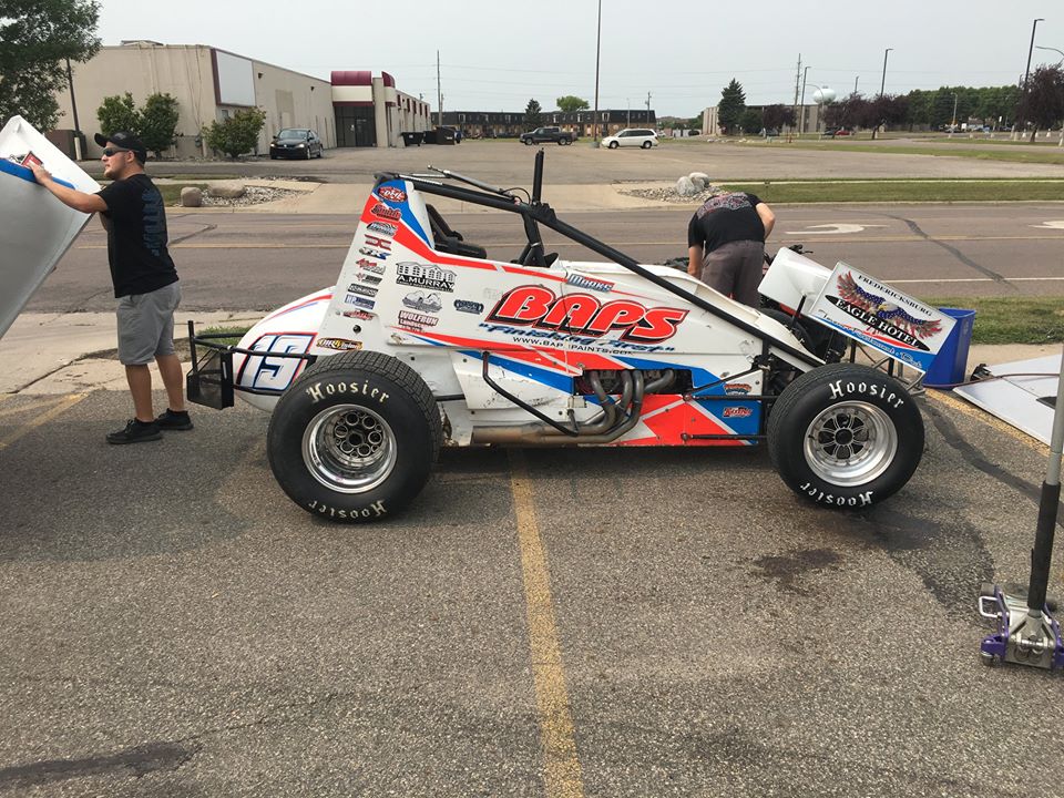

Sometimes I just need a break.
The World of Outlaw sprint cars make their way up to North Dakota and it gives me a thrill to see them. While I have raced with them in the past I never made any sort of mark with them. Heck I didn’t make any sort of mark locally either!

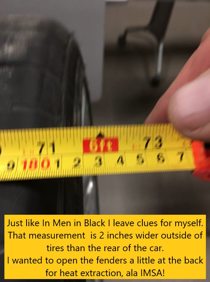

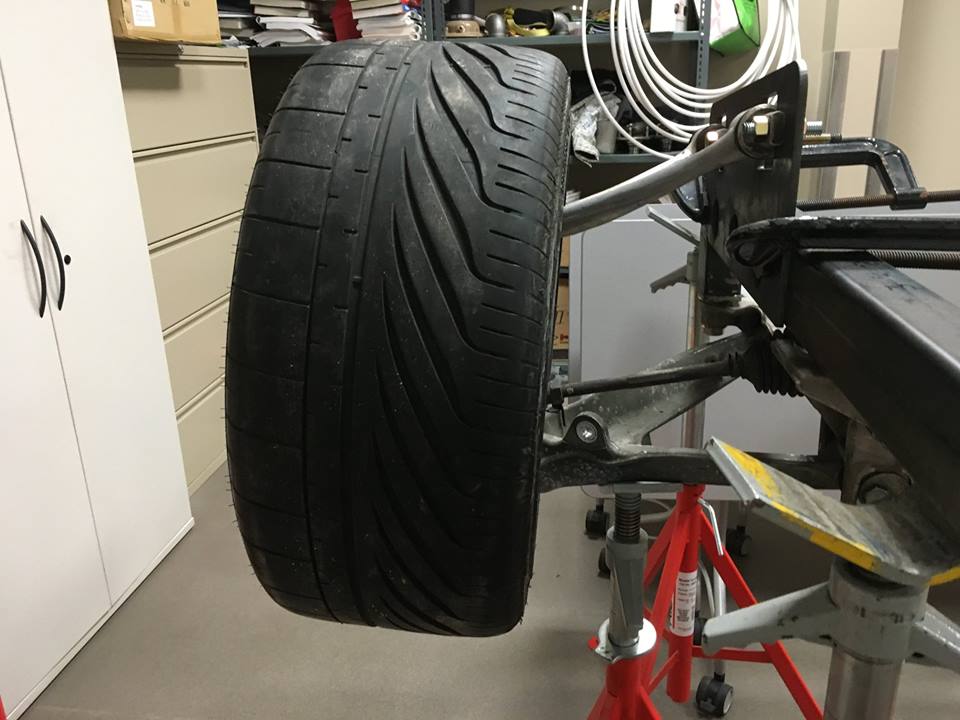

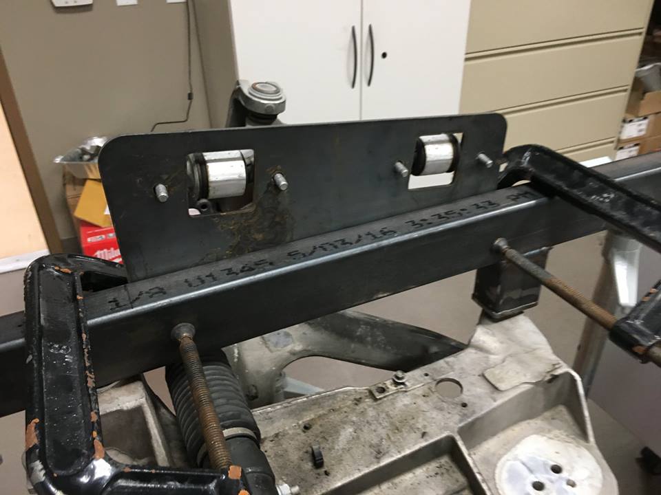

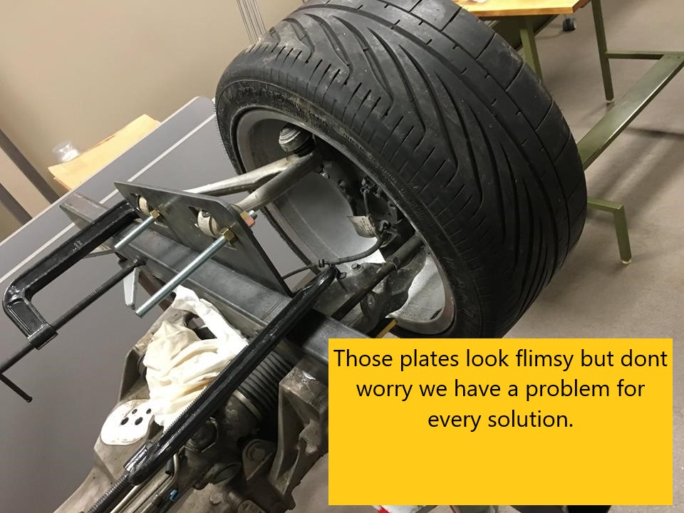

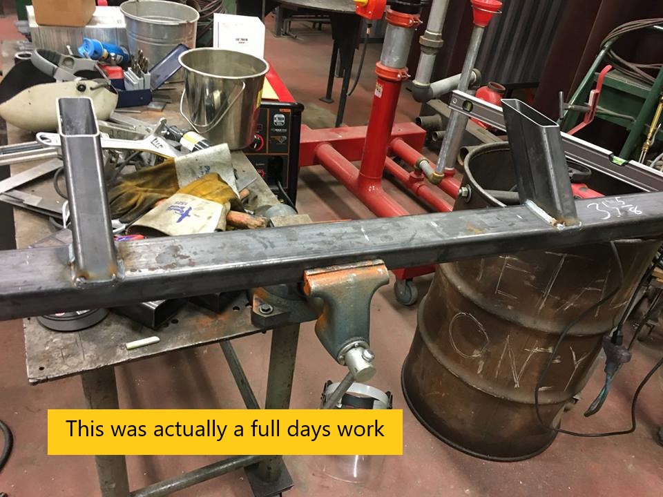

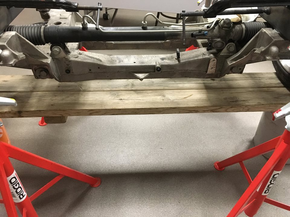

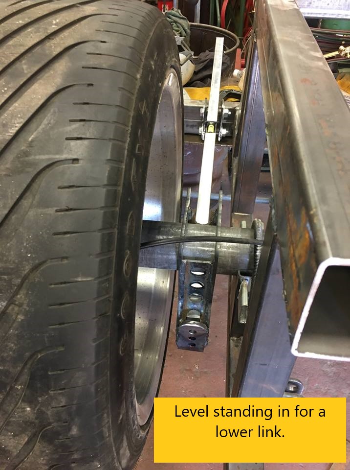

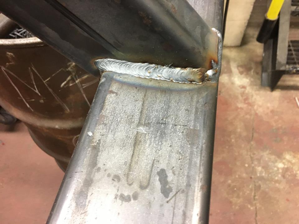

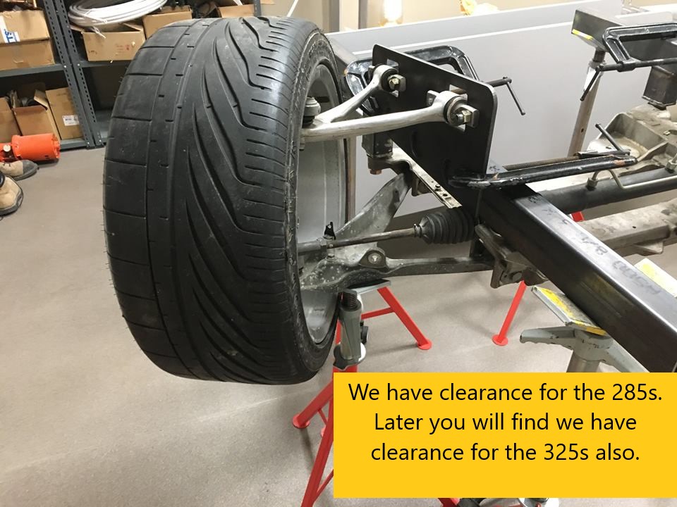

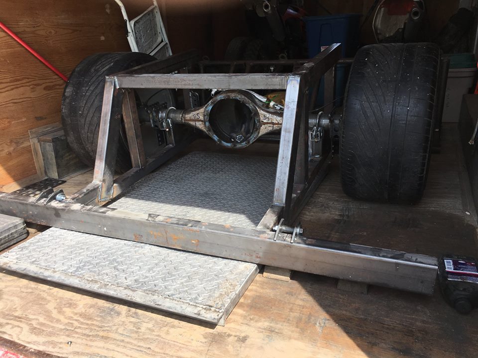

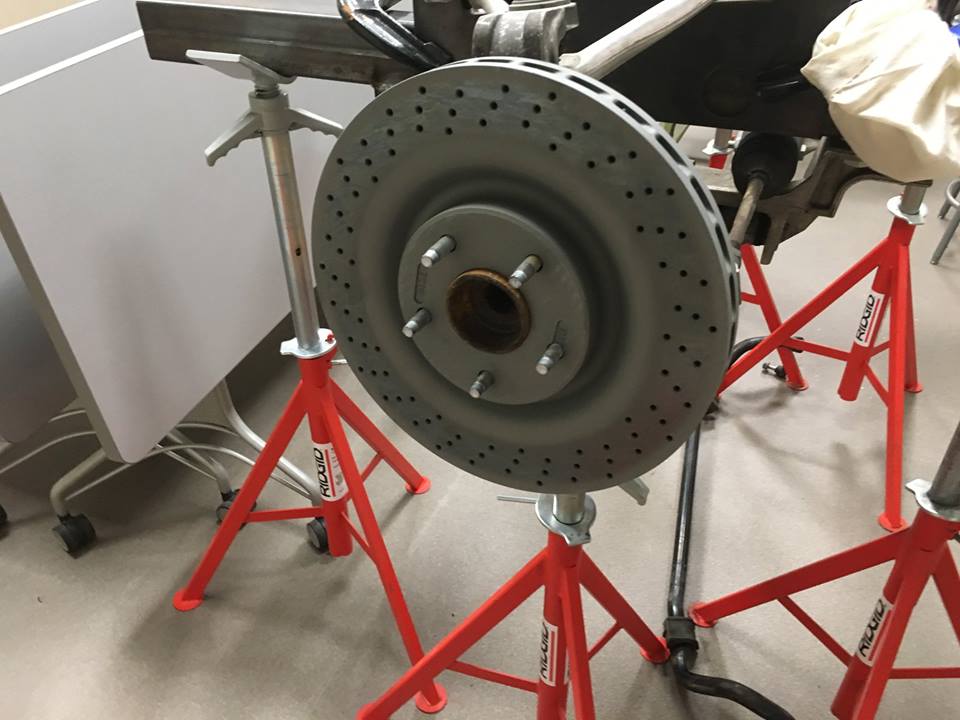

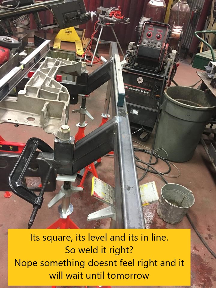

After a little racing break we needed to get back at the front end. That measurement of 71-1/2 is 2 inches wider than the stock rear-end width. I had planned for the front to be slightly wider than the rear so I could mildly IMSA the front fenders for heat release. Of course I maybe can’t leave that alone and maybe I will see if I can run 325s on the front also?

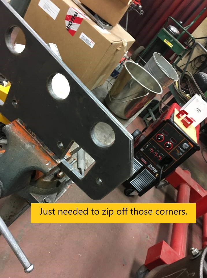

The plates for the upper control arms are clamped in place and needed a small trim to fit.
I actually left some really nice welds behind on this frame section.
https://lateral-g.net/forums/attachm...1&d=1618622591

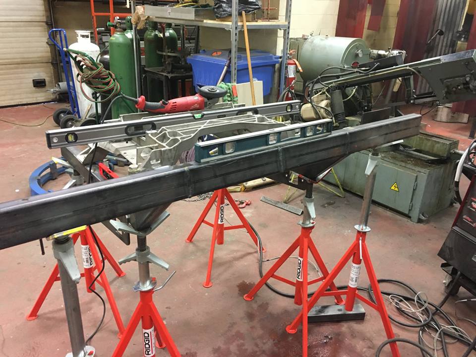

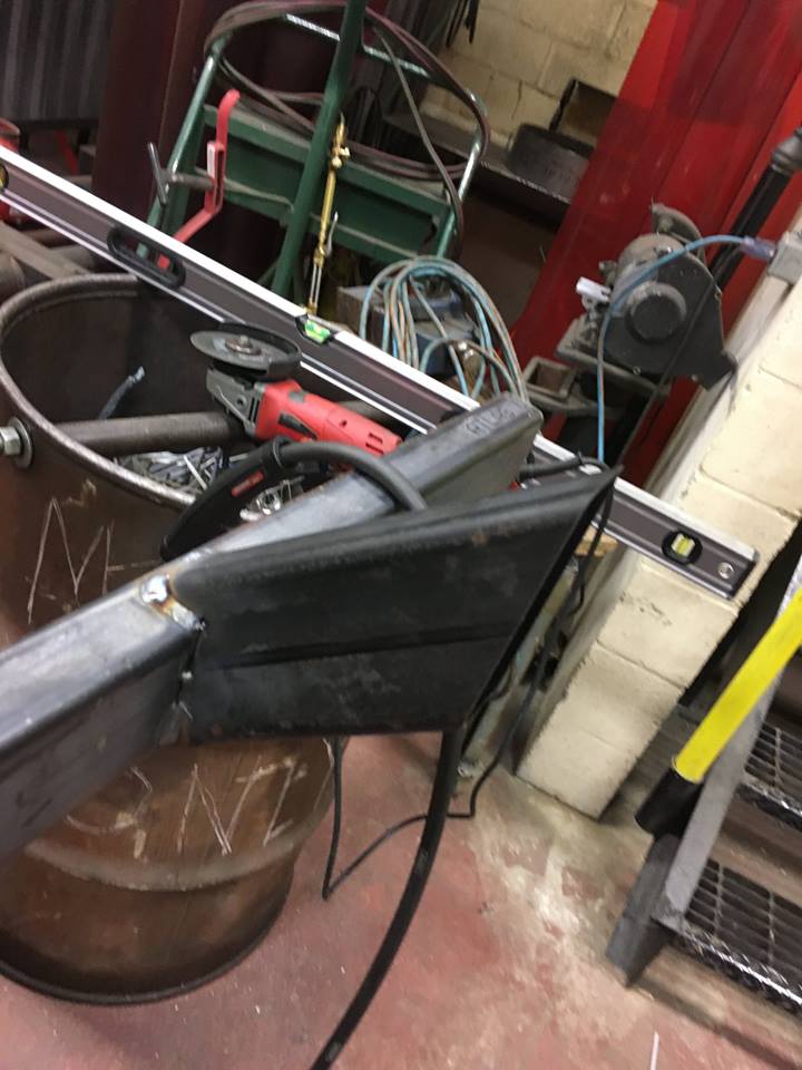

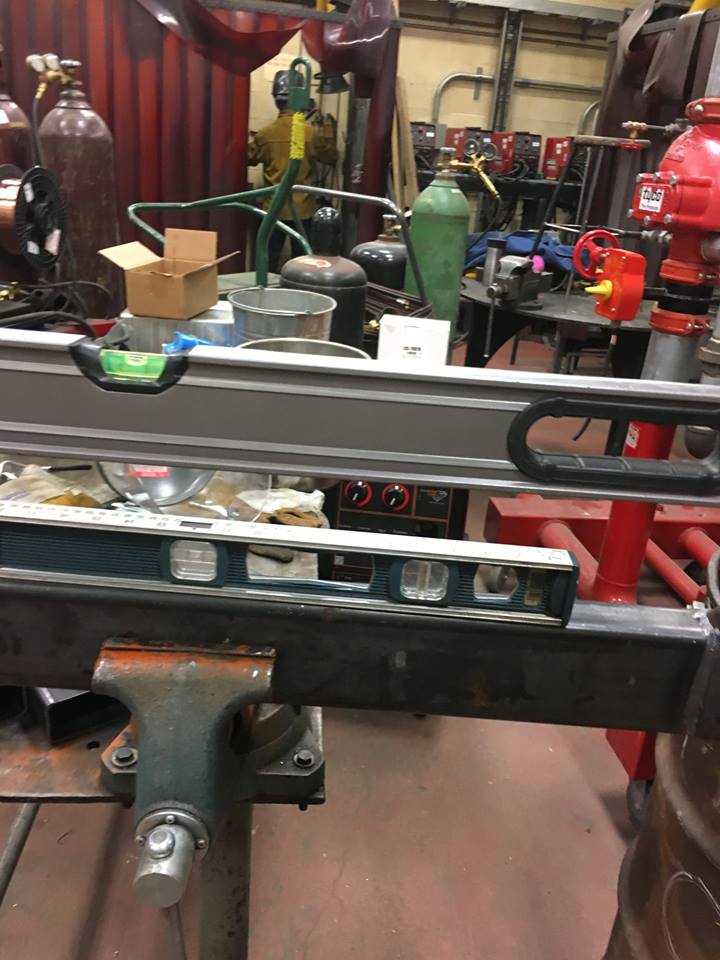

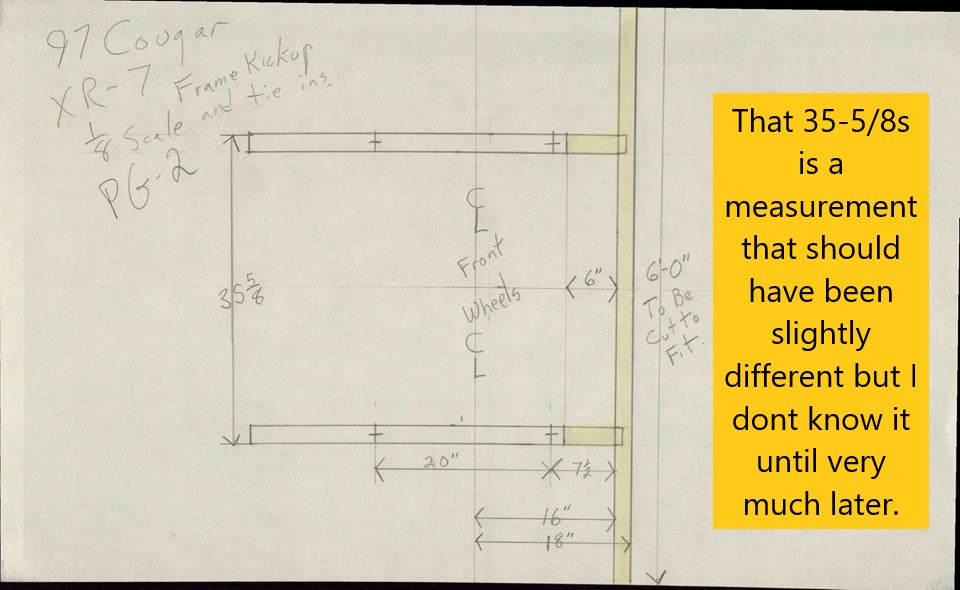

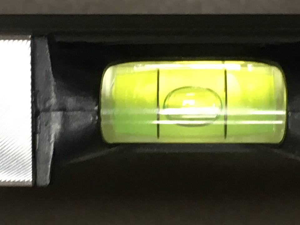

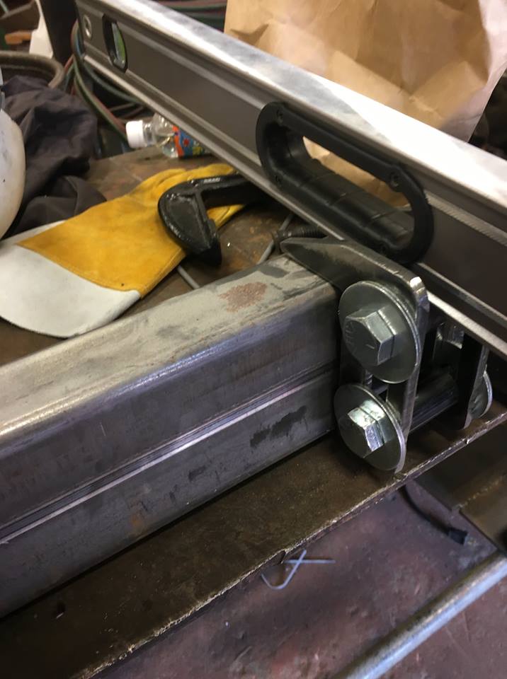

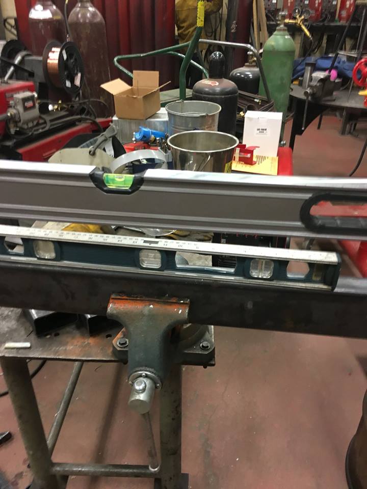

That little bubble on the level is everything to me. The frame kick ups are very precise fitting and I agonized about them for hours. The drawing doesn’t do them justice for the amount of time put into them.
And you know, I didn’t finish them because I wasn’t comfortable with what I had done. Don’t rush a project just so you can do it over. That’s the best advice I can give a builder right there.

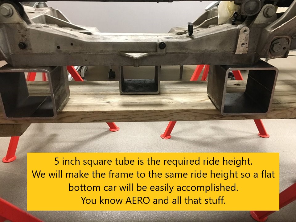

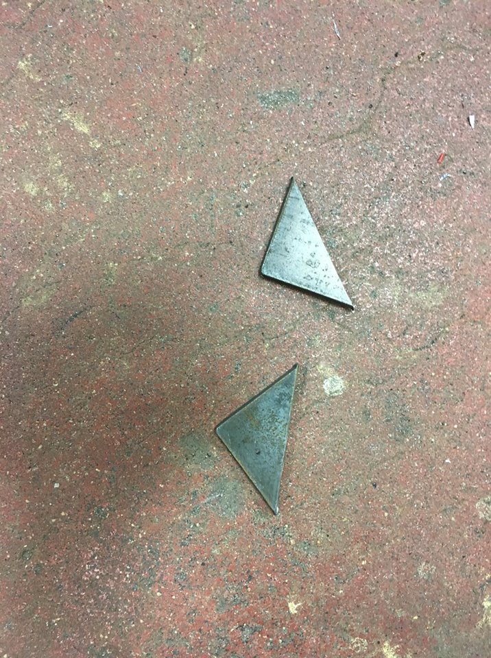

The system here only allows 10 pics so here are the rest to go with the subject.
https://lateral-g.net/forums/attachm...1&d=1618786985
