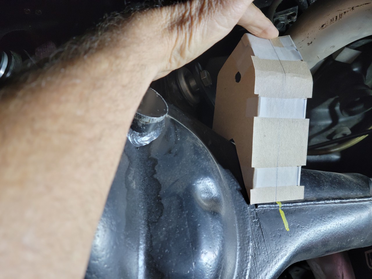

One of the issues the aftermarket companies are up against in creating 3 link kits for these cars is in most cases the weak OEM 10 bolt has been replaced with something stronger, and most all of those stronger options are different from each other. The kit I'm using is designed as a bolt in for the 10 bolt, hence the custom bracket we are designing for the axle side of the upper link for my QP 9".
Lance
Care to share what 'kit' you're starting with? I have the 10bolt GN 8.5 so that's somewhat appealing.
Also.... I reached out to UMI last week to see if they had any updates & apparently they're just bench-racing @ this point. They indicated no design work has even begun.
Right now it is still in the testing phase, I'll share more as it develops and becomes available. I think you'll like it though.
Lance
