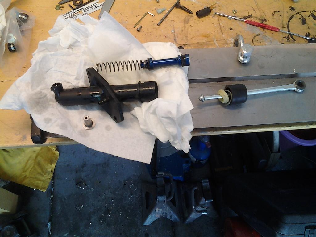

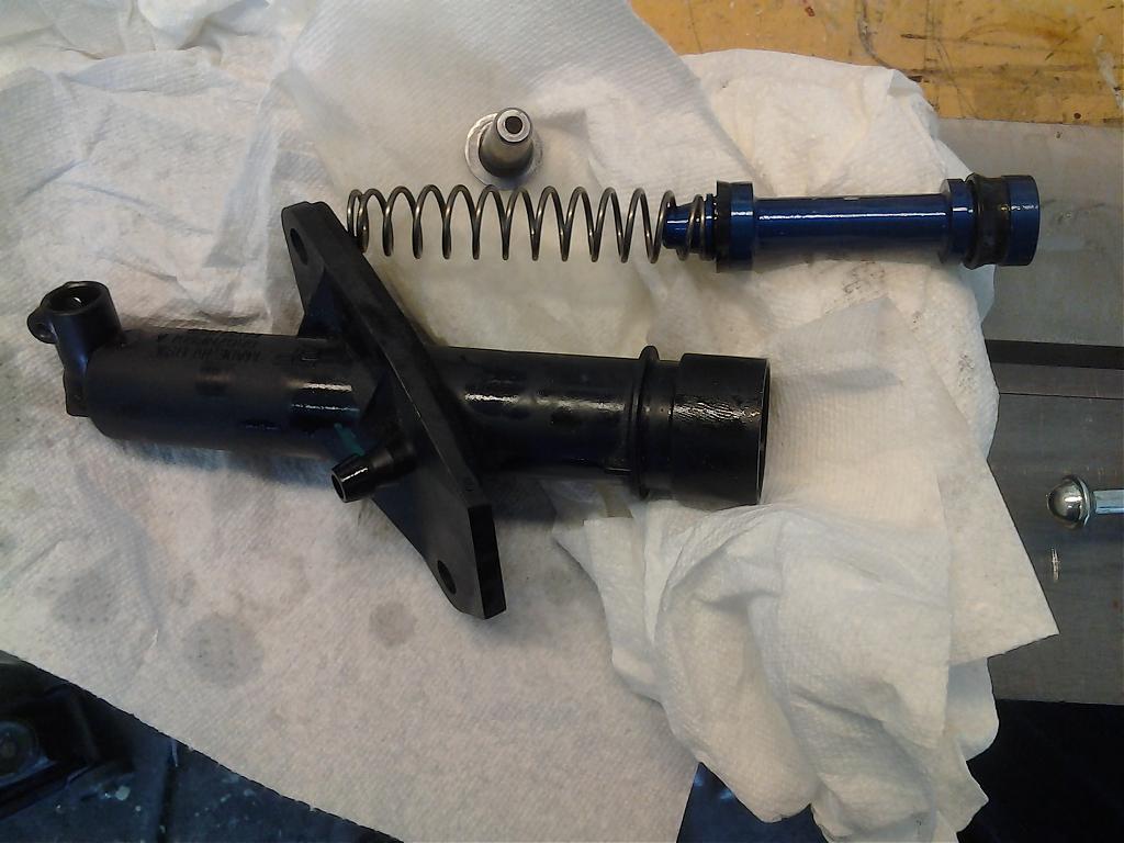

Thanks Here's a few more pics of what I've been up to. Reading through several posts spread over a few forums led me to using a 98-02 F-body Clutch Slave to actuate the Viper part in my transmission that in turn engages the Mcleod clutch. I took it apart and cut the stopper in half to get the extra throw. I also started on making my original clutch pedal engage it.

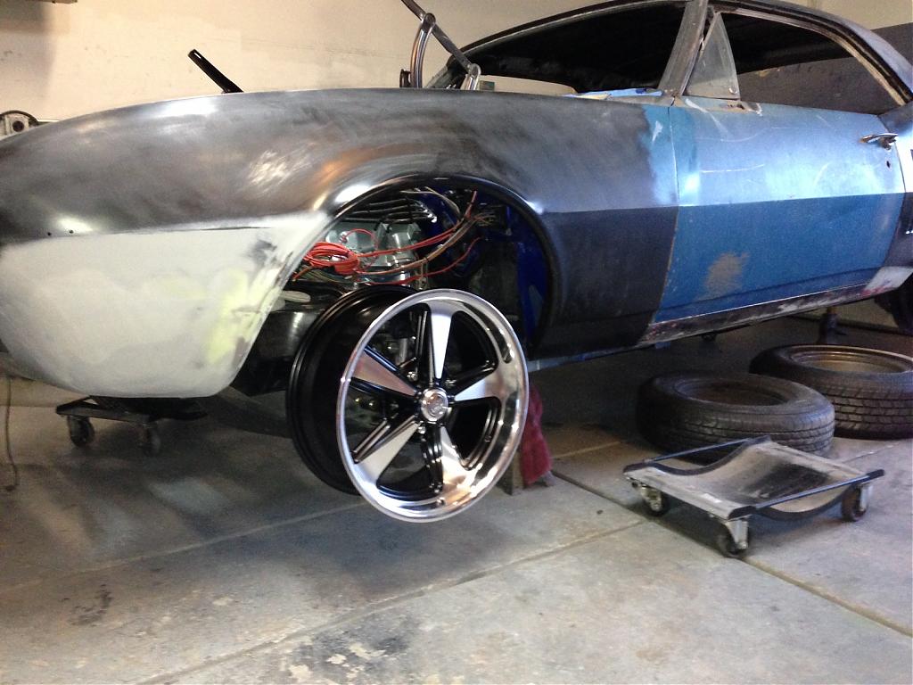

Long overdue for an update so here we go:
Fuel system: complete (used a Tanksinc pump setup, ROBBMC regulator, 3/8 stainless feed and return
AAW wire harness, installation underway
Pedals refurbished, modified to work with new clutch, and old butchery welds cleaned up
Lincoln Mark VIII fan installed
Bought an American Powertrain x-member that was supposed to fit.....of course it did not, so had to modify to make it work
Ordered a RideTEch 4 link and coil-overs, waiting on getting the wheels and then I'm going to attempt to narrow the Ford 9" I have in waiting.
I've also been continuing to work on the body and will be attempting an initial start of the motor real soon to get the cam broken in and make sure nothing leaks
On to the pics:
