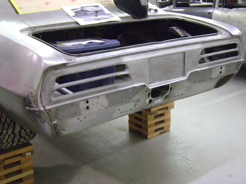

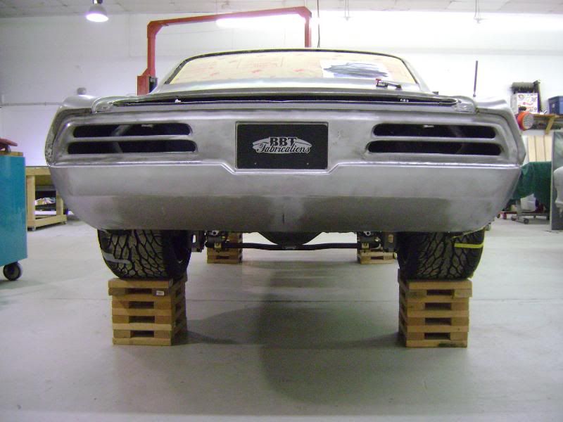

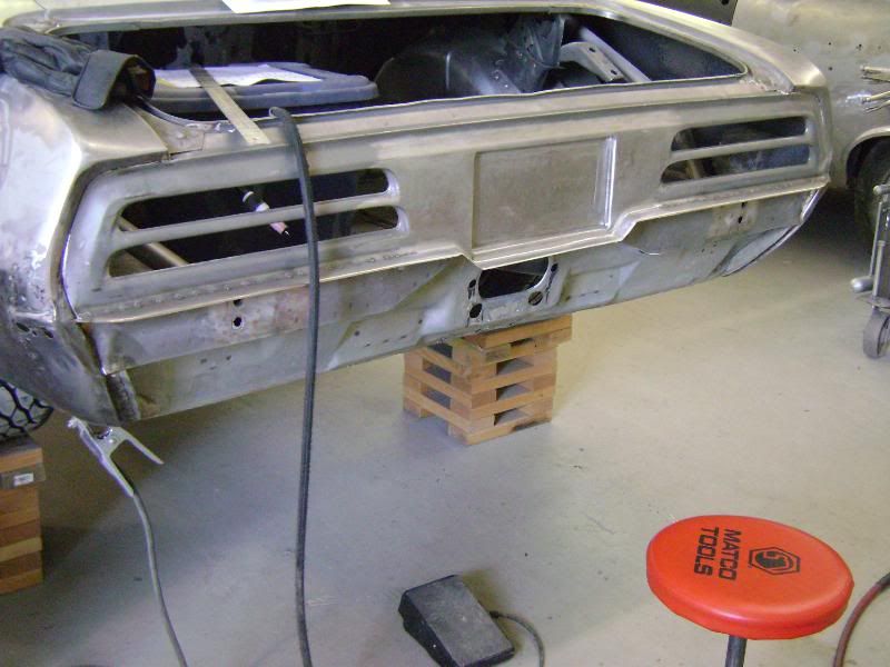

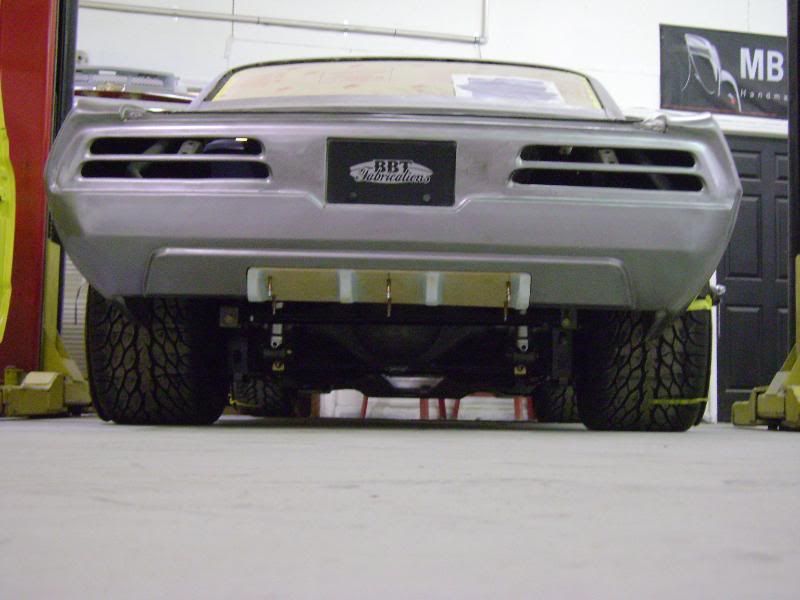

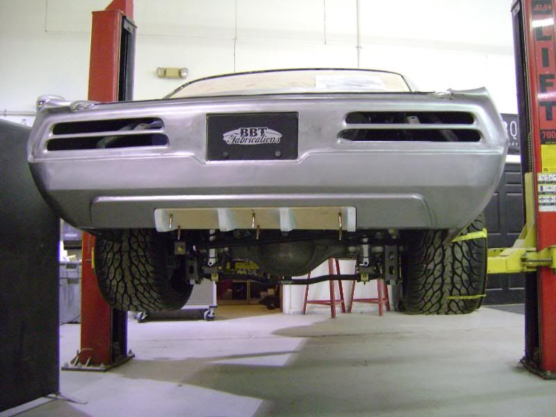

got everything on the rear end finished but the exhaust cut outs...
-troy

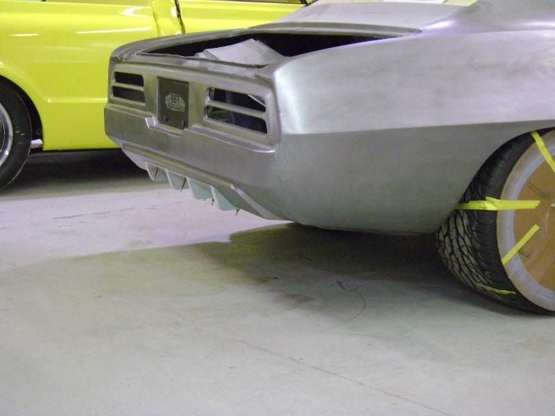

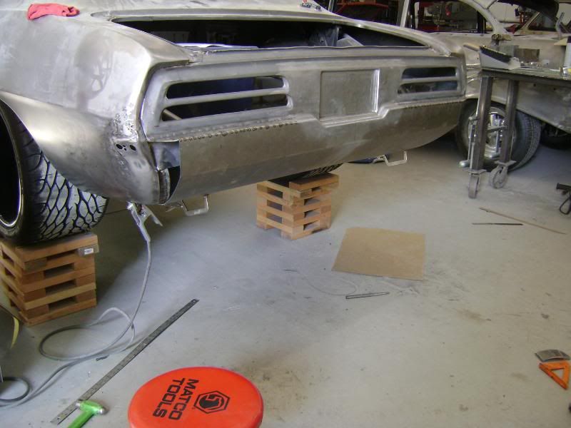

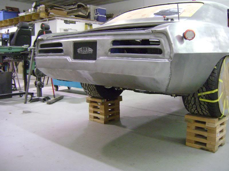

Posts: 208
-troy
