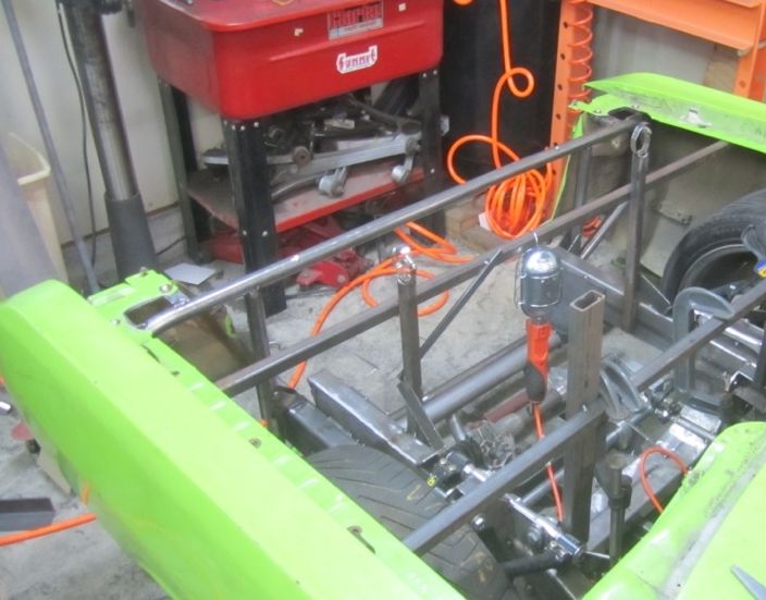

My next trip to the states was between school semesters and I had 3 weeks of playtime. My wife was not with me on this trip and I made no plans to visit with anybody, accept the nieces and nephews of course. This trip was all business. My goal was to have the car sitting on it's own wheels by the time I left. This meant building a full chassis, installing it, suspension, engine/trans, etc, all while overcoming a bajillion obstacles that I had no idea were coming. To alleviate the suspense, I didn't make my goal. I could have but I chose not to rush it and left the car on the table for the next trip; smartest decision ever!
So coming back it was time to build the chassis. I had spent almost a year of a few hours here, couple minutes there, designing it in google sketch-up (not exactly a great CAD program but it's free and you get what you pay for). So from that I started cutting 2x4 steel...
and welding rails...
and assembling a chassis...
the first iteration of my front rails failed as I forgot some basic 7th grade geometry about splitting angles between two tubes, it takes two 12* cuts to get 24*, not two 24*. So this is the chassis with more to come, and being taken away.
A sampling of some of the over-build parts for the suspension, spohn del-spere pivots joints and howe ball joints. 6 more Howe ball joints will be in route next month.
The beginnings of the back brace.
beginnings of the rear suspension drop-out.
And here is where I could have stopped since technically it's a roller.

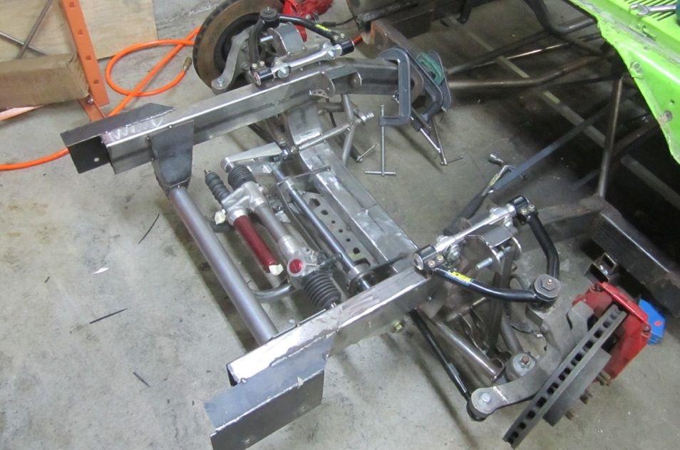

from there it was back to suspension mock-up (with the second iteration of front suspension geometry)
brackets designed and laser cut by a buddy (all to be replaced this Christmas with the third and final, and amazing, iteration of the suspension geometry; with huge props going out to Bryce for a hand in making it right!)

Since March, the suspension design has gone through it's final iteration and it's now an almost perfectly balanced (suspension wise anyway) design, front to rear. Again, a HUGE thanks to Bryce for taking my design, making it WAY better and getting it just right. Unfortunately this means I have to scrap the LCA's I built for some new ones, replace the UCA's with ones slightly longer, and build new brackets. I'm having Art Morrison bend up a new front cross member from 2x4 and am hoping to have them install the lugs for the LCA's and the steering rack, I should hear back on that in the next couple days. At the same time, I'm going to have them bend up new rear frame rails in a different design so I can have some extra room for a Rick's Tank under the trunk floor. Another reason for the new rails is I pumped WAY too much heat into these rear rails and warped the drivers rail so much that the rear tire has oodles of positive camber (painful lesson to learn). Rather than cutting, bending, rewelding, etc, I decide to replace it with a one piece rail, should work out awesome! I've been ordering a ton of parts throughout the year and have a lot more to go. These include:
