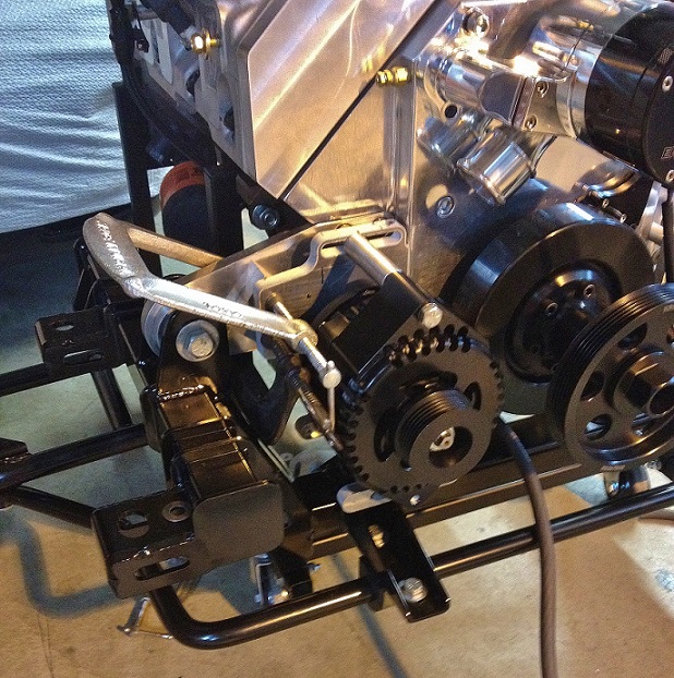

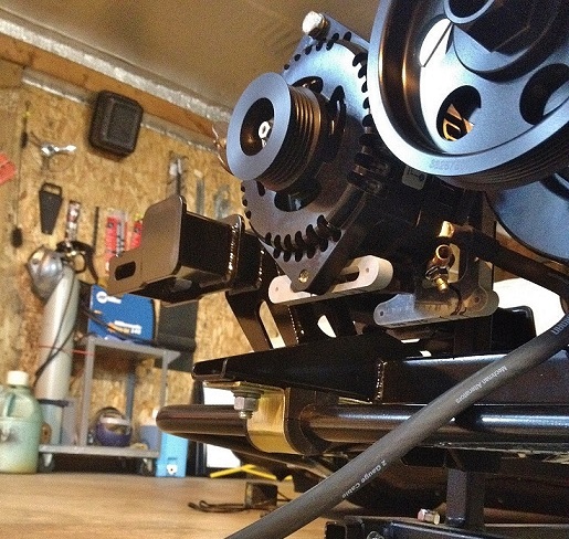

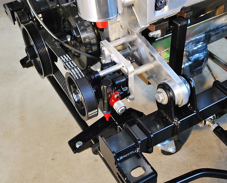

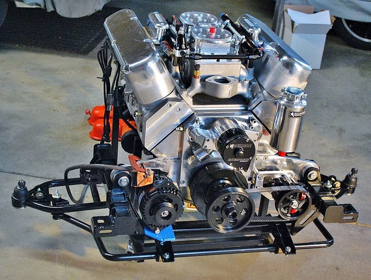

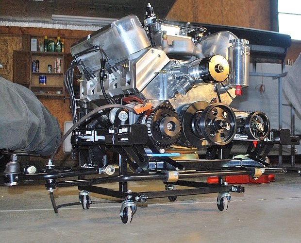

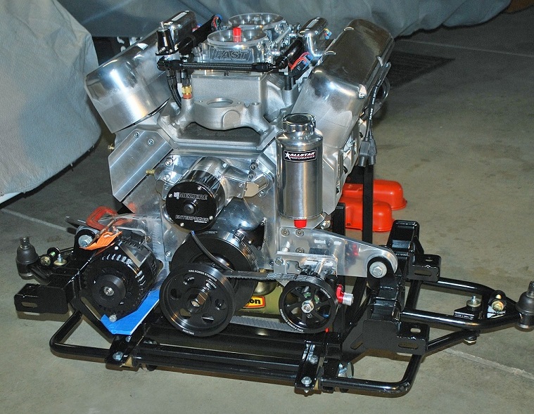

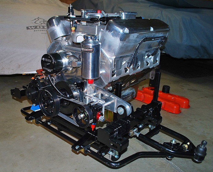

I had some time today for Mock up and try to figure out the Alternator Bracket...made some progress on that, which consisted of throwing out what I started and going a totally different direction, if my idea's pan out it should be pretty trick when done. As you can see I decided to bolt the HDK K frame up, I had to remove the Rack to fit around the engine cart but everything looks like it will have plenty of room and not interfere with other parts. I also set the Valve covers and induction system on to get a better feel for the Power Steering Reservoir potential mounting location, it's either here or the Radiator support next to the Radiator hidden under the front cover. Enjoy the pics...

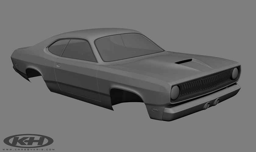

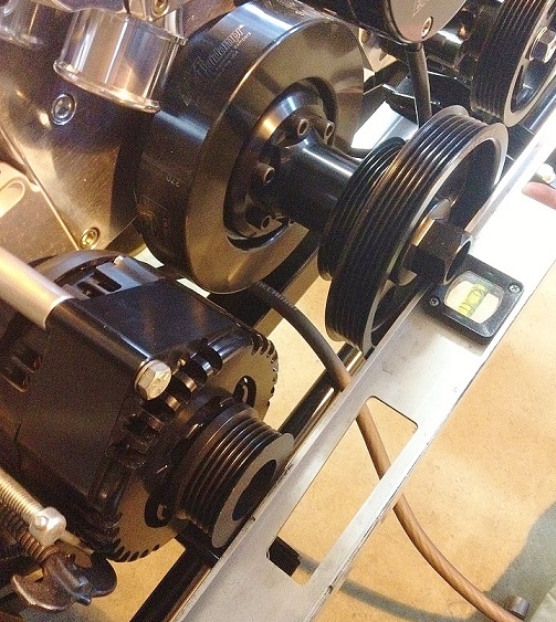

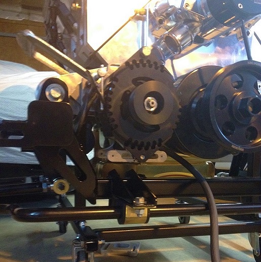

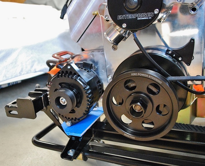

Okay enough with the plexi-glas templates, I made my 1st Alternator mounting bracket out of .500" 7075 t-6 aluminum and will make adjustments from there next week on the second one, I am going to cut it down as much as possible but everything aligns and will take a 26.7" serpentine belt and be the same length as the Power steering belt. I also got a email from Kris Horton of the Duster rendering he's working on for me it's only in greyscale so far but I think it's cool.
