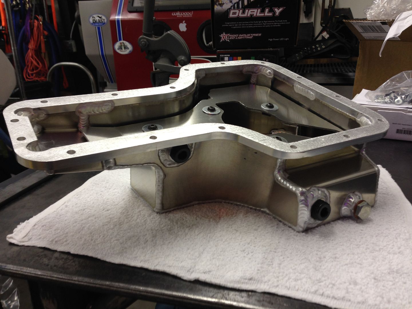

Do you have any more pics of the bad ass oil pan? I'm about to tackle this tyoe of setup in a stock pan for my truck and am interested to know what I'm up against.

Thank you sir. I've never done baffling before and I'm really unsure of how much of a gap I should allow where the baffle won't meet the pan.

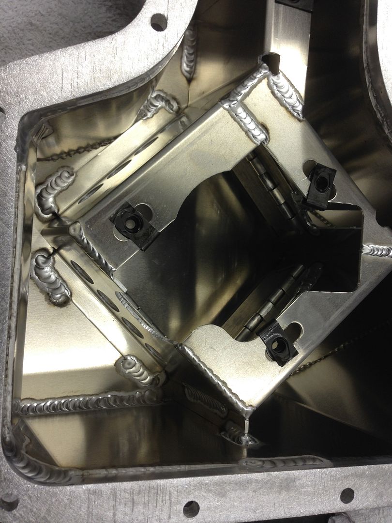

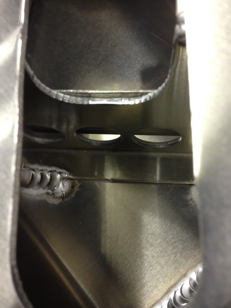

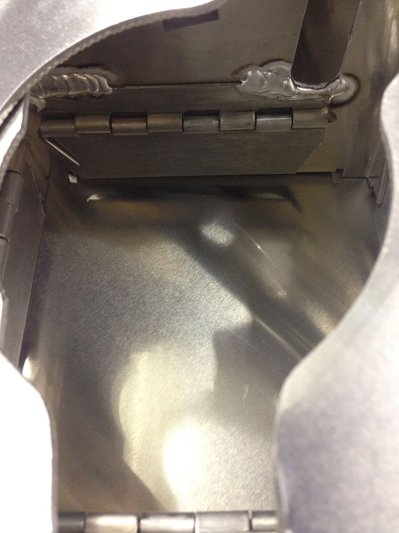

Okay Matt -- just for you - I disassembled the pan so I could get better measurements and better shots for what's inside….
The BAFFLE HOLES are .250" (1/4") off the bottom -- so it takes 1/4" of oil to get to the bottom of the holes…. or thinking of it a better way -- there's always going to be 1/4" of oil in the little sump box.
The FLAPPER DOORS only open to the inside to let oil IN the book -- and they're also .250" off the bottom -- so the flaps are just right at the bottom of the holes.
The box is basically just creating a sump for the pick up…. I haven't dropped the pan to see what size the pick up is so I don't know how much room they're left "around" the pick up. My guess is 1/2 to 1" on all sides.
Trap doors are on the INSIDE of the "sump box" and only open inwards

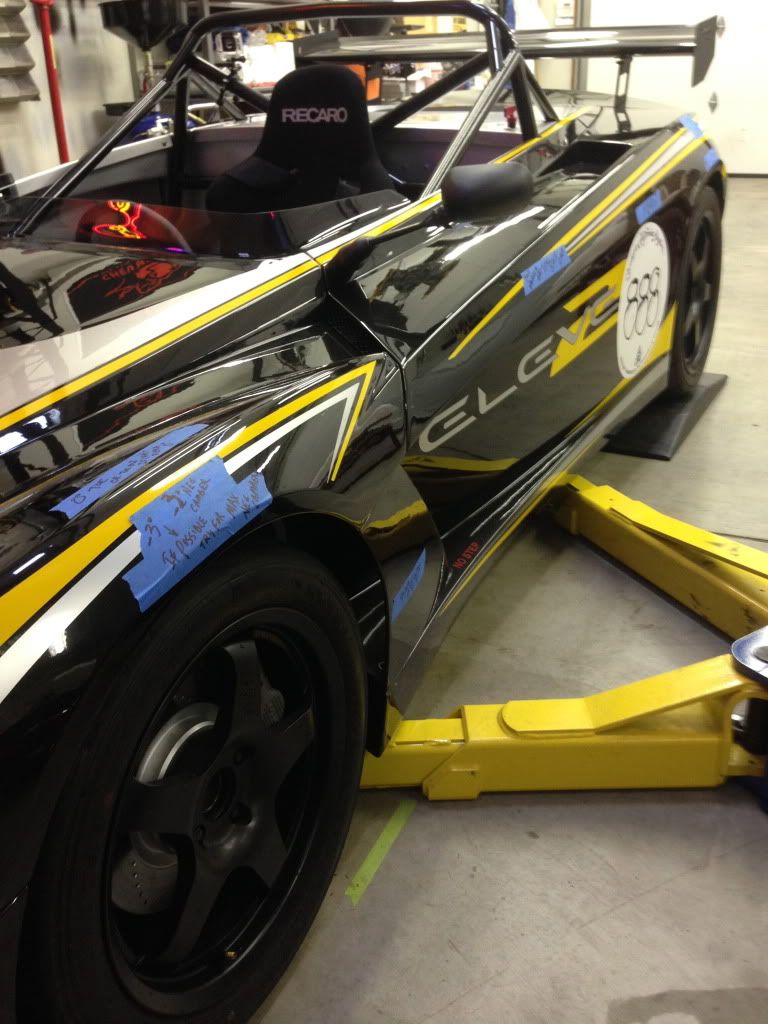

And then for the rest of you suckwads that think I don't care about handling (I do -- I'm just not spending my track time messin' with stuff - I'm there to DRIVE).
The car is going for line up - corner balance - height set up - rake etc --- so since I have SPECIAL settings -- I've made sure they're there for reference….
