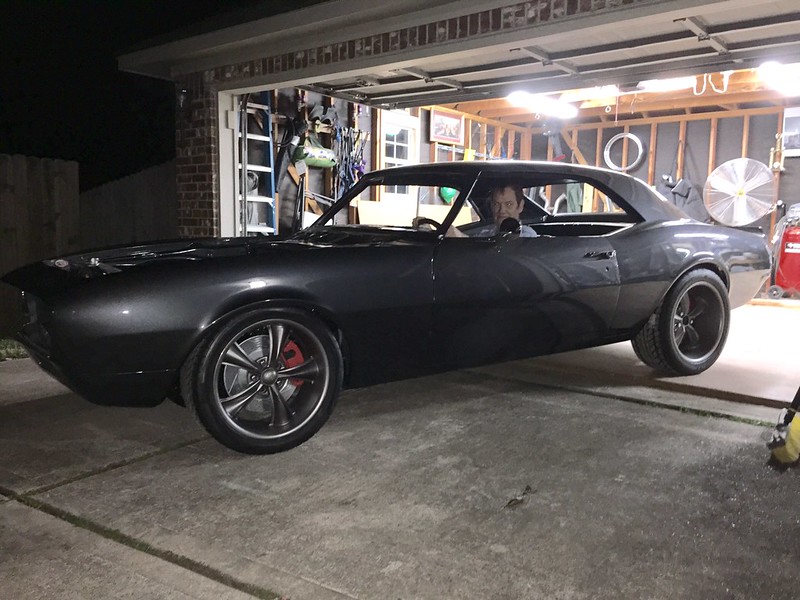

Denny's did a great job with the driveshaft...its a shame it can't be seen:
The new backlit Autometer's are pretty rad:
I was able to drive the car out of the garage under its own power for the first time since I got it. It was dark, so no quality video of the voyage.
I'm looking forward to getting this car on the road legally, even if it doesn't have a finished interior.

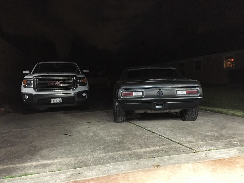

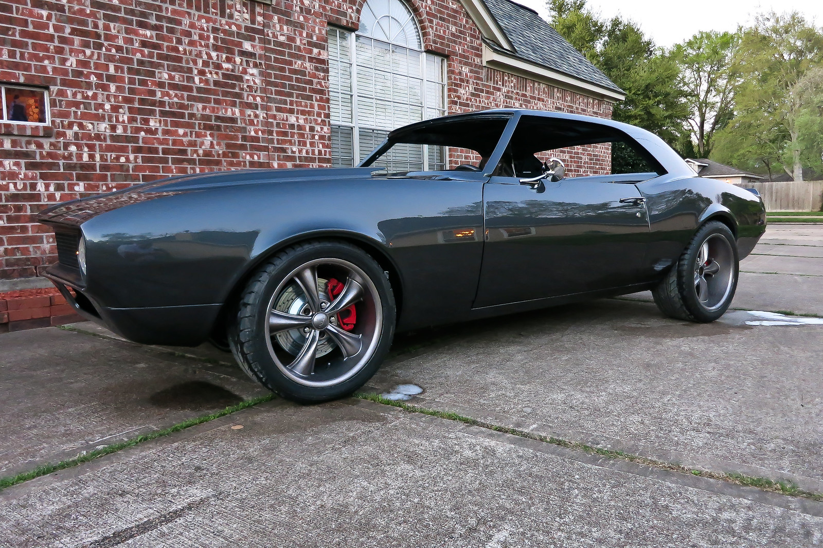

Just some random shots from this afternoon:
I picked up Tu's (rickpaw) Budniks so I'm anxious to get those installed.
Interior is coming along. Glass should be here this week sometime.
1967 Camaro - Project "Resale Red" - Sold to 175RGR

Your driveway looks very familiar....you need to do the video when you finish....
