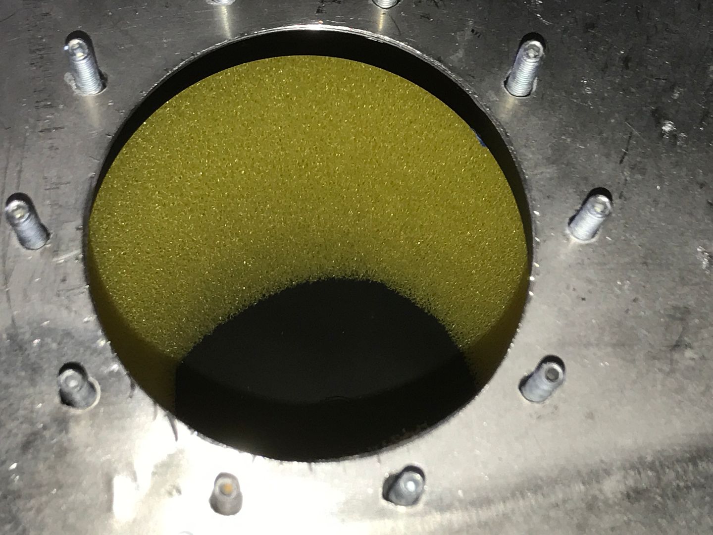

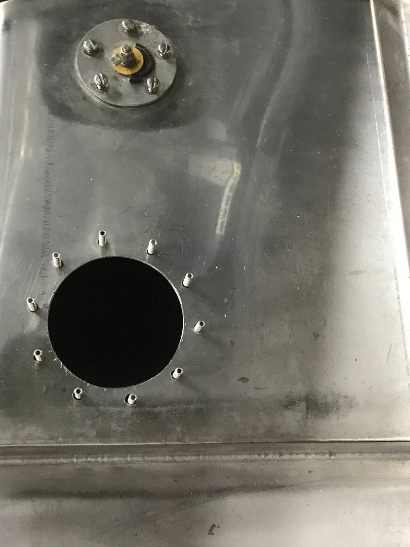

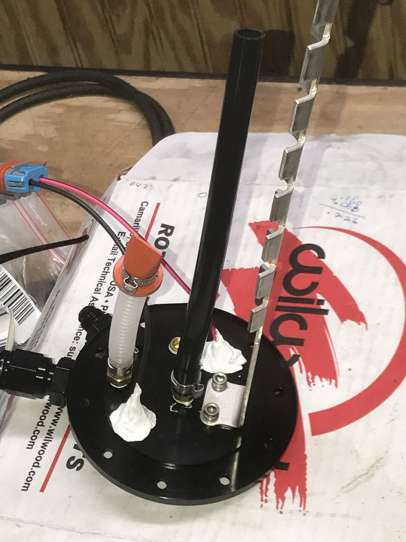

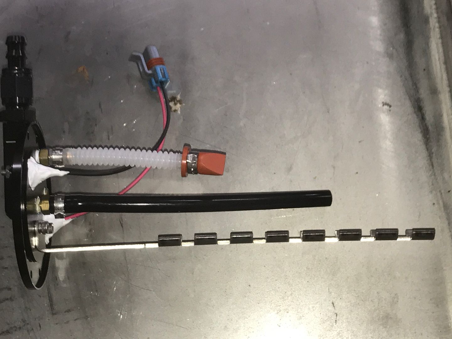

i decided to go with an Aeromotive Phantom Flex retrofit kit for my tank. That thing is sweet. I was a little nervous about putting a 3 1/4" hole in a stainless tank but it worked out okay. There was a siphon tube at the bottom that was used to feed the old system, so I had to work carefully to cut that out with a cutoff wheel on a die grinder being fed by an air hose through the filler neck. I barely had room to get my arm in there and could not see anything. Not my favorite way of handling a cutoff wheel but its now finished.
