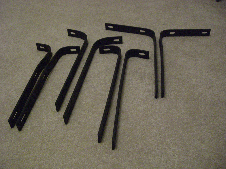

More parts arrived. Front 3 are interior lights. Center is the light under the dash pad. The other 2 go at the top of the B piller. They don't look like it - but they are 3 posn rocker switches, left is on, right is off and center uses the door pins. A nice part if anyone is looking for a simple square light in the kick panels, under dash or trunk.
The back 3 are exterior rear lights. 2 that go on the bumper facing up for the license plate light. The other is the backup light assy. That's it for all the interior and exterior lights except the headlight bulbs. Gotta run over to the Harley Davidson store and see if they can identify the bulbs in the orange 55 chevy at Columbus.
Also blasted and primered the bumper brackets - I needed to get something finished so it feels like I'm moving forward....

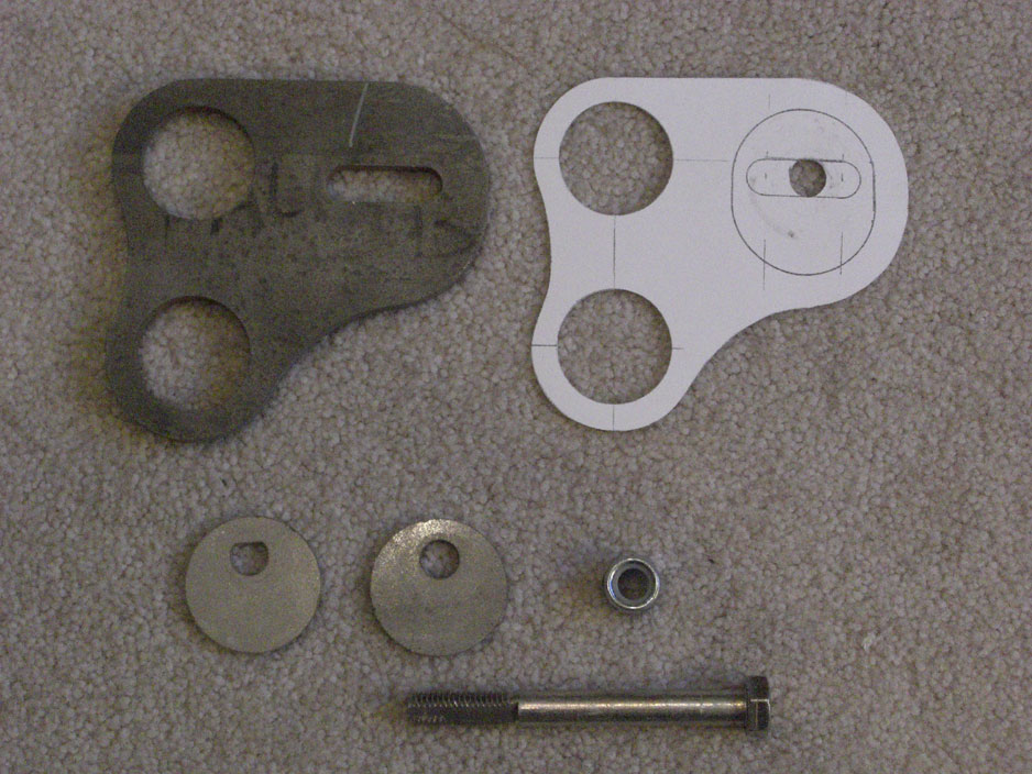

Parts coming back from the waterjet shop. Really amazing what those guys and their machines can do.

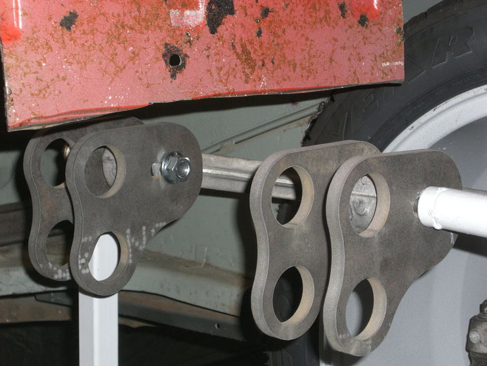

Rear upper frame/a-arm brackets and adjusters. 4130 plate cut for a dual 1.5 tube frame and M12 1 3/4 adjuster. Changing the adjusters from the lower arms (stock posn) - to the upper one's so I can remove the lower transaxle cage without worrying about an alignment. (doing it like Rodger/John's Nova and Johnson's G-Force Cuda) Still need to round all the edges and mill in the pocket for the adjuster. Will replace the adjusters with stainless ARP 12 points and stainless eccentric washers - should be purdy...

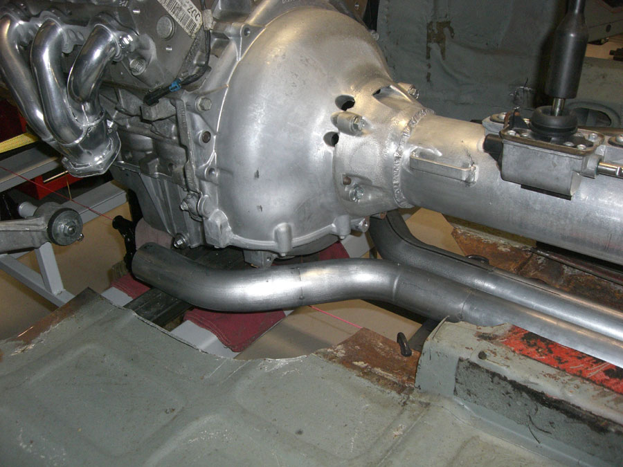

Well, it's been way to long guys....

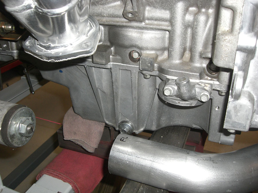

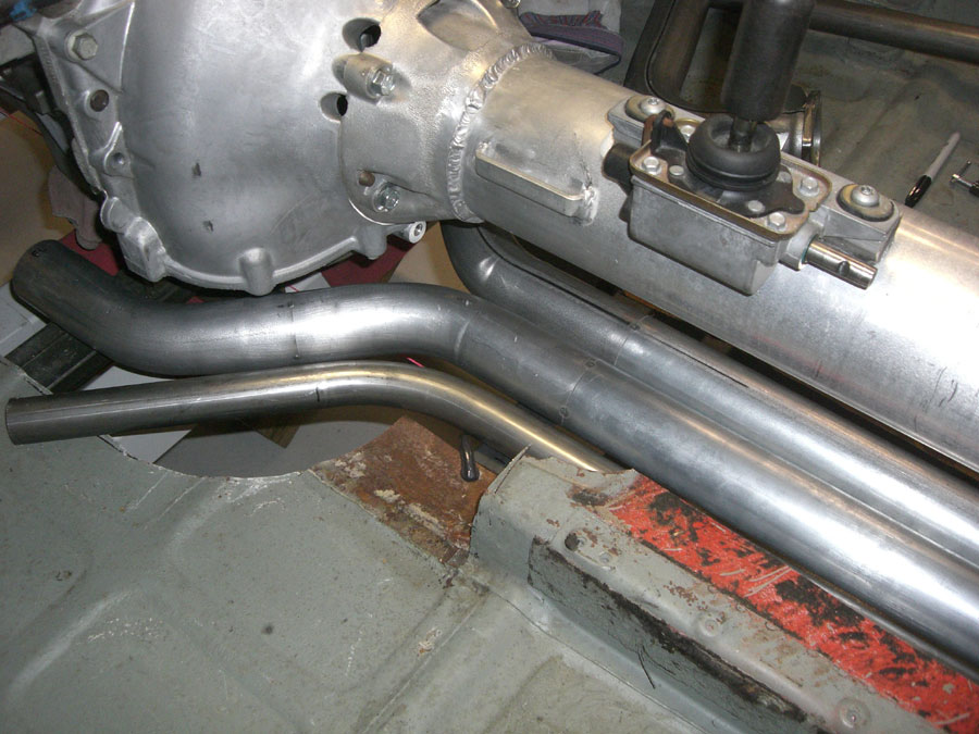

Started fabbing up the center backbone portion of the chassis. Had to build up the front sections of the exhaust to get final measurements for the tunnel width. 2 exhaust tubes at 2.5 plus two chassis tubes of 1.5 plus some space on both sides. Some 2.5 straight pieces, four 45s, two 90s and two 2.5 header flanges. (All from Summit for $200)
I plan to wrap the entire exhaust and add some heat shielding in the tunnel.
Also bent up a chassis tube to see how it fit in. Front a-arm attachment tabs will hopefully come in this week from the waterjet guys. Been waiting a month - but the holidays slow everyone down I guess.
Jim

Default Exhaust Fab Tool

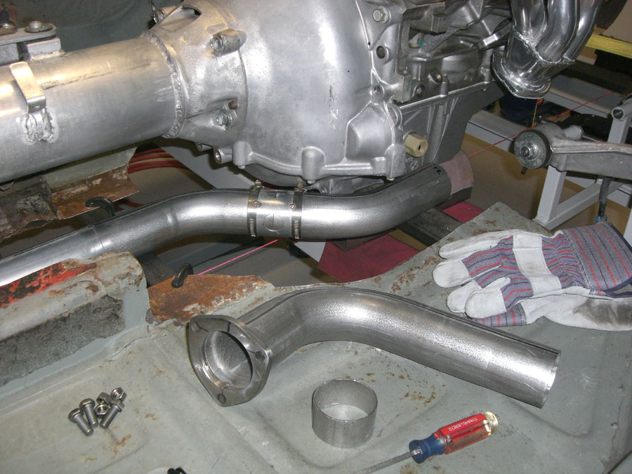

Reading this months Super Rod (Feb pg 108) and they listed the little alignment tool they use to align and tack weld their exhaust work. I built one outta a scrap of 2.5 tube and it worked great.
Take a piece of tube about 2 inches long - drill four 1 in holes every 90 degrees - split one side - and tack on a couple hose clamps. Install and tack through the holes - made it so easy to hold the tube square while you zero a tack weld !
