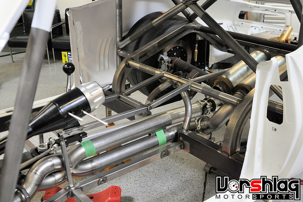

Awesome build! Terry you might had already posted this info but how far back was the engine set?

Love the exhaust.. was thinking
of mating my firebird exhaust in the trunk
and punching it out where the license plate
goes.. similar to my Pantera exhaust
Will be watching where yours ends up
Bob
That's a good question - we didn't have the car here at any time with the OEM location. Its at least 18" setback, if not more. I will measure another 1st gen soon, then see where we are relative to that.
Bob
The exhaust on this car is terminating in a different position than that...
...these two exhaust pipes will exit into the front of the diffuser. Blown diffuser. Will show more soon.

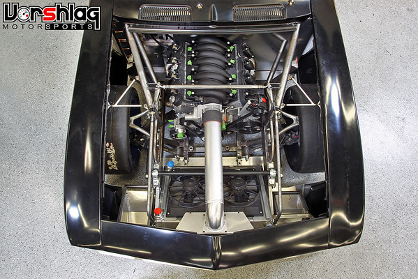

The front hood ducting is fairly elaborate but looks pretty amazing when its all assembled.
I'll more of that soon.
Very soon.
