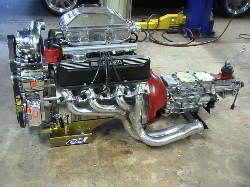

Dress rehearsal:
Richard
67 Super Snake
427FE Vortech T Trim S/C Fast EFI
TKO600 Trans

Engine has been set in the engine bay. Headers have not been installed yet. I just wanted to see the fit. You can see by some of the red circles in the photos that I have some clearance issues. Anybody installing the shock tower bracing and a FE engine will have to do what I am going to do. I need to grind down the upper areas to clear the header bolts. VERY TIGHT!
Driver side front:
And I was wondering if where I have cut through the firewall was going to work. It will work just fine:
I mounted the fuel pressure regulator first:
Good thing I have a high hood:
Richard
67 Super Snake
TKO600 Trans
Eleanor Registry

I installed the headers. A shoe horn and a little grease was needed.
They are touching the shock towers. I may need to loosen the motor mounts and lift the engine.
I started hooking up the oil and PS lines.
I hooked up all the EFI wiring, some water hoses, vacuum/boost lines and other little things.
Richard
67 Super Snake
TKO600 Trans
Eleanor Registry

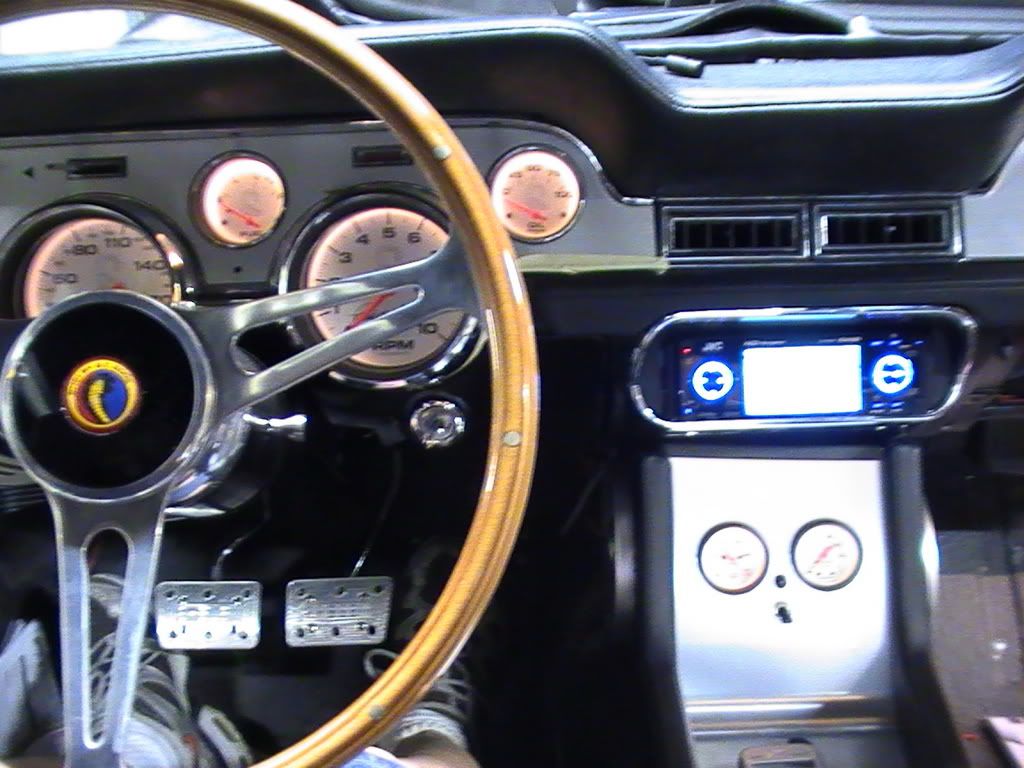

Almost finished with the interior wiring. All the alarm triggers work, lights, radio, radio dimmer, speakers, backup camera, console lights, etc etc. The only thing that doesn't work is the remote start. I probably have a wire in the wrong place. 12 hours today. Its gonna have to wait till tomorrow.
The radio faceplate has 4 tilt positions. It remembers the position when you turn it back on. This is position 3.
