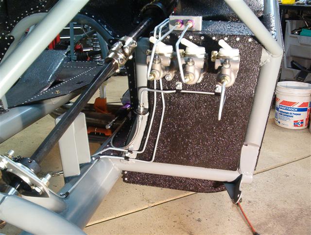

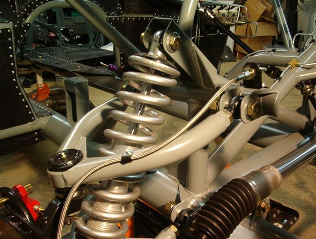

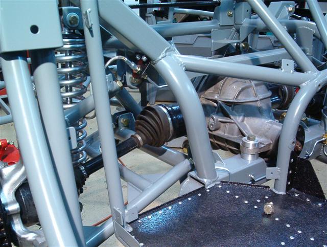

I have gotten a few more things done, and continue to move closer to wheels on. Steering is back on and all hooked up. Also I have plumbed all the brakes. Still haven't tightened all the bolts yet, I will have to soon, but I will have to find time in large enough blocks to do all the squaring. But now to get to why you all tune in here. PICTURES

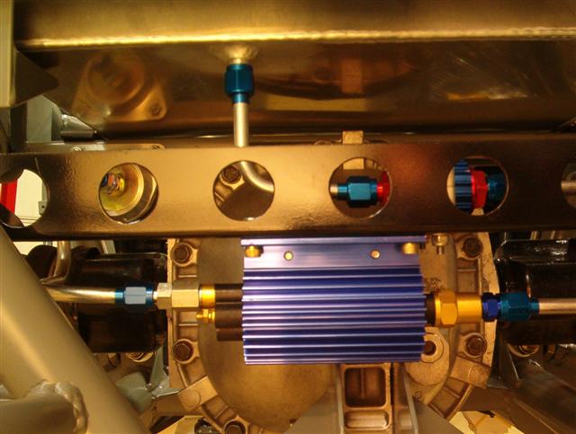

Wow, It's been a while since I posted any updates, well here's what I've been up to. I now have the basic fuel system plumbed from the tank to the firewall, the rest will have to be done after I get the engine in the car. Now as per usual nothing about this was quick or easy. Just thinking about how I was going to do this was a headache, but with the help of lots of forum members and a good bit of money and some additional cussing and swearing I was able to get some things done.
Pump mount, inlet filter, and pump this was a head scratcher the big problem was space and the ability to plumb lines.
Outlet filter, now this required some crazy plumbing yes it looks close to the axle, but I've had some smart people check it out a they said it looks great.
Feed and return lines, this was relatively easy I say that with a smirk.
