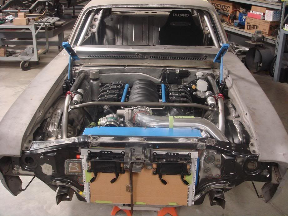

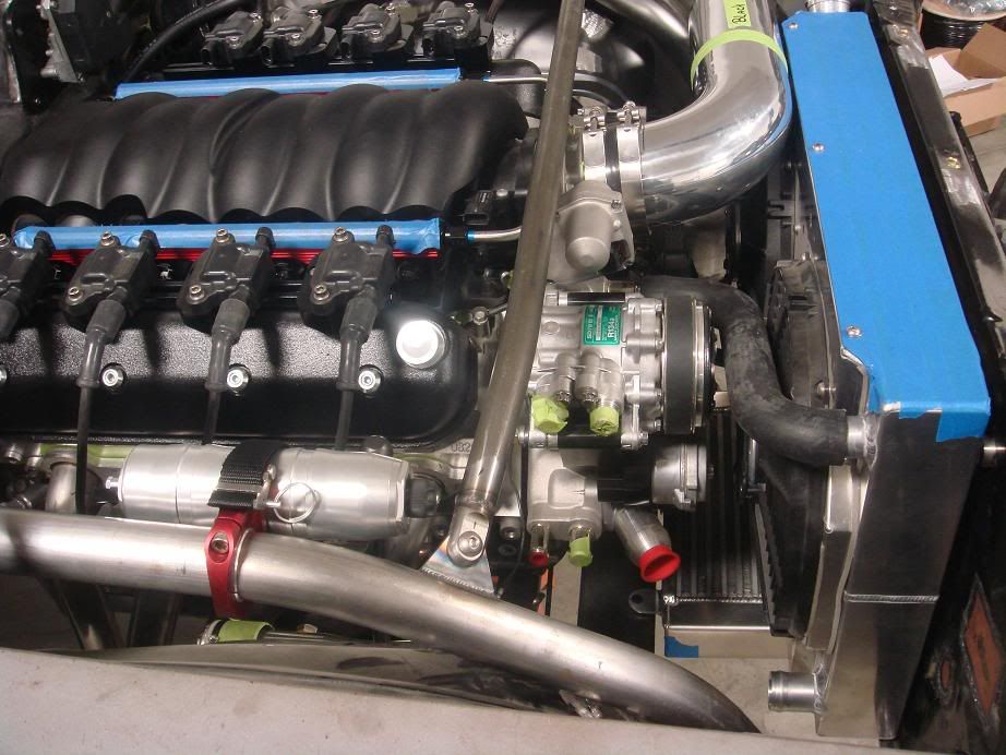

Finally an Update . Started working on it again. In the process of packaging everything. The engine compartment is filling up fast with coolers, reservoirs and plumbing. Here are a couple shots.

Are those the coil over adjustment canisters on the cage in the engine bay? Good idea!!

?? tell me about this cooler ??
Yes sir, those are the remote canisters. thanks
Looks awesome as always.
ps - Dan H told me to tell you Hi
Hey Marty, That is the engine oil cooler. I ran out of places to put a 9"x15"x2.5" cooler...lol. It might not be the most efficient spot, but it should still help out. Tell Dan I said Hi as well.

Looks good.....what are the two small black coolers on the front for? powersteering and ??
Nice packaging
Thanks, The other cooler is for the T-56.
