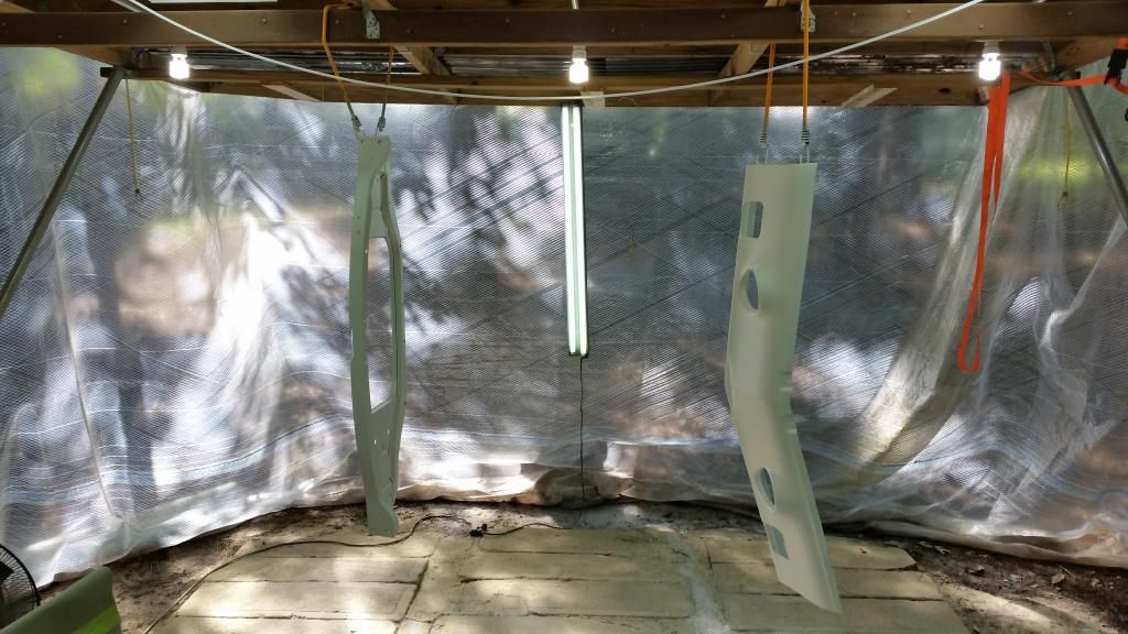

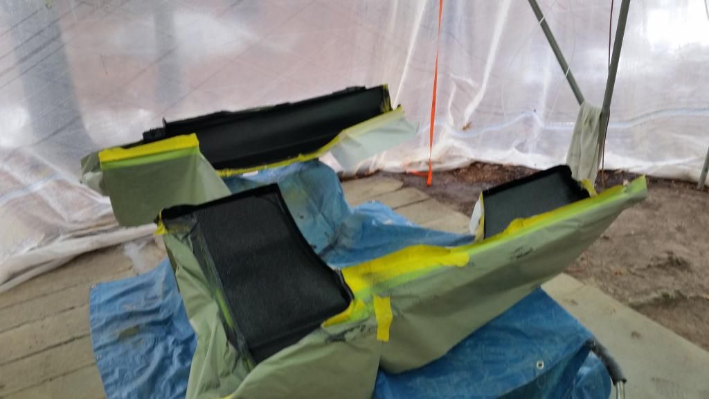

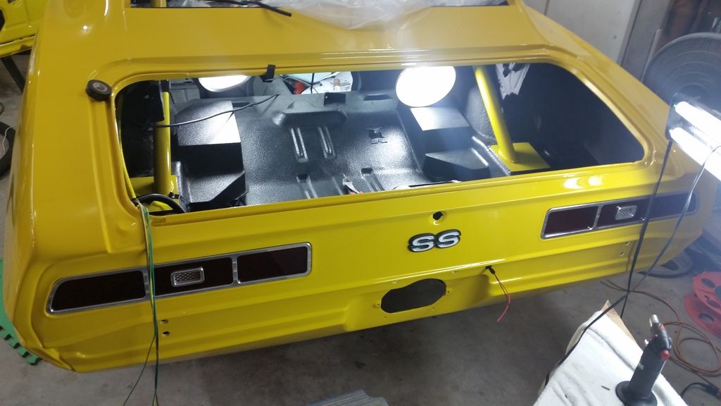

Smile Time for some updates...
Very time consuming as all of you know that do this kind of thing...

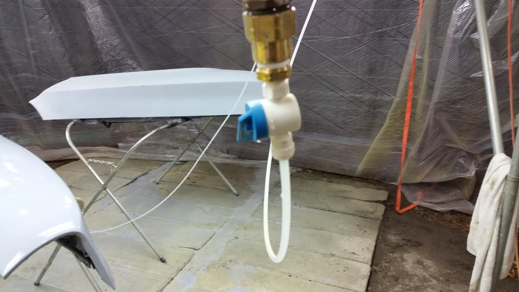

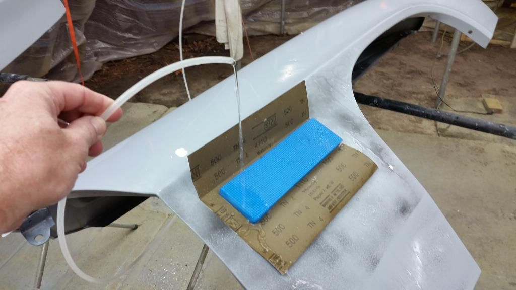

My home shop made water control for all matter's of wet sanding tool, works way better the ole bucket and sponge method.
I wish I would have thought of it sooner.
Ice maker tubing, valve and fittings, works great...

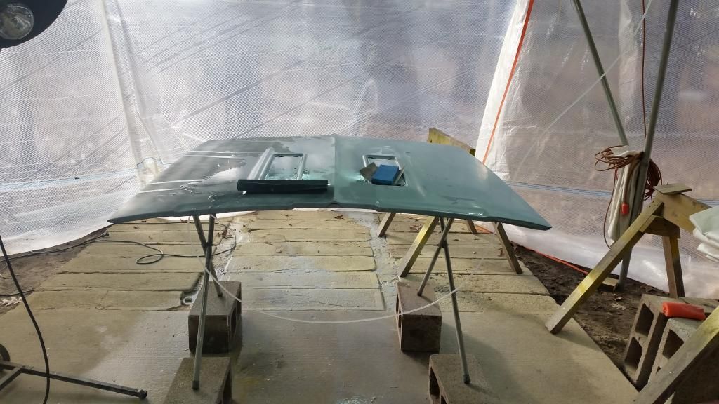

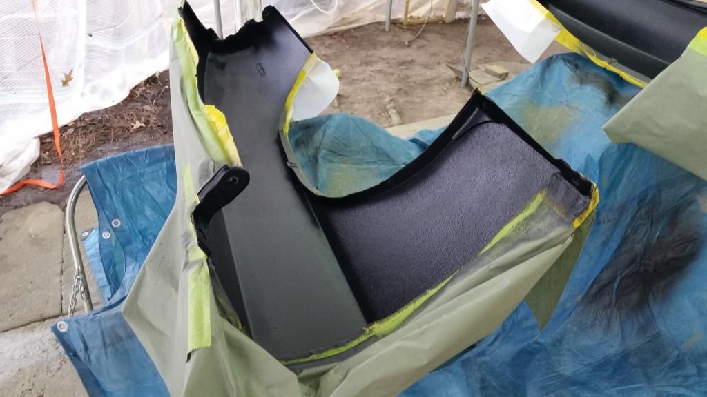

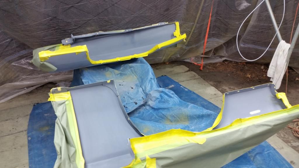

Prepping for the spray in liner...
My build BRNAGN 1969 camaro SS

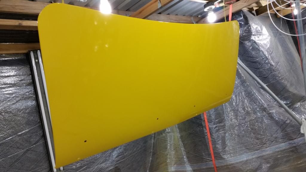

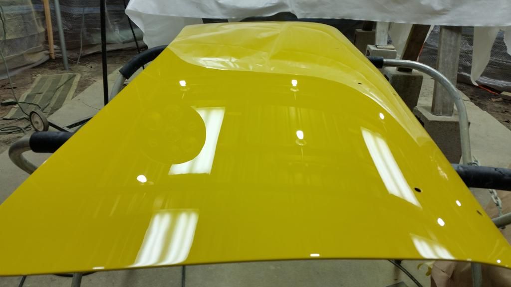

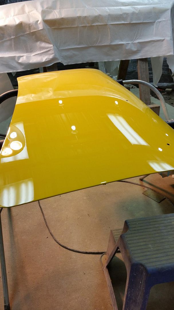

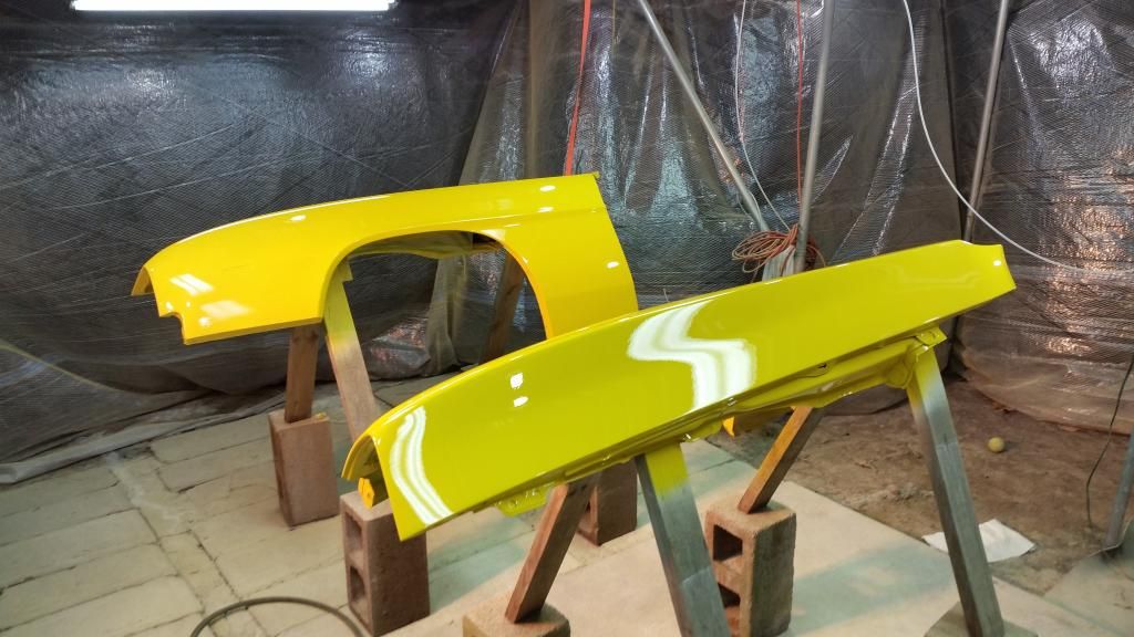

Dennis it looks great! I like that you put a white sealer down before you put the yellow on. Worrying me a little you didn't shoot the fenders on the car that yellow can be tricky . But it looks like you got it !

Thanks,
I worked that decision to paint it apart over many times.
I ended up assembling the front end four times and then tearing it all back apart just to get comfortable with the effort to get it together without doing too much damage to the surfaces.
I did not have access to a booth so that helped drive that decision.

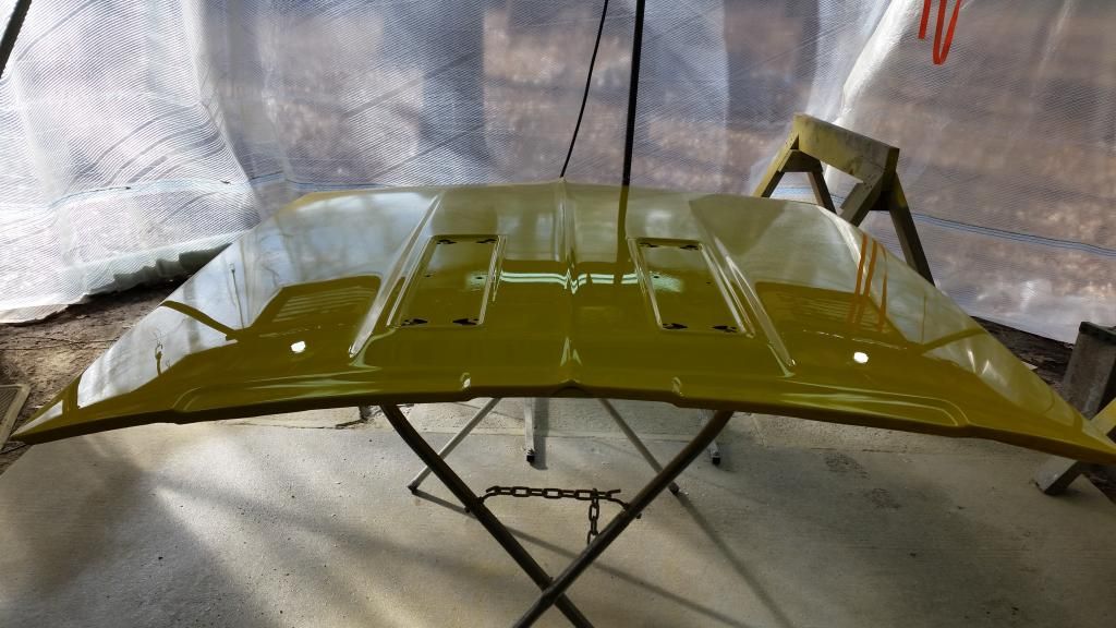

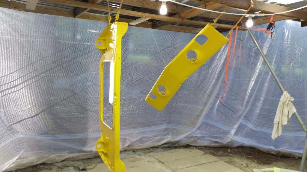

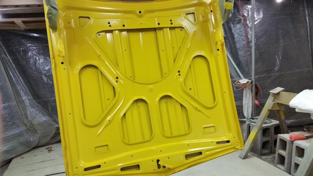

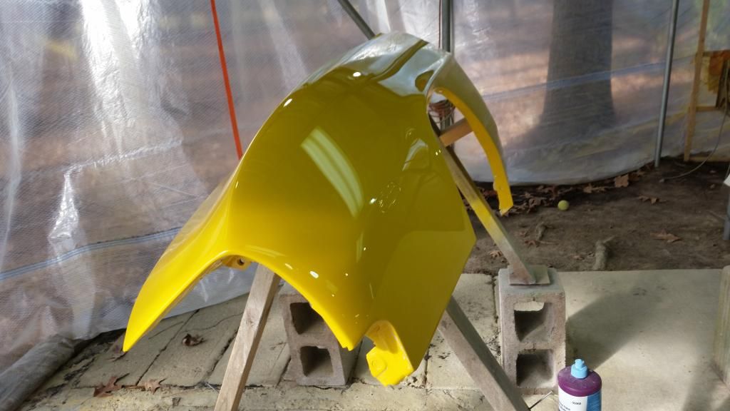

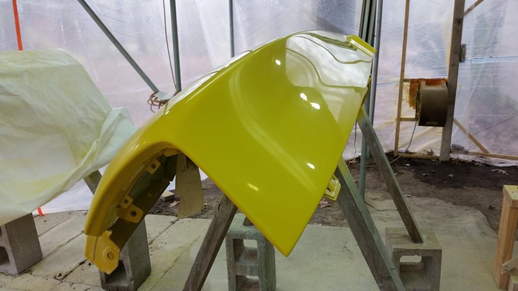

Smile More color shots...

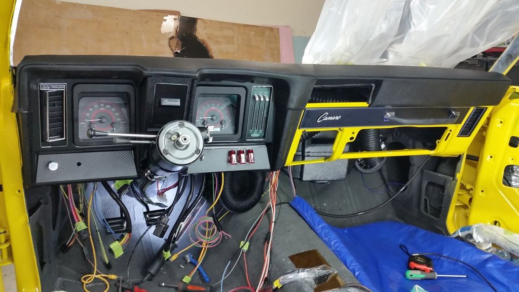

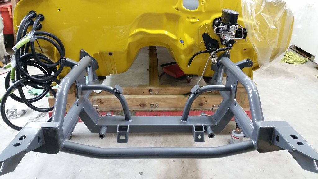

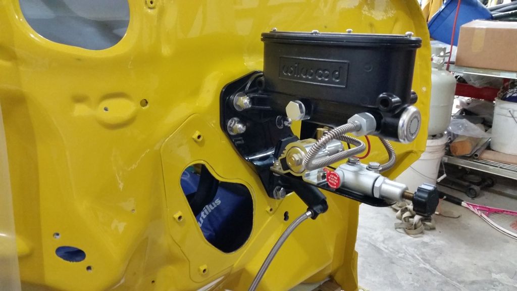

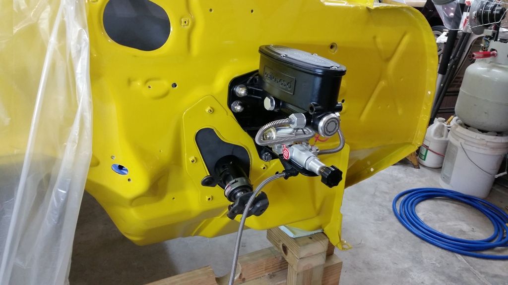

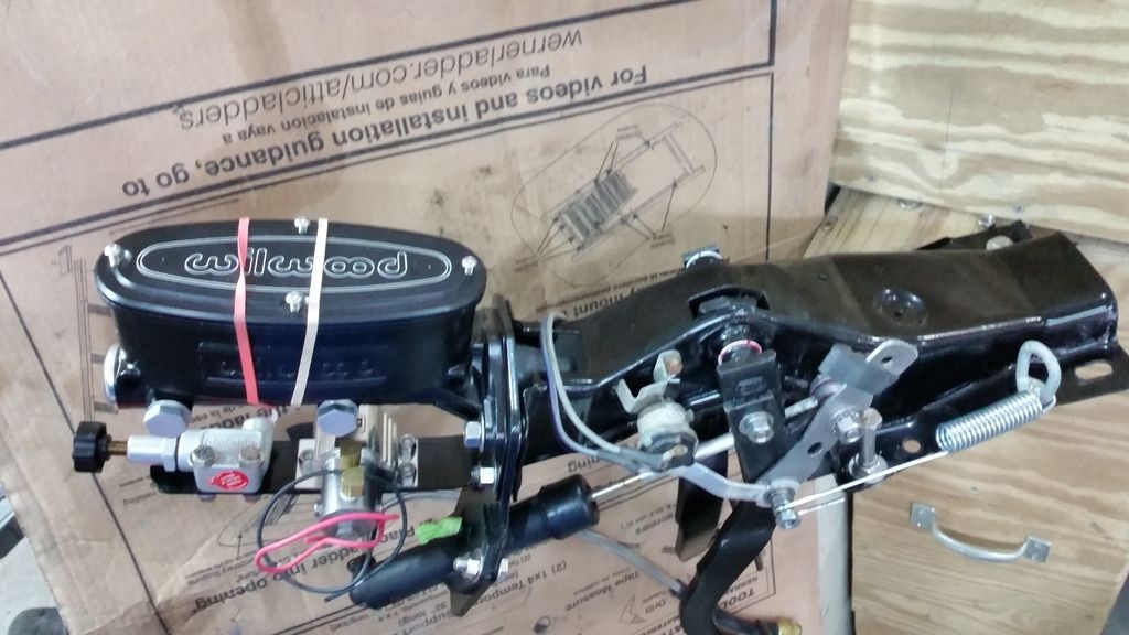

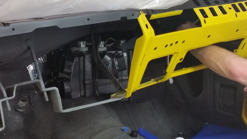

Smile Assembly has finally started

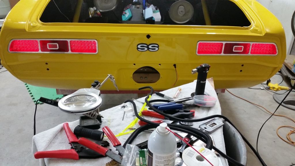

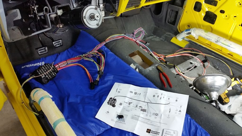

Here are progress pictures, finally getting around to posting...
The American autowire harness going in...
The TCI subframe and connectors installed.
