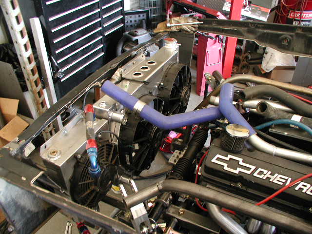

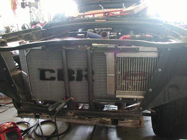

New rad is in, had to cut out the old rad mounting as even tho' they are the same size radiators, they aren't quite the same actual size. Added in the oil cooler and basically the nose is full of cooling devices. I am hoping I do not have to run the second oil cooler like I did on the 914 as this will have way better air flow than the placement on the 914 did.
Also mounted a ball valve for the fuel line so I can easily disconnect the engine. Lastly I made an upper cage that is tied together to mount the rear rocker arms to and tacked it in. Overkill for sure but safe. I can mount the fire bottle and/or battery in the recess.

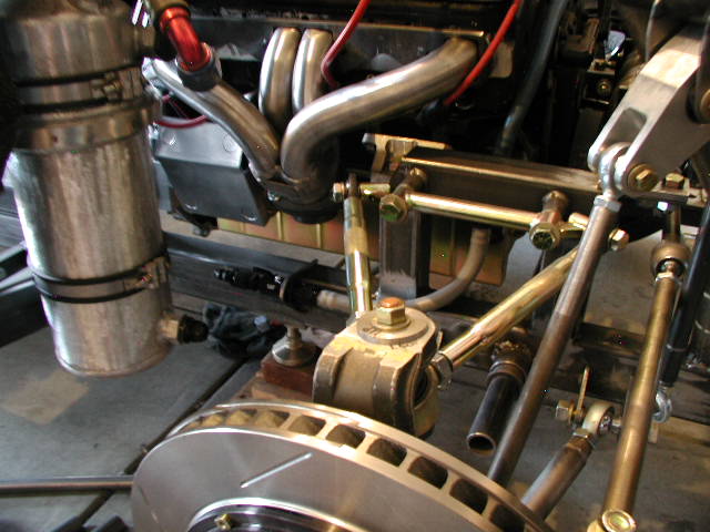

thanks guys! Shock showed up yesterday and I did a test fit, there is some interference but fortunately it doesn't appear to be too bad so I hope to machine some clearance in this weekend and verify I am good to go. One thing I didn't recall is that the monoballs are narrow in these shocks - narrower than a typical monoball from Aurora/FK/etc - so my high angle spacers are too wide. I need to call them and see if they can swap them out for a more typical monoball with the correct width for my spacers. The rockers are already machined based on the "typical" width so I can't just narrow up the spacers.
The joys of doing custom stuff.
edit - well, dammit, turns out I am too used to using heavy duty rod ends and spherical balls. There is a bunch of bearings that are 1/2" wide, not 5/8" wide. The problem is I can find some "wide" bearings but the housing also gets wider so they can't swap in. Will have to custom turn the spacers down and then make what is essentially washers to fill in the gap to make up the 1/8". Irritating but solvable.

Well, I am a little bit there. The 18" shock was just going to bind at full extension and that was not going to be a huge issue as it was just a little clearance grinding to solve. However tonight I got in there and got the base of it held into place and started to run the shock through motion into compression... well... I knew I lost 1" of compression asking for an extended eyelet at the one end which indeed minimized the binding as I had hoped. However, what I didn't realize is that I was going to lose another 1.5" with the extended spring cup - the shock body bottoms out on it! It all makes perfect sense since they have to be the same size to fit the spring, but not something that crossed my mind and was apparently a non-issue on the Porsche as I had the exact same setup on it.
I took a shock with 6.2" of motion down to a measured 3.8" and it bottoms out at about 1/2" of bump
So I will need to knock the mount tabs off and flip them over to move the rockers over the support, not under. Not a big deal really, just one of those things. What it does mean is the tubing I have cut and tapped for drop links to the suspension and could be used for the sway bars now all need to get longer as I have to fit a shock at least 3" longer to get full travel back.
