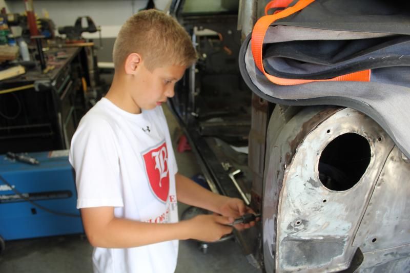

So after RicKD answered my question about the door, I winched it down from the attic and got it installed.
My son took care of chasing the threads for me....
The new hinges made a big difference. I had forgotten how bad the bushings were on mine.. Top and Bottom were just worn out.
