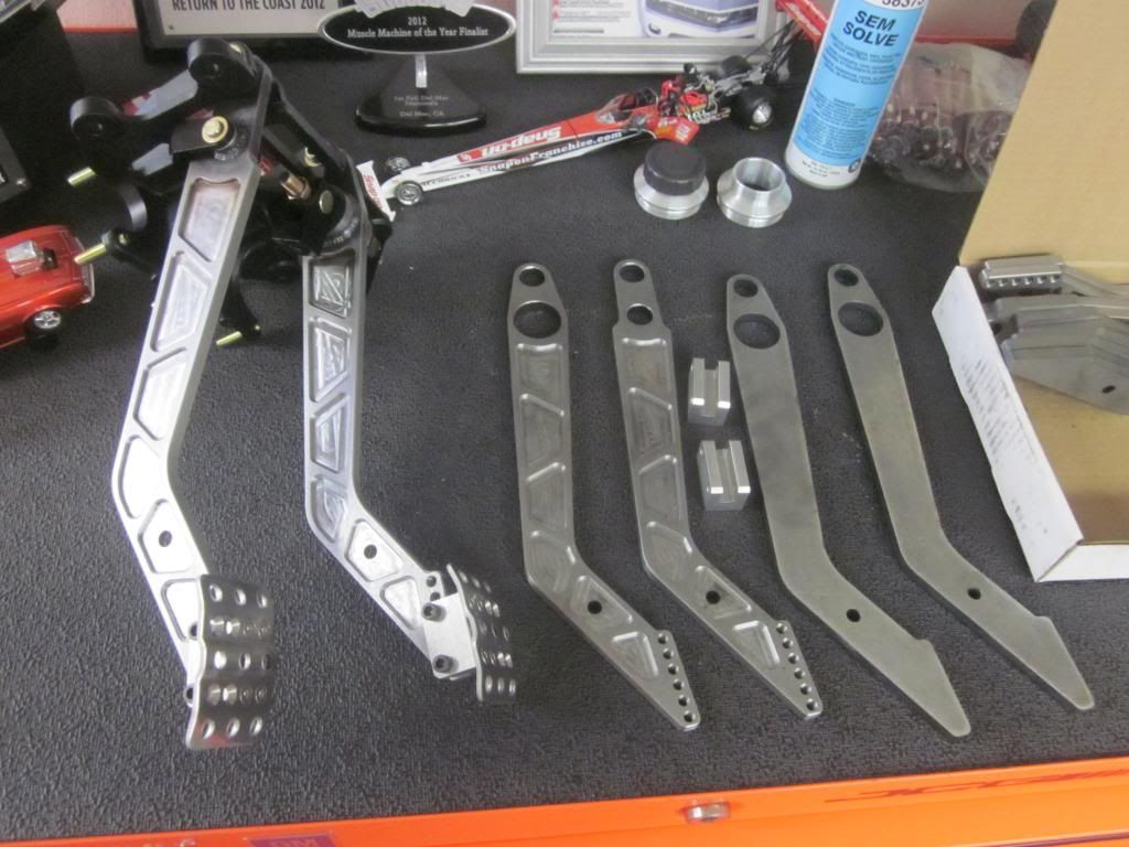

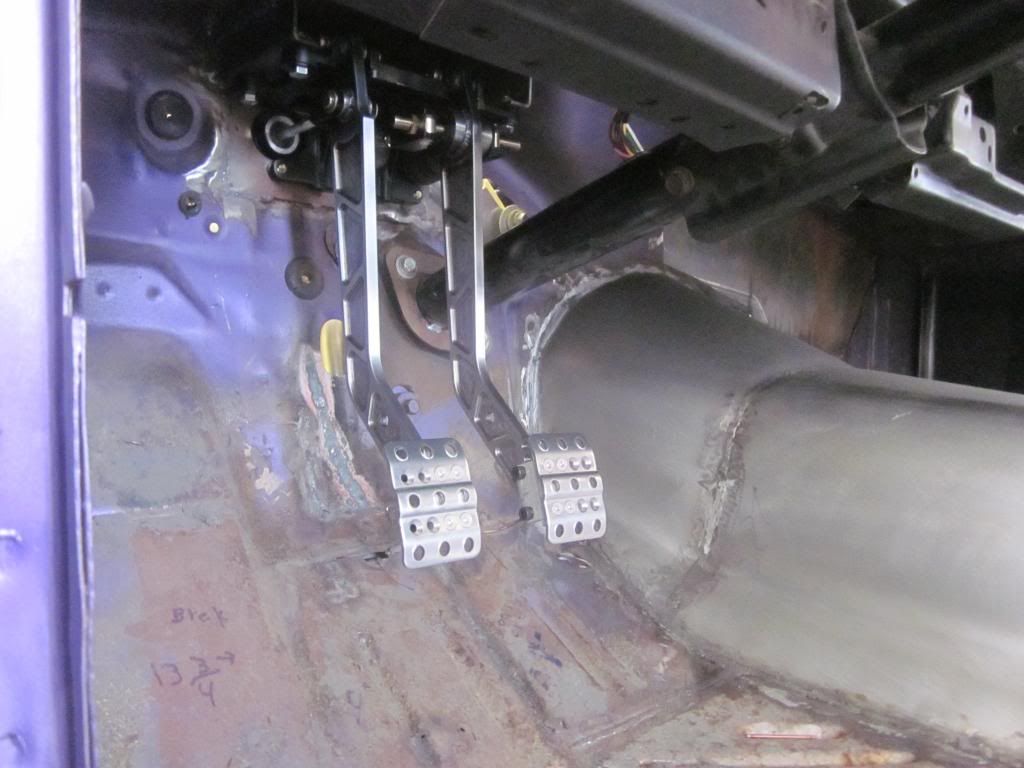

Just completed this project… been thinking about this for some time & finally got around to making a set.. pedals that are adjustable from side to side & little adjustment from up & down.. This will should help with heel & toe.. Plus I wanted to increase the pedal ratio.. the Wilwood’s have a 6.25 ratio & now we have increased it to 7.25 ratio.. this should give a bit more leverage.. We will need to play around with M/C bore size to find one that is not very firm but will give us a small amount of travel for modulation..

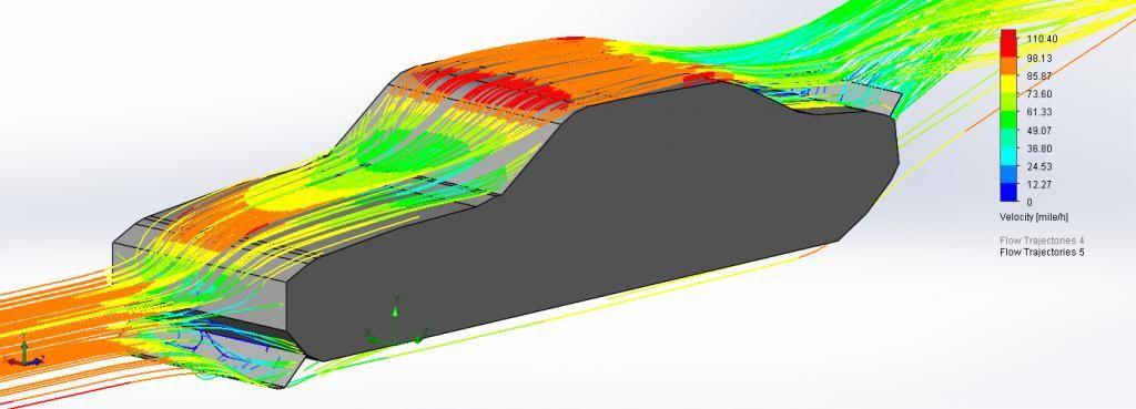

We've been experimenting with various aerodynamic improvements on the 70 Challenger. In order to aid our development, we've generated a rough model of the Challenger center profile to study the characteristics of airflow over the body. By creating a virtual wind tunnel with the aid of CFD simulation software, we can evaluate how changes in spoiler angle, height, and profile--for example--affect the overall lift and drag generated throughout the body. While this model only gives us a partial representation of the aerodynamic behavior of the car, it is a great starting point in evaluating how certain changes alter the pressure zones and air velocity over and under the vehicle. As we develop a more comprehensive model of the car, more and more aspects of the car's behavior at speed will be realized.

^ Did you write that Cris?

I just copied & pasted from some aerodynamics search I did on Google.
