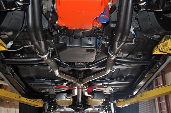

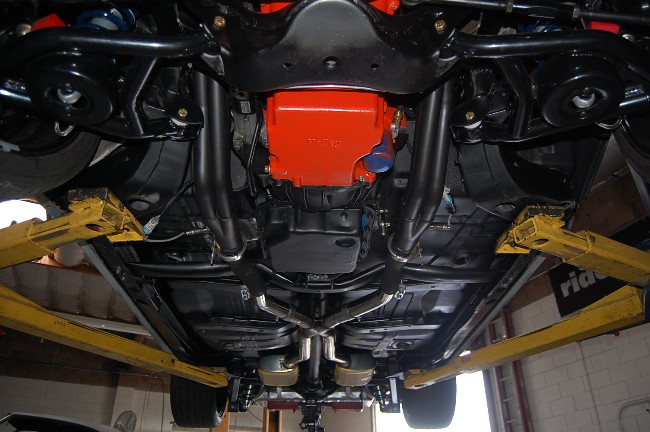

Now to start tuckin the exhaust.
We are using the stock crossmember but we pushed the engine back so now the long tubes are pretty close to it. We used a few sectioned bends to get around it.
The header extension section will be band clamped into a stainless x-pipe system by Magnaflow.
Once we adjust the forward pipes we can center the X pipe, the set the mufflers.

Looks great Vince!! 3 inch all the way back?

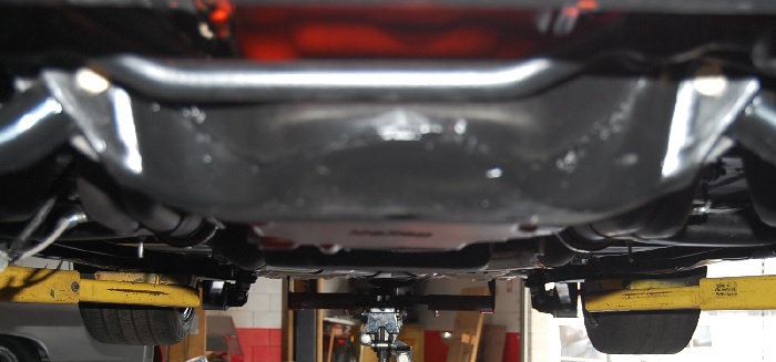

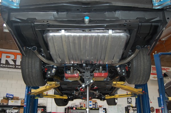

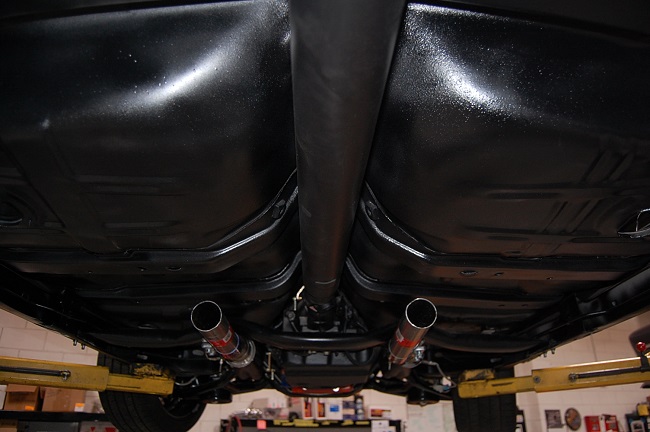

Not this time. We went with a 2 1/2" stainless kit from Magnaflow. Stock LS2 won't need much.
mufflers set and tail pipes being positioned.

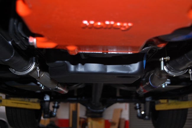

Vince, how do you like the Holley oil pan fit? and what seats are going in there?
Awesome job your doing.
thank you Wayne....The latest version fits much better. The front section is flat. The older version had a hump to it which made fitment height higher than need be.
plus it fits nice and tight.
They also lowerd the price on the new holley pan.
Seats are from an 2006 GTO!

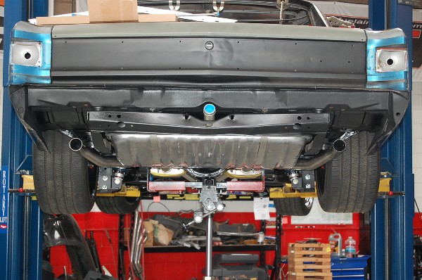

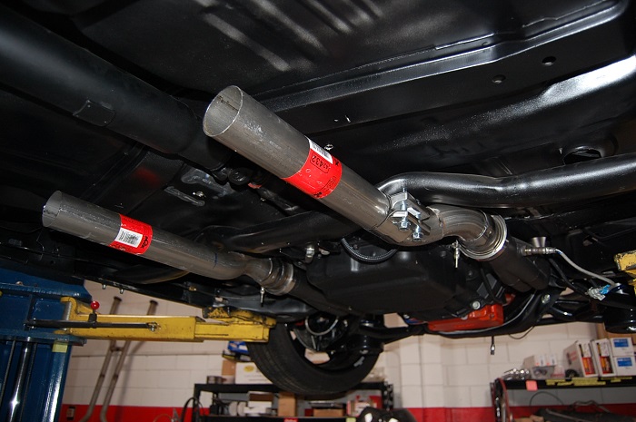

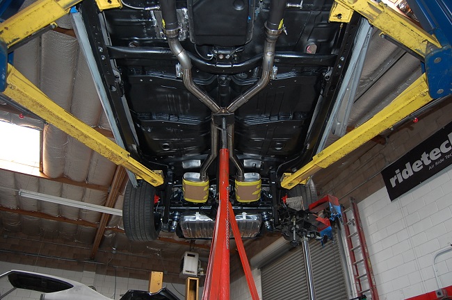

With the mounts modified to sit flat. Exhaust is done up to the forward tail pipes. We'll set the rear tail pipes as soon as its running and the bumpers on.
