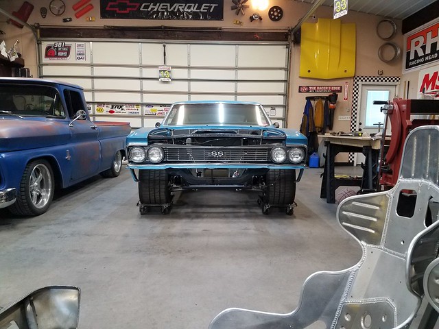

It looks like my last post was four weeks ago. Some things have happened since then.
The big mile stone is the body is back on the chassis to stay...
10134 by Yelcamino, on Flickr
10132 by Yelcamino, on Flickr
10133 by Yelcamino, on Flickr
10135 by Yelcamino, on Flickr
Those 315's look absolutely huge on there!
10137 by Yelcamino, on Flickr
And of course, I weighed it.
10136 by Yelcamino, on Flickr
So 2129 lbs includes the body, chassis, cage work, suspension, wheels & tires. Before I started the cage if you remember, it weighed 1875 lbs, which means all of the cage components only added 254 lbs. Another interesting thing, the chassis with suspension, wheels & tires, and cage weighed 1365 lbs. That means the body, which includes glass and all door components, but no hood, floor, front/rear fenderwells, or interior, added 764 lbs.
The only other thing I've done since the body went back on is to install the bumpers to help make sure everything is centered properly.
10138 by Yelcamino, on Flickr

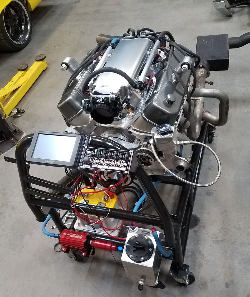

While trying to free up some room in the shop, I decided to make an engine test stand using some of the old roll bar I removed from the Chevelle and scrap tubing left over from the new cage. It's not pretty, I just slammed it together and the only money I spent on it ($20) was a set of casters from Harbor Freight. All the other stuff that's bolted to it, I either had sitting on a shelf, or I bought it to go in the Chevelle.
This also gave me an opportunity to see how much the all aluminum big block actually weighs!
Test stand - 98 lbs
Engine on stand (no intake or TB) - 614 lbs
Since I already weighed the bellhousing (30 lbs), clutch assembly 43 lbs), and test stand, I subtracted them from the 614, which put it at 443.
Then I weighed the Hogan intake and Holley throttle body (24 lbs) and now that gives me an engine weight of 467 lbs.
In the pic, the front accessories are in place and where during the weighing. The water pump & pulley (6 lbs), alternator, bracket, bolts, belt (12 lbs), PS pump, bracket, bolts, belt (5 lbs), and motor plates (4 lbs).
If my math is correct, just the engine from oil pan (includes 8 qts of oil) to intake, only weighs 440 lbs! I guess I don't need an LS to save weight!
10142 by Yelcamino, on Flickr
I haven't run it yet because I'm still getting all the little pieces like fittings, hoses, etc, in place. Once it's running, I'll post a vid.
Test stand - 98 lbs
I assume the headers were not included in the motor weight??? What block and bore. I have a Brodix with a 4.6 inch bore - the bigger the bore the lighter the block because the steel liners are thinner. Looks great!
Pappy
Correct, the headers in the picture are not included in the engine weight in my post. However, I did weigh these headers and the pair came in at 35 lbs.
The block is standard deck height, 4.5" bore, 4" stroke, 6.535" rods.
