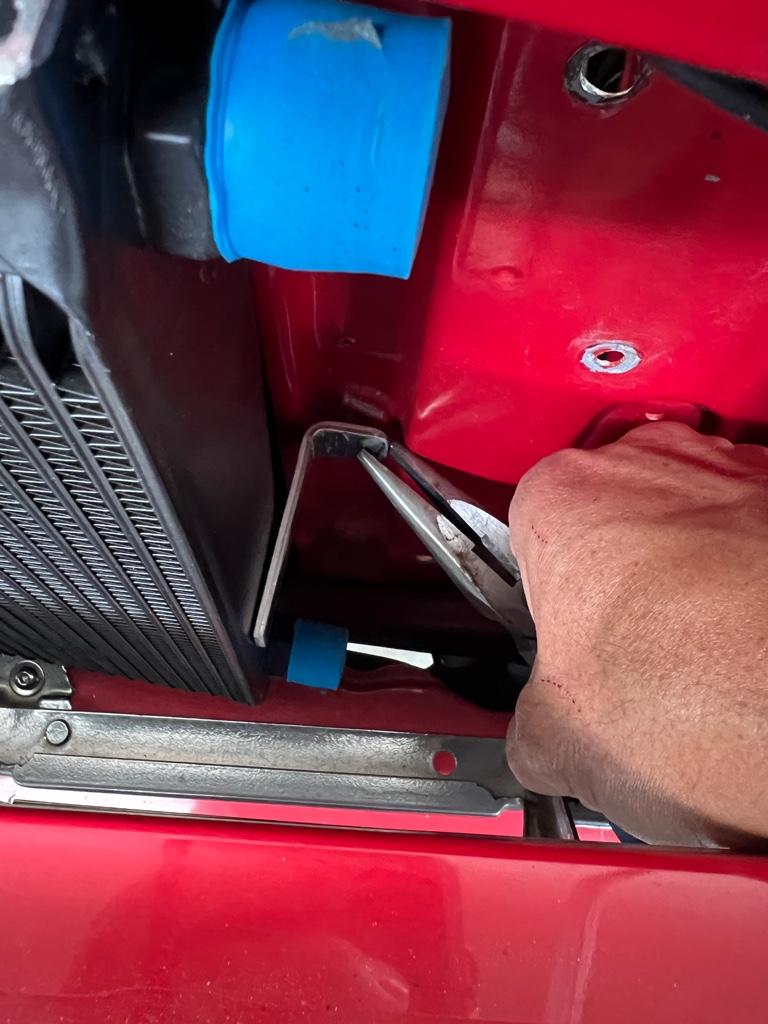

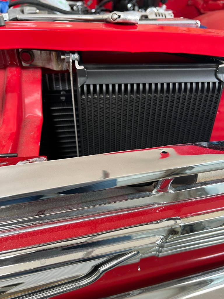

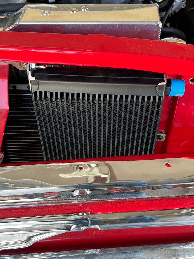

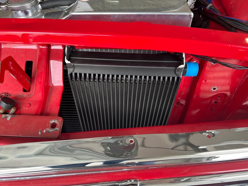

Been a while since my last post. Life has been happening along with progress. BISKWIK has been on the road and is a blast to drive! It still isn’t finished yet, but I don’t want to park it to work on it.
Anyhow, here are some pics of progress.
I installed a transmission cooler for the 4L60E. I had to find a place to mount it and then made some mounts and had them welded onto the cooler.
Of course, I had to modify the cooler to fit in the area in front of the core support.
-Matt-
