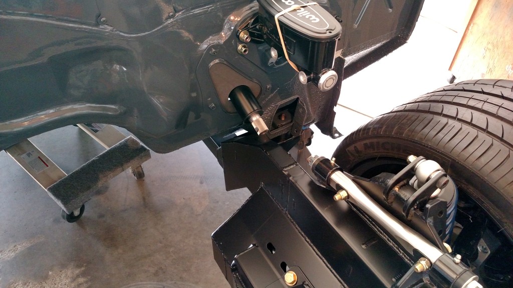

Thanks Scott, I want to see this under it's own power too Here's another one for you ...
Flash back Friday ... remembered when I pulled off the roof and found mouse houses in the front bow, man did that stink, yuck!
Shifted gears ... trying to get the steering column in and matched with the rack, not going so good. Seems the Retro-fit 67 Camaro Ididit column is TOO long, needs to be around 29" vs 31.5", and Ididit columns only come in 28" and 30". Messed with the position and came up with a good compromise ...
probably could use the 30" gonna have to check!!!
Bolted in the stock position shifted all the way back ... 4" into engine compartment!
Shifted back into cab about 2.70" ... mo better!

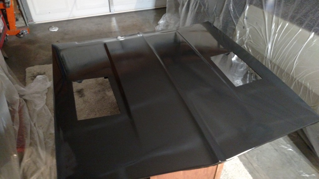

OCD kicked in , last coat of epoxy I promise ...

Well what do you do after the photo shoot? You move indoors and do something clean that doesn't attract dust into your newly painted radiator support!
Wish me luck ...
