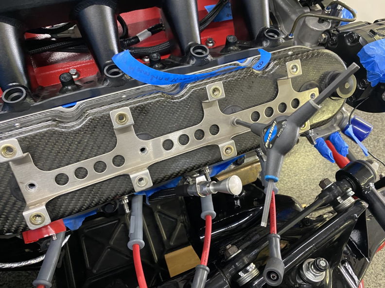

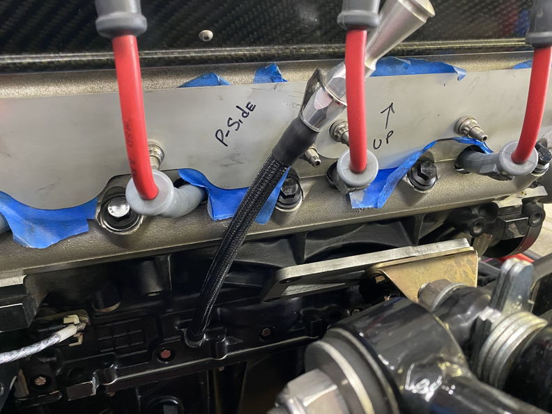

So at this point I am assuming at this point that my coil brackets are upside down so I am going to flip them to see if the coils come down just a little bit to take the tension off the plug wires. If not I am going to have to remake the wire as I don't like how tight they are.
and yes that is a mountain bike tool being used on my car. Which got me thinking....
At some point the Custom Works Carbon Valve covers we be heading over to Gonzo Details for paint correction and a paint sealer.
Flipped
Well that didn't work out so it looks like we will be making new wires.

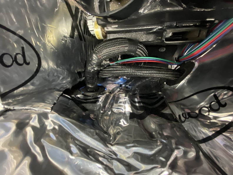

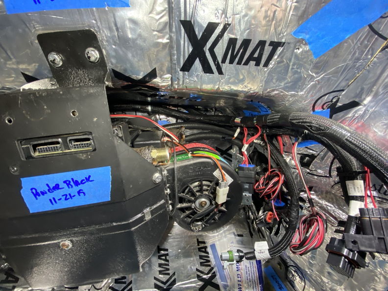

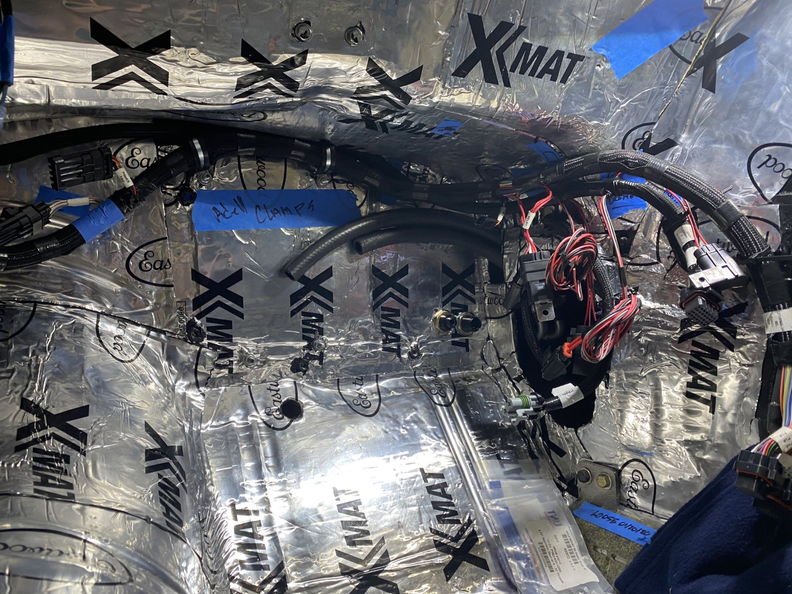

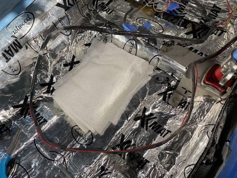

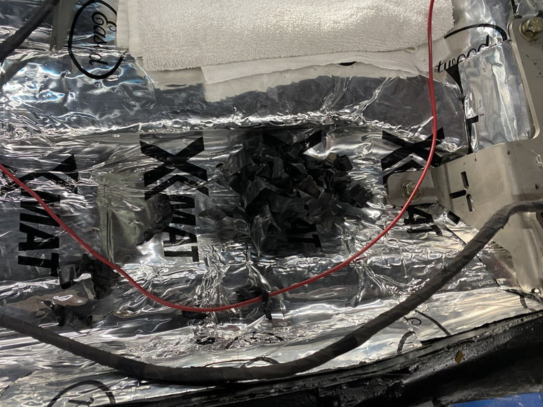

Next up is planning, neatly hiding and running wires so they will be easy to access if I need to service them.
making a new hole.
Grommet installed and I promise I will clean up the DEI Boom Matt to make it look nice.

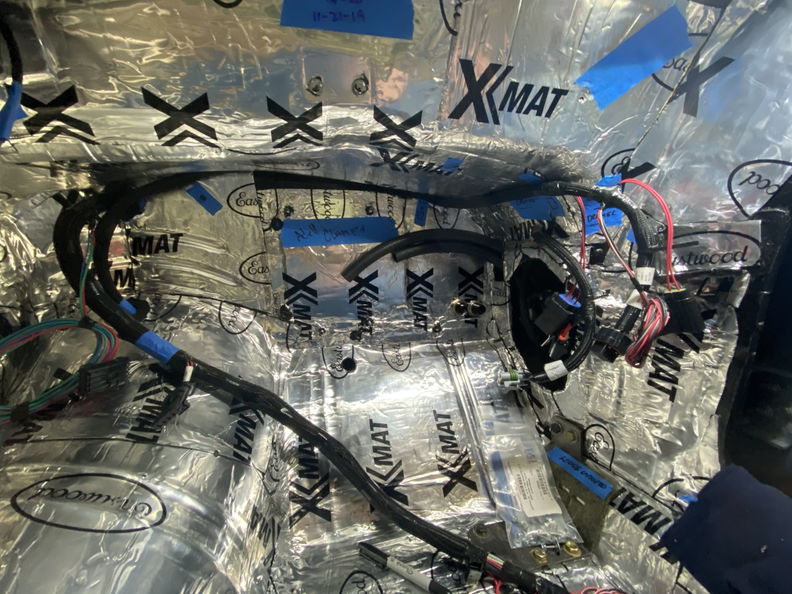

Back to the Holley Terminator wiring and I am hoping all of my planning pays off with all of the hose routing and
wiring. Confirming the location of where I want to mount the relays. Once I feel confident I will install the "Weld Mounts"
which are a stud that are glues in with panel bond.
These are going to be fun to put the washer, lock washer and nut on.
I think this is the final.
More notes on the blue tap.
marty-mj

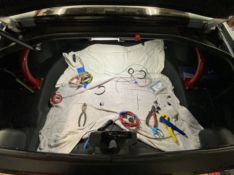

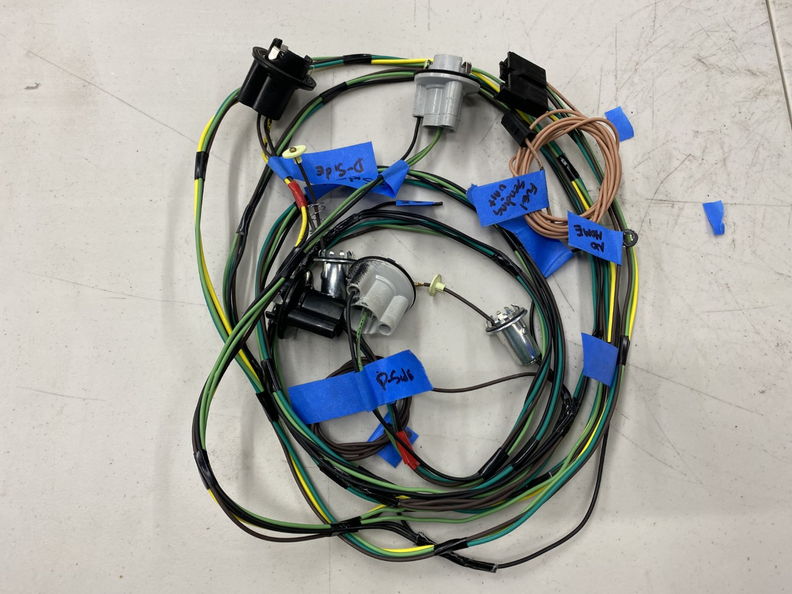

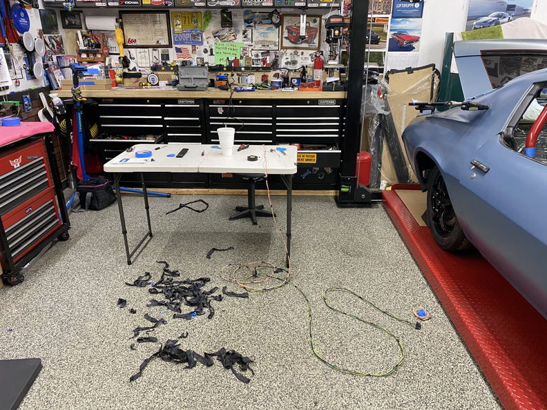

Back out in the Garage again (02-16-20)
I was hungry so I looked in my wife's car and found some snacks

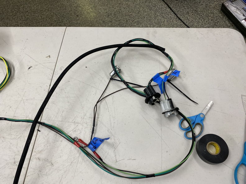

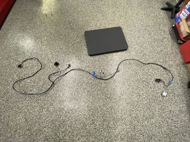

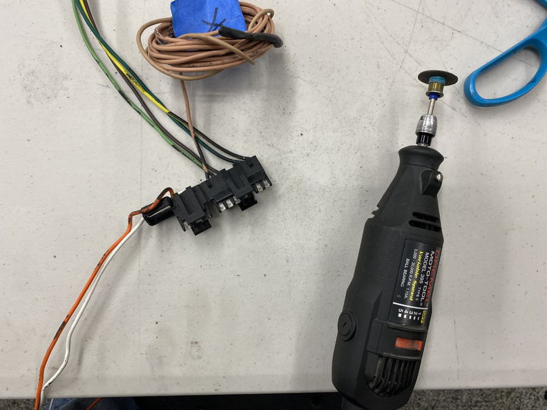

Another harness that I am going to redo...
This was the original fuel pump wire.
Time to remove and clean up the harness.

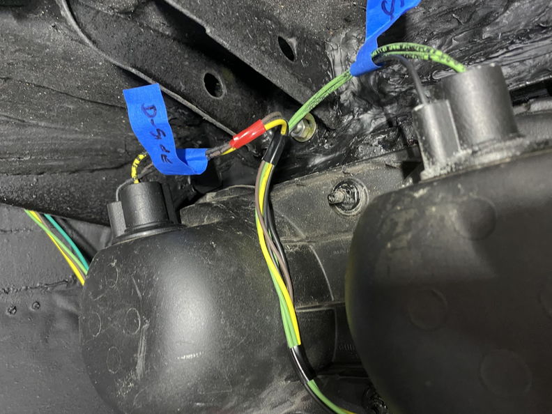

While I am here I might as well clean up the tail light harness.
Odd it doesn't look so bad on the ground...To late now
My desk for the next couple hours.
Looking better already.
marty-mj

Here we go.
Bye Bye
time to get rid of a few feet of wire.
shorter is better.
this is how much wire was removed. (02-17-20 )

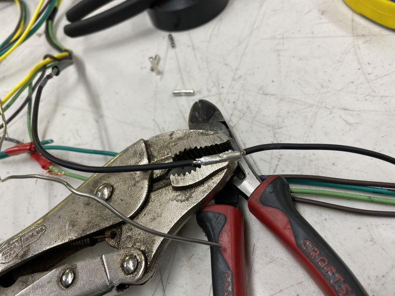

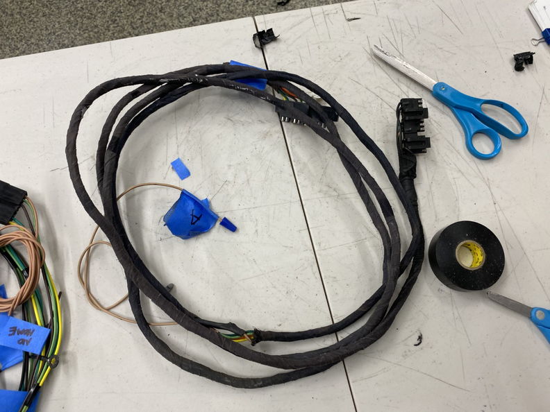

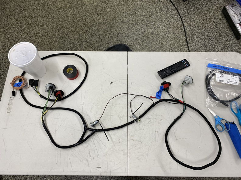

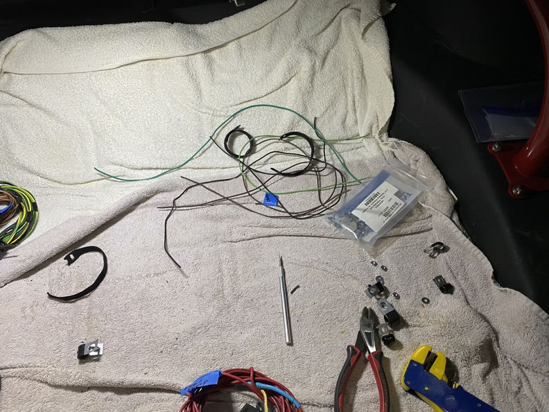

Looks like my desk is back.
time to splice and join.
and Thank you Foster Grant for making Multi-Focal cheaters as I needed them for this project.
Time to wrap with Tech Flex Wire Wrap
More notes
marty-mj

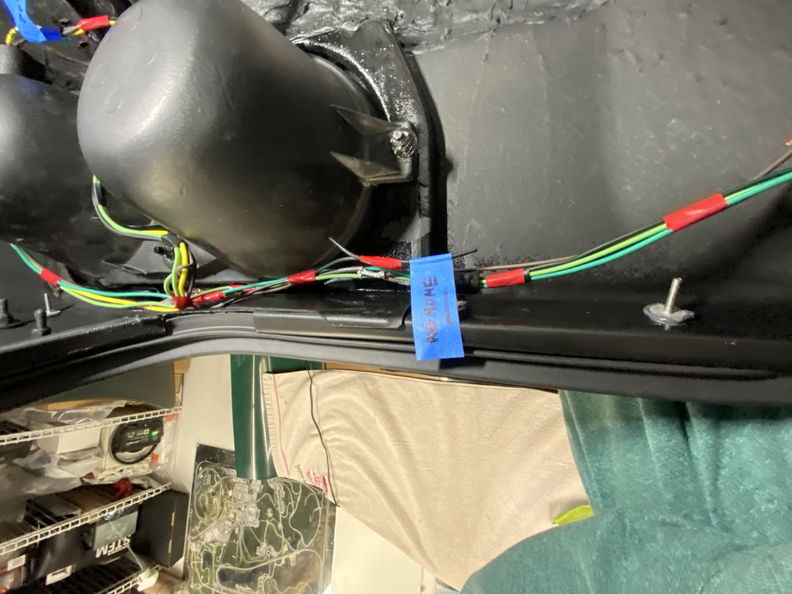

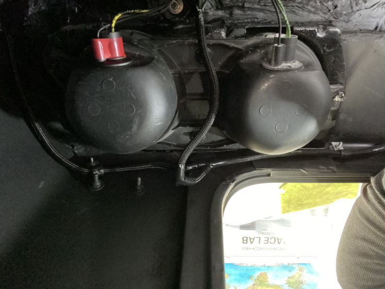

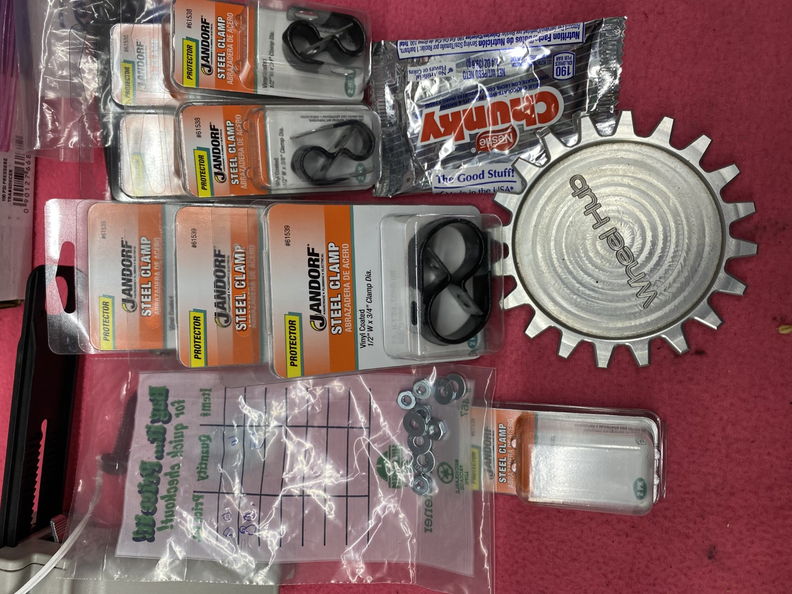

Moving back to the front of the car. (02-19-20)
The Dot's represent where I will bond in the "Weld Mounts"
Looks like there is plenty of clearance the bend doesn't look that bad
Vintage Air
Studs going in.
Off to Ace Hardware for more clamps and a Chunky Bar.
While the epoxy is drying I am going to jump back to the taillight harness.
and yes I put this Circle in for a reason.

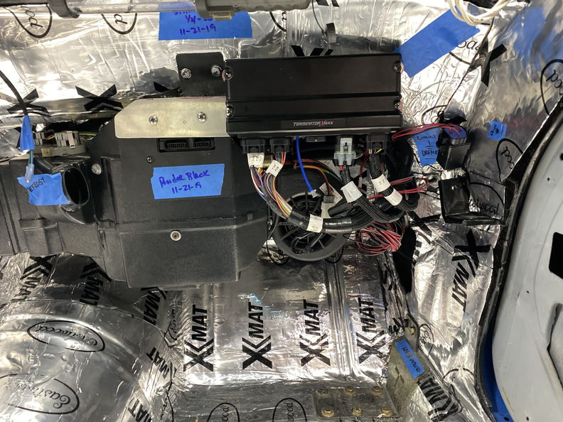

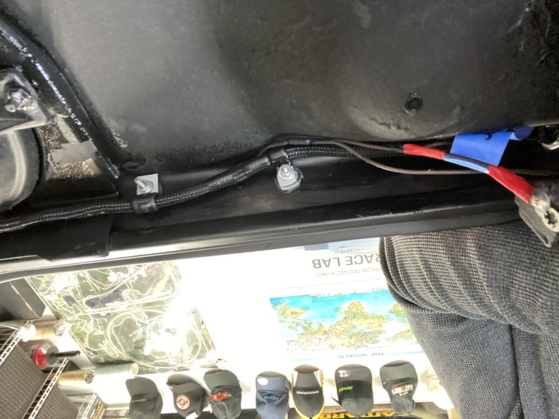

Back to the Holley EFI Harness (02-20-20)
Remember the blue notes.
Since this is a ground stud I removed all of the paint and I also removed the paint from the inside of the cowl.
Good News every stud was place in the correct location + or - milometers.
The view from the back seat
marty-mj
