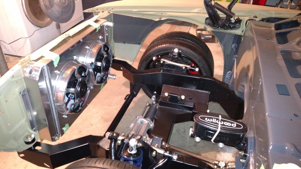

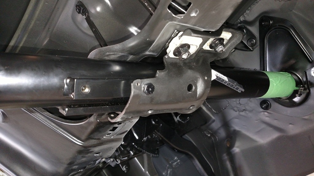

One step forward and two steps backward ... that's how this week has been going. First, the steering column was too long, then the radiator support bolts didn't fit the subframe, and then the gas tank strap rubber u-channel was too narrow.

Fearing the worst I installed the gas tank and radiator with no surprises.

Duh that won't work ... used a 5/16 bolt to attach for now! Frame is too wide!
Pulled the column into the cab the distance of the mounting pads, roughly 2 5/8", the bottom bolts are now top bolts!
That'll work just fine

Gas tank in ....
At least something went right!
Radiator installed w/o a hitch!
So I've been on the phone with Blake and he will pay for shortening the column from the Retro Fit 31.5" down to the 29" where she's at now, that's service, thanks, Blake! The car does steer now! The frame horns being too wide caught Blake off guard, never heard of that happening. Solution ... take some material off the inside slot to get the designed bolts to fit!

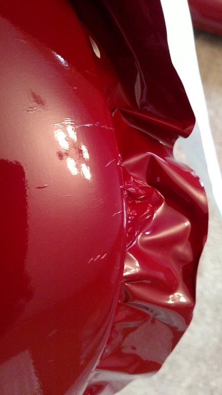

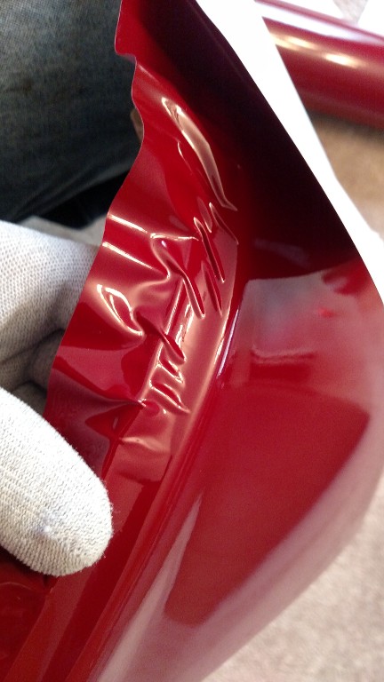

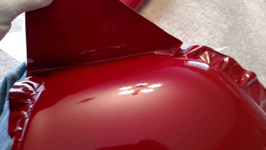

Persistance ... another word for not giving up! Or I could be a little stubborn ... had to try the wrap again with my new found knowledge, take a look ....
BIG tip ... don't take the wrap off the paper until you need it and NO HEAT until you are ready to set the adhesive!!!
Complex curves cause these wrinkles ... just have to work each one out one at a time!
Working with the lip and reading the wrinkles and applying pressure to relieve the tension ... fingers worked best!
Didn't get them all out but still learning ...
I have to keep on keeping on and get the other side done ...

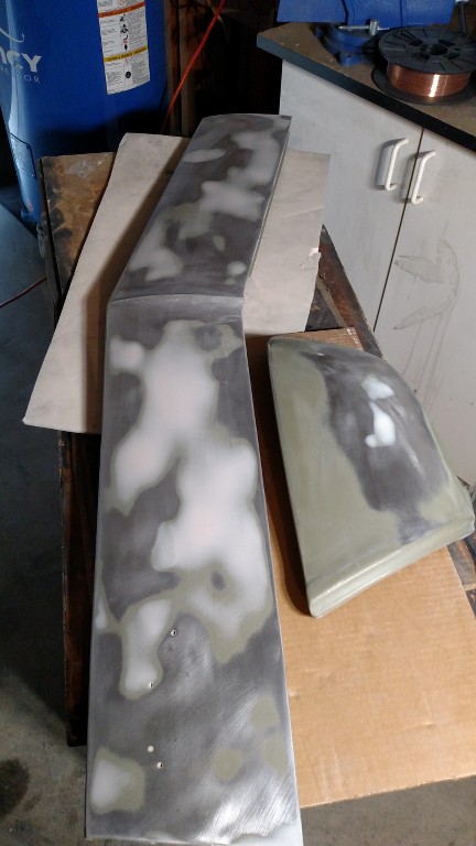

Good garage day ... did some body work on the extension and the header, I'll put some epoxy on these tomorrow, the wrap definitely shows the imperfections just as paint does ...
More experience w the vinyl on the wiper valance, this one was tough, had one Mulligan but overall came out great, take a look ...
Still have to cut the slots out ... this is one tough part to wrap cuz of the vents mainly.
Coat of epoxy and wrap them just like Christmas!
