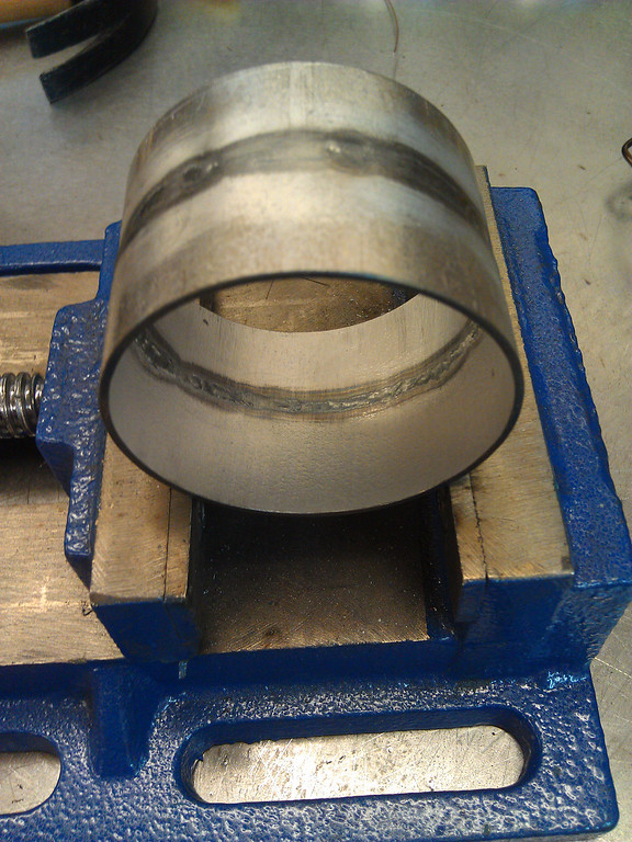

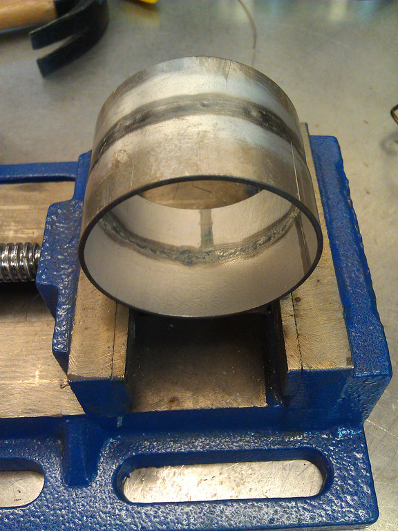

Test welds for the exhaust. Fuse welded 16 ga. at 45 amps. They look decent to me, critique please.
FWIW - The aluminized finish didn't pose any contamination issues like I thought it would.
I'll be running a fan while welding the sections to clear fumes away from my helmet.

Posts: 4,257
Like i said, you have talent
