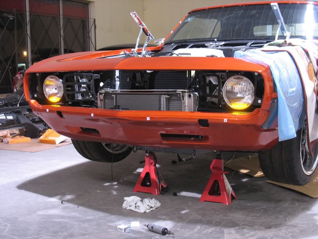

Sorry guys we have been soooooo busy getting this thing ready for sema.... talk about a crunch. First time I have felt this kind of pressure. Couple more pics , it really isn't as far off as it looks in the pictures. We aren't doing to bad, and should be pretty complete for SEMA. I have to get ready to make the drive too....... its going to be a lonely one thats for sure. All of my staff and my wife and son have to stay home and run the show, its just me and my machinist, and he is flying. On that note if anyone is going to be hangin around vegas we could use some friends!!

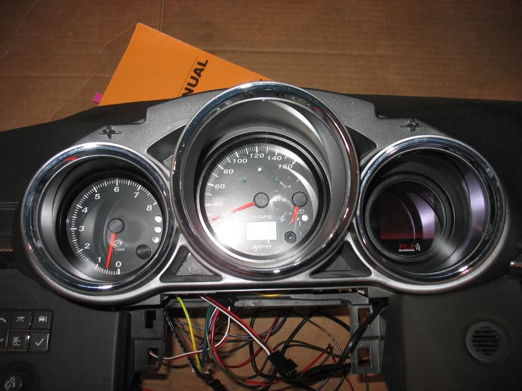

Got the gauge cluster together.....we had to axe the caddy stuff in it, no way to make it work. But all in all, its tough to tell the difference!

The car is looking great, I love the gauges.

Thanks. They are speedhut gauges and plx devices.... we have been using speedhut for a couple projects....nice product

Where you not able to get the V gauges working because of time?
Theres been a few swaps that have gotten the 04-06 GTO cluster to work by using the BCM as well in the swap.

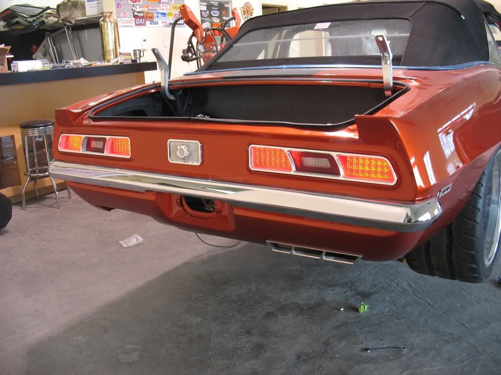

Who's digital tail lights did you use?

The tail lights are marquez with spahgetti engineering led cards.
Ok the new 09/10 gauges are 100% Can-bus communication with the factory bcm and ecm in the caddy. Since we are using a MAST ecu and TCI TCU the caddy bcm is only doing the stereo switching etc. There was NO way to get the right signal to the BCM to then send it to the gauge cluster. Not any way I could figure anyways. I think our gauge cluster is actually going to be cooler than the caddy's anyway, and most people don't even realize the new gauges?

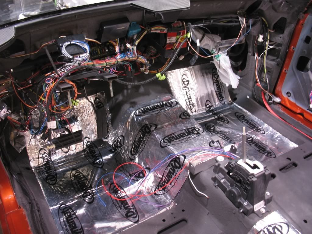

Some updates from the weekend work.
Exhaust is done. everything under the car is done. Lizard skin and Dynamat done. Carpet trimmed now. Interior wiring 95% done. Interior going in as soon as I get the door panels back from the "slow-polsterer".
